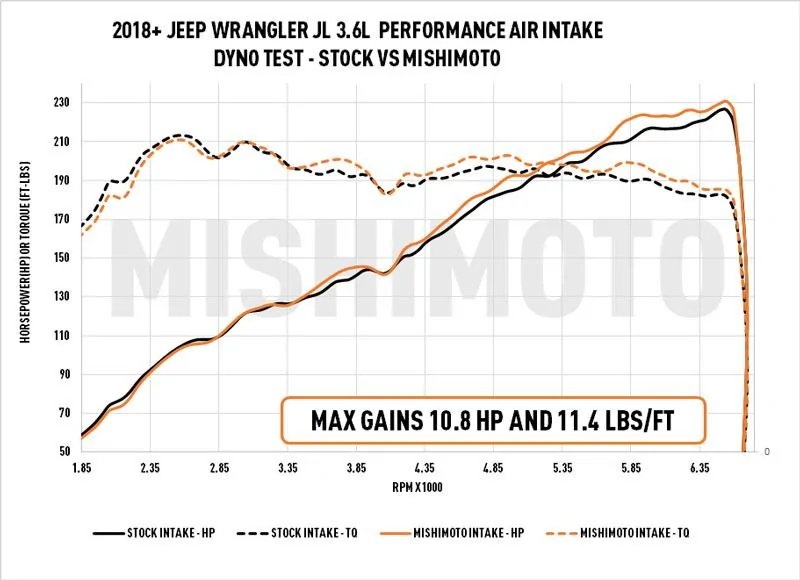

Hey everybody!
We're excited to be on the forums and announce the pre-sale of our 2020+ Gladiator & 2018+ Jeep Wrangler JL 3.6L performance air intake!
Jeep Gladiator Mishimoto 3.6L Gladiator Performance Air Intake R&D - More Power! 400-MMAI-JLP-18S_1
As always, we're happy to share our R&D process with you all. This intake shares a lot of the development process with our 2.0T intake, so if you haven't checked that out, take a look: Mishimoto Jeep Wrangler JL 2.0T Performance Air Intake
Our R&D post is below and you can find more details on the pre-sale on our website: Mishimoto 2020+ Jeep Gladiator 3.6L Performance Intake Pre-Sale
Thanks!
-Steve
As automotive technology advances and manufacturers try to squeeze more power out of every drop of fuel, forced induction (specifically turbocharging) is becoming increasingly prevalent. But, while forced induction can make a 4-cylinder as powerful as an engine twice its size, nothing compares to a naturally-aspirated engine’s linear powerband. Natural aspiration is power in its purest form – a one-to-one connection of right foot and forward motion.
For many Jeep enthusiasts, the simplicity of natural aspiration has kept them loyal to the 3.6L Pentastar V6 in their 2018+ Wrangler JL or 2020+ Gladiator. That simplicity also makes modifying an N/A engine straightforward. Unlike modern turbocharged systems that usually require a tune to gain power from bolt-on modifications, N/A powerplants benefit tremendously from anything that improves airflow to or from the engine. One of those simple modifications that many enthusiasts install is an intake. While intakes on turbocharged engines usually just increase turbo sounds, a well-tuned intake on a naturally-aspirated engine can make significant power.
...Continue Reading>>>
