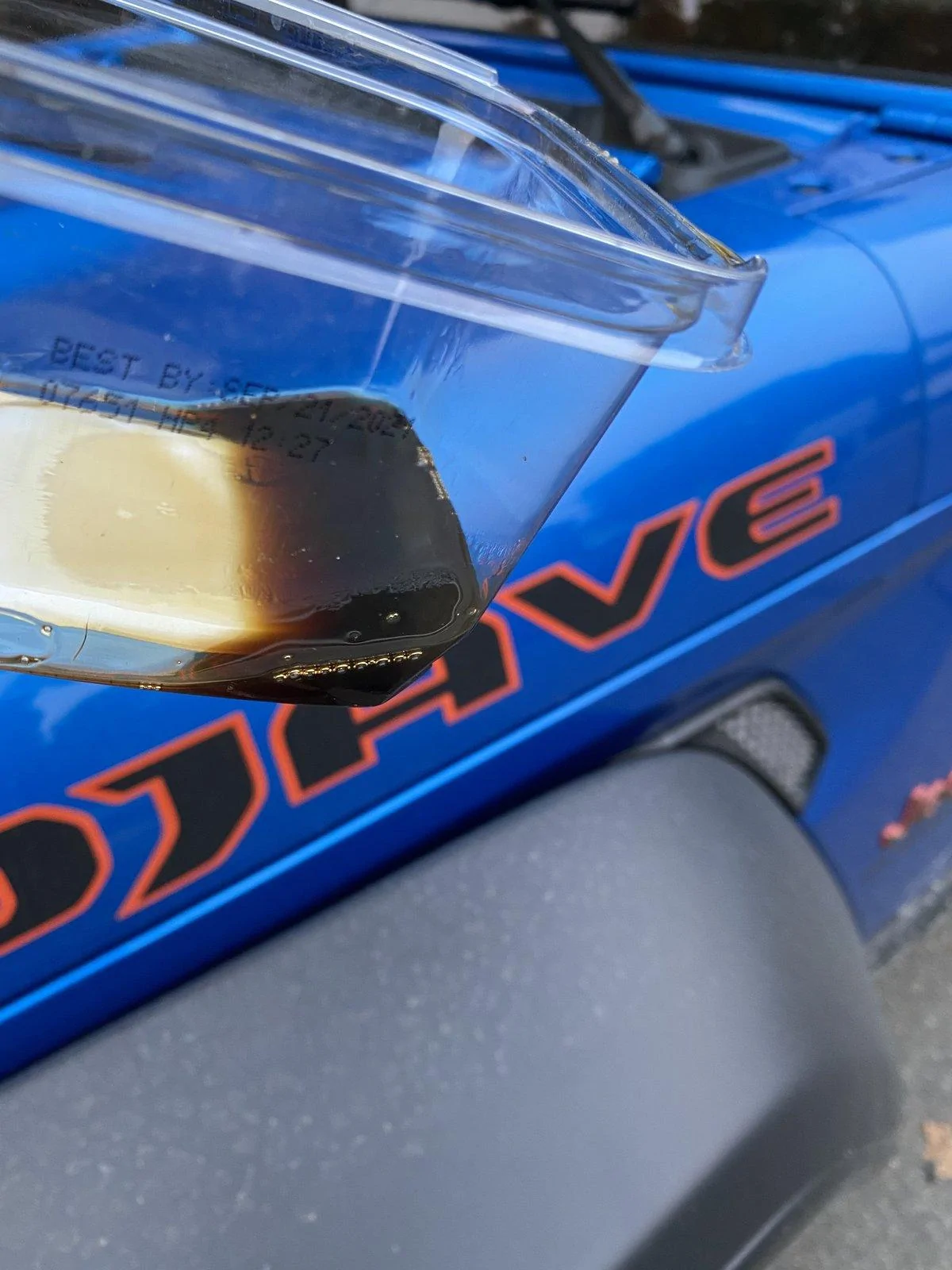

This is from 300mi to 1300mi

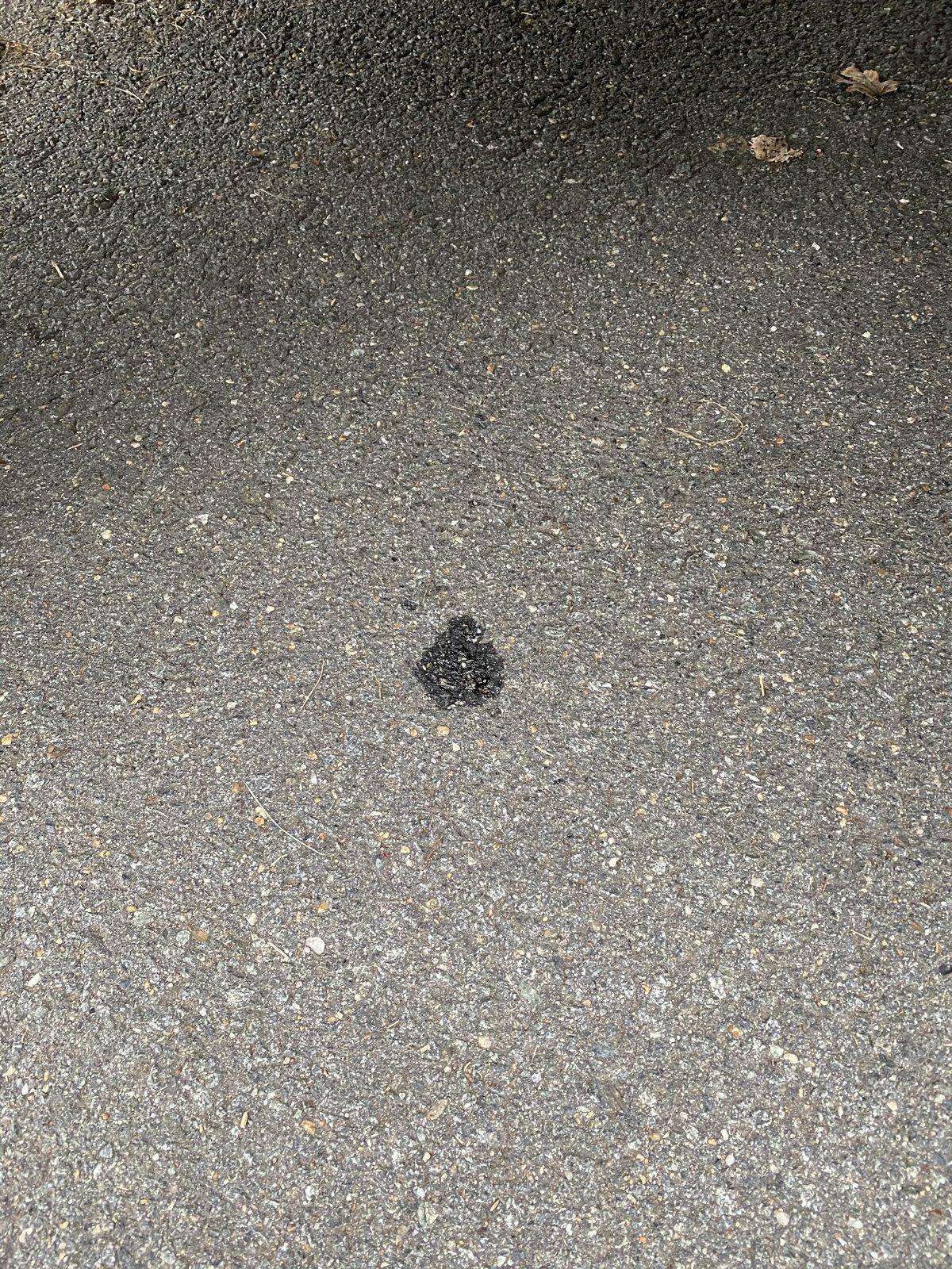

And of course, theres this bullshit.

Theres a lot of blow by on these motors, and i expect a bit more right now as its brand new. Id guess that was about an oz.
i probably wont even start measuring it until i have 5-8k on it to see if there is actually a problem. I just dont want it in the intake.

Also, turns out the leak wasnt from the valve. It was from the drain port on the bottom of the can, leaking through the threads. I got some petroleum specific PTFE tape for the threads and put a single wrap over them before re-threading. So far that seems to have stopped it and ill check again after a couple days. @Mishimoto might want to consider adding a small strip of it to the otherwise excellently made kit.
Do you have the link for that tape or what color it is? Want to make sure I get the right one because mine is leaking like crazy too.

Check out the Rulline Universal 350ml on Amazon, made from solid aluminum, I have had one for around 2 years with no issues or leaks.
