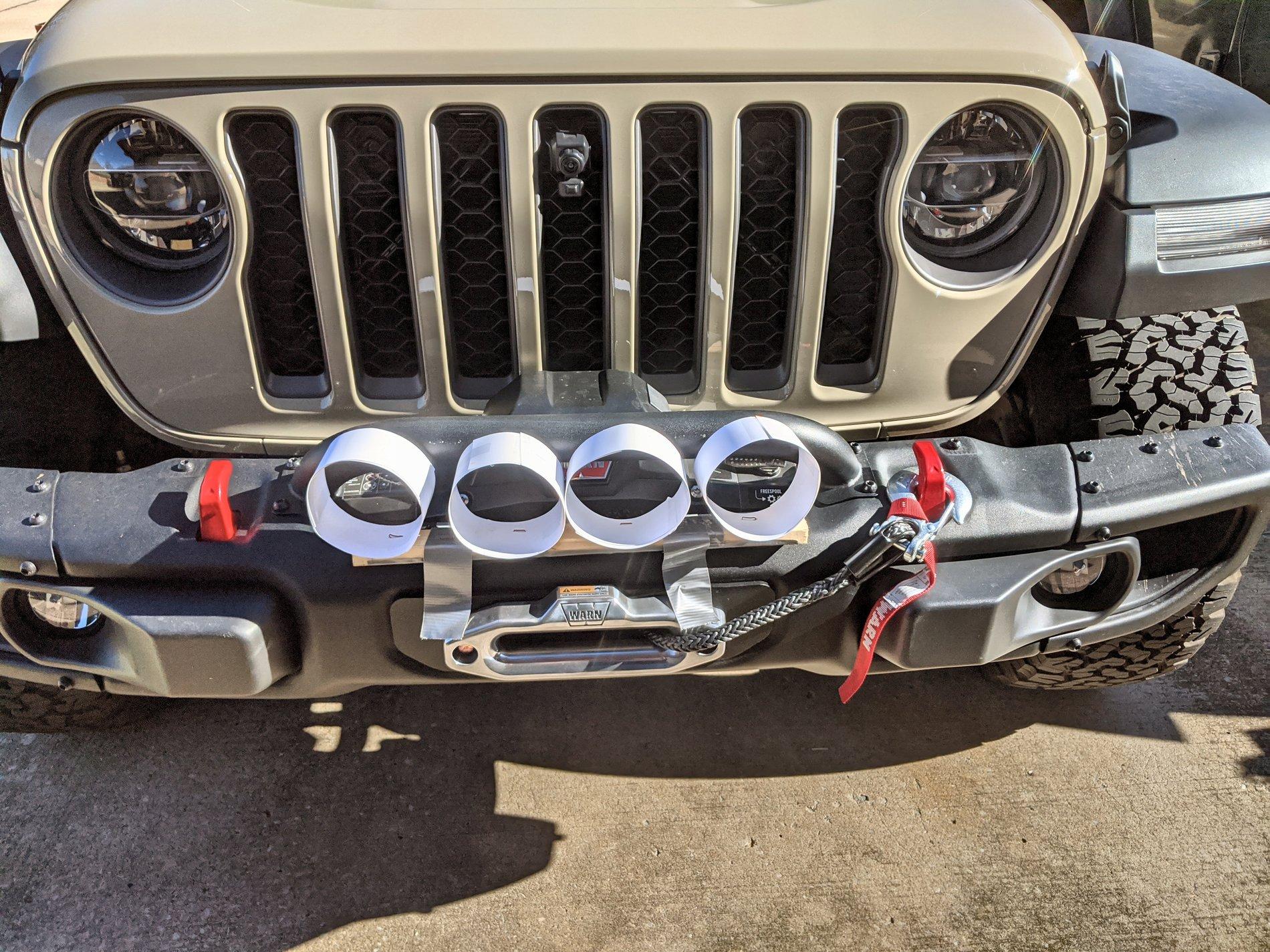

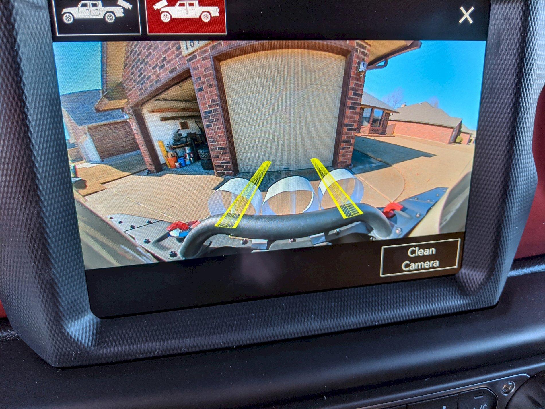

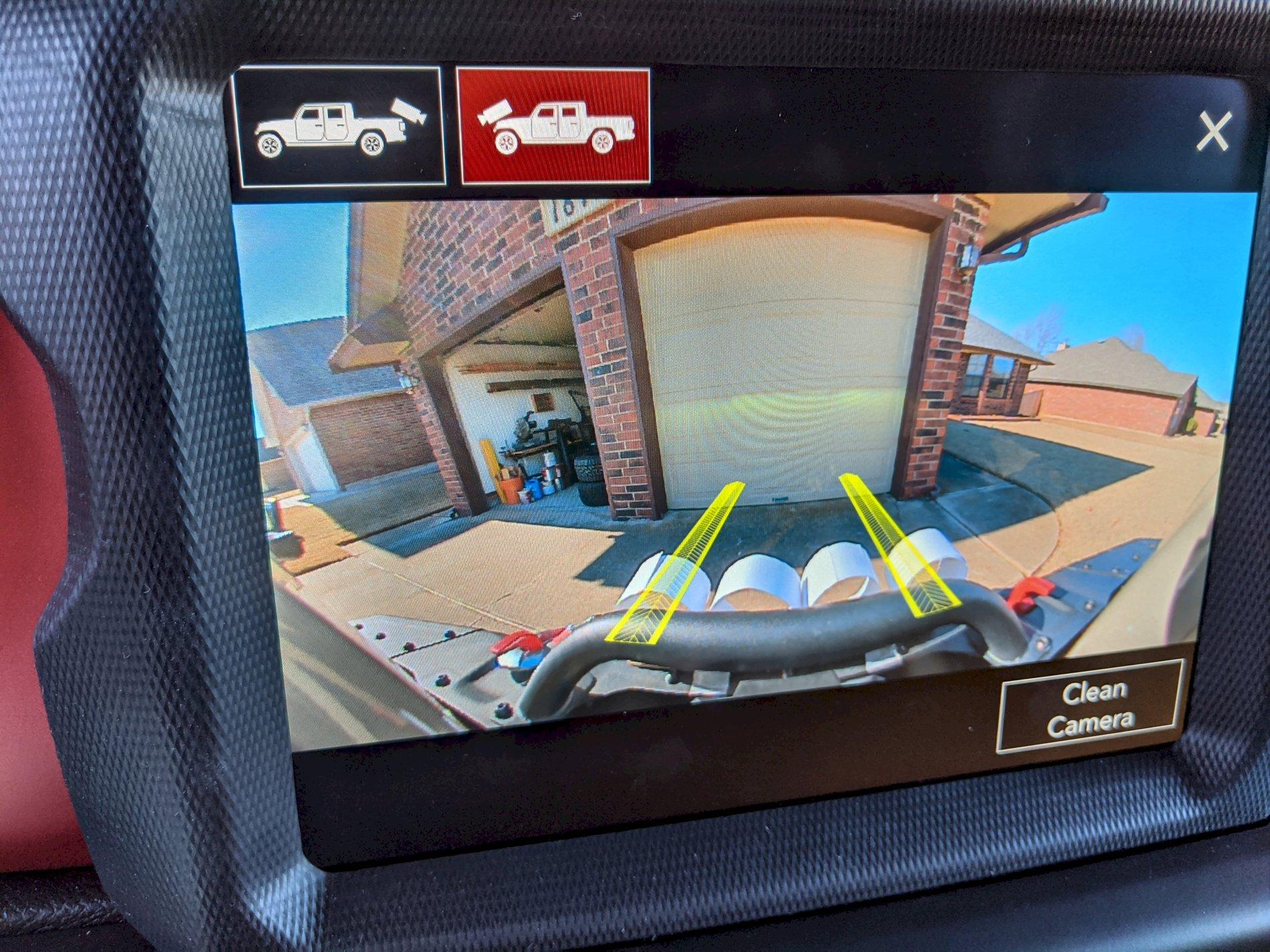

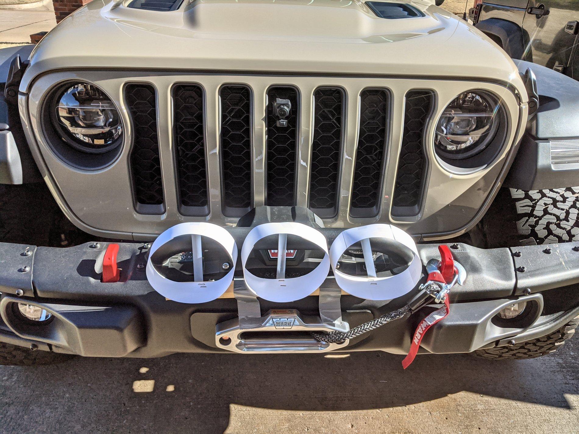

I've been mulling over installing KC LED lights on my front bumper. Made up some heavy stock paper shapes to simulate the lights, then took a shot of the front and the trail cam view. First off: You could fit three of the smaller LZR lights (4") on the bumper at the existing three empty holes. Not sure they'd fit with the small winch hoop I have, but that's removable. As for the large SlimLites (6"): Even three won't fit. You can do two. Or three on a fabricated bracket attached at those existing holes. And once you fab up a bracket, you can fit four LZR lights, if you prefer. Here are a few pics ...
Simulated SlimLites ...
TrailCam view with SlimLites ...
LZR lights ...
TrailCam view ...

are you drilling the holes by yourself? or how you would attach each bracket ?
nice test btw
