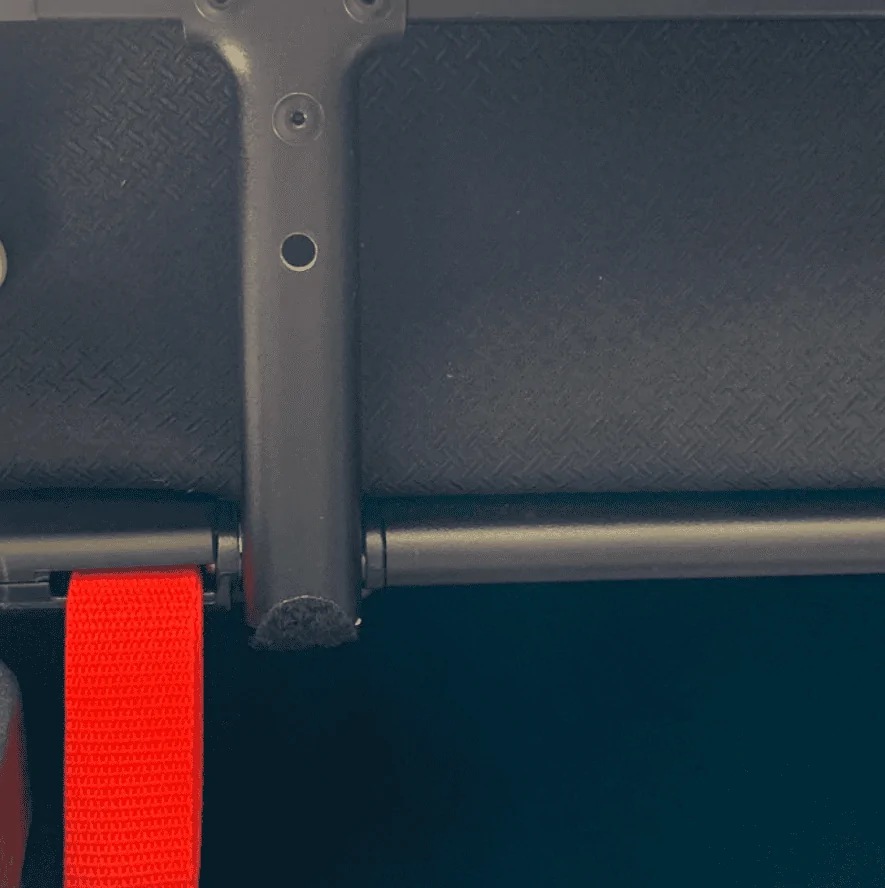

I drilled a 1/4" hole in the rear-most, driver side, bracket of the roll up cover. I put a small piece of wood on the other side of that bracket so that I would not drill through the fabric by mistake.
That allowed me to set in a 1/4" eyebolt with two nuts, one under and one over. I did let the eyebolt come out a bit more on the bottom so that the bolt itself does not puncture the soft top.
I think this is the foundation for any fix. So even though the rest didn't quite work, I think this will make whatever else we come up with work...

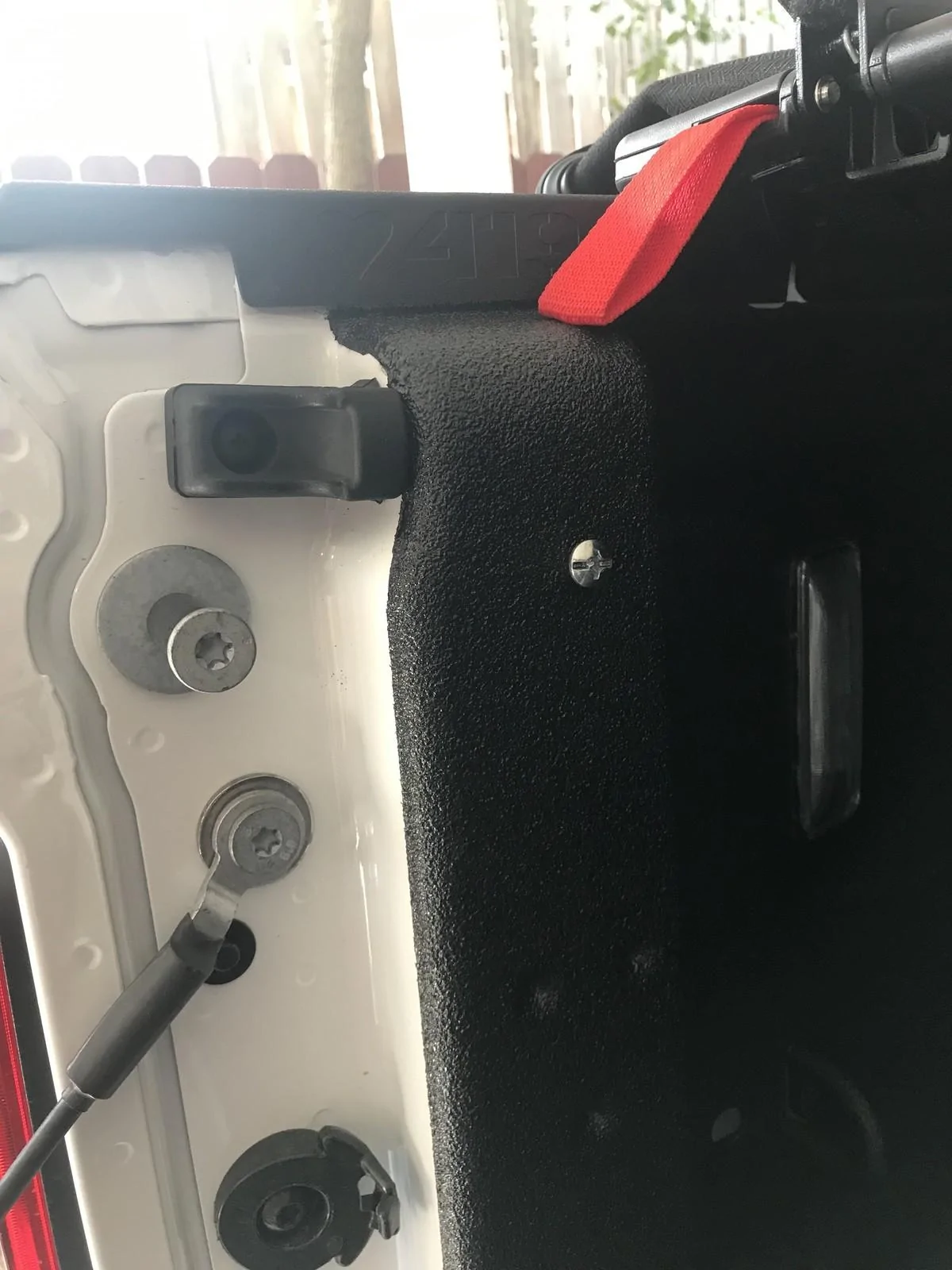

This works as is, or you could use it as a starting point to over-engineer it, like I will. The point is, you can thread an M6 bolt/screw/eyelet, whatever, into that existing hole.

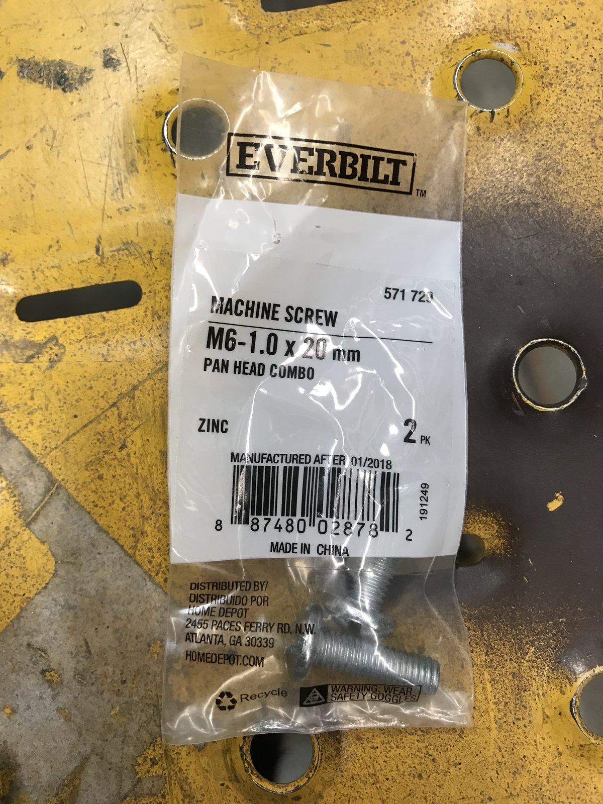

2x M6 - 1.0 x 20mm Pan Head Machine Screws - $1.17 at Home Depot

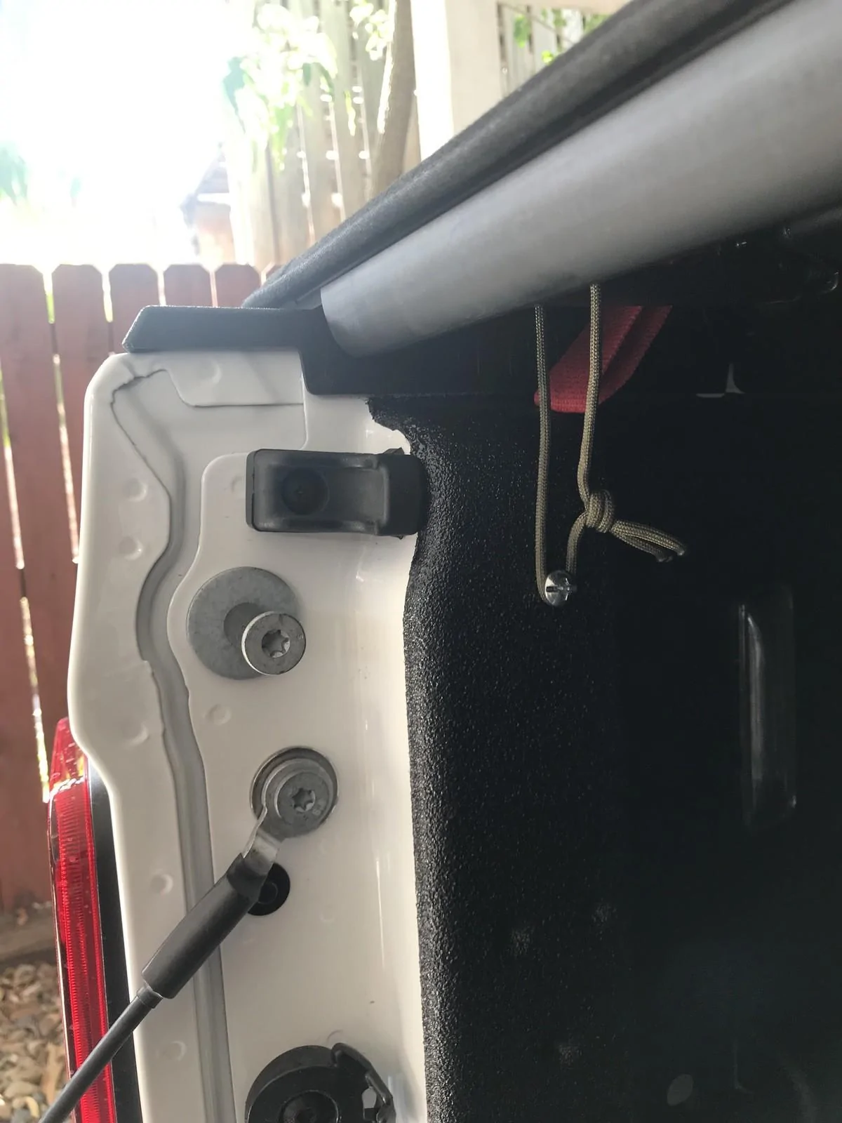

Insert the M6 machine screws into the existing holes in the side of the bed. Leave enough sticking out so the paracord can loop over the bolt head.

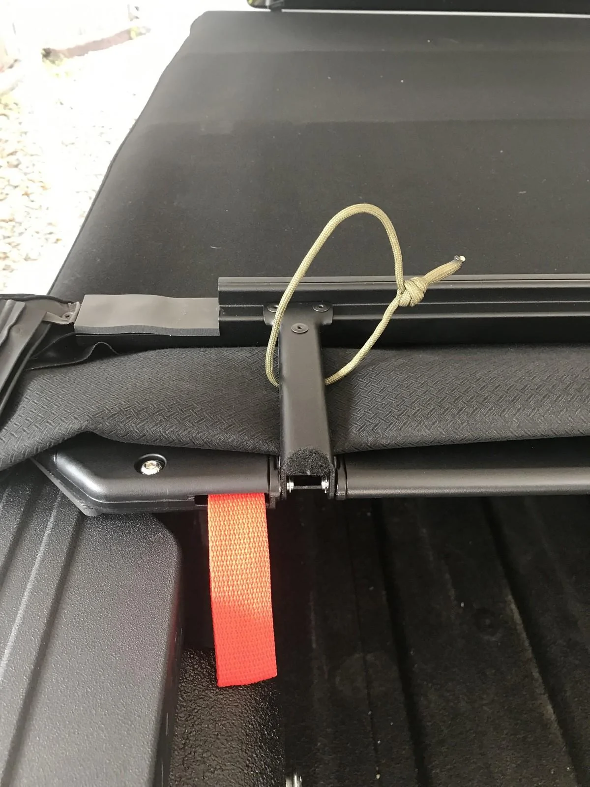

Loop the paracord around the metal braces that are part of the soft tonneau cover, and tie a knot to secure. Adjust knot length to preference.
Loop paracord over the exposed bolt head, and your all set!
And your done!

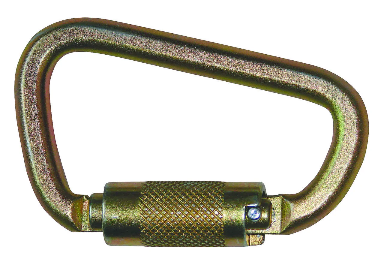

i would just use 2 springclips with some chain with small links so you can just barely clip it. This would only give would be thieves about half an inch of room. With that little bit, there would barely be any gap between the tailgate and the weatherstrip. Again if somebody goes to this trouble, they would just slash your topper.
One like this would give you a smaller amount of excess
than this one
Jeep Gladiator Modification to Allow the Soft Roll–Up Tonneau Cover to Actually Lock {filename}
than this one
maybe not by much, i dunno.
yea, I will try that too... In my head the clip should have given me a bit of play, enough to get it off, but not enough to still allow the cover to be pried open... but yea, it was either too much, or not enough.

oh crap. Why don't you just drill a big enough hole in this
for the spring-clip to clip right into it? Then no eyelet. Also with the right springclip, it won't clip all the way through, but just have the nub stick through the top of the tube. if this happens it won't drop as much, allowing for an even snugger fit.
its not like that little bar you drilled carrys much weight from above it, and since the clips will be loose, won't have much weight or tension below it.
