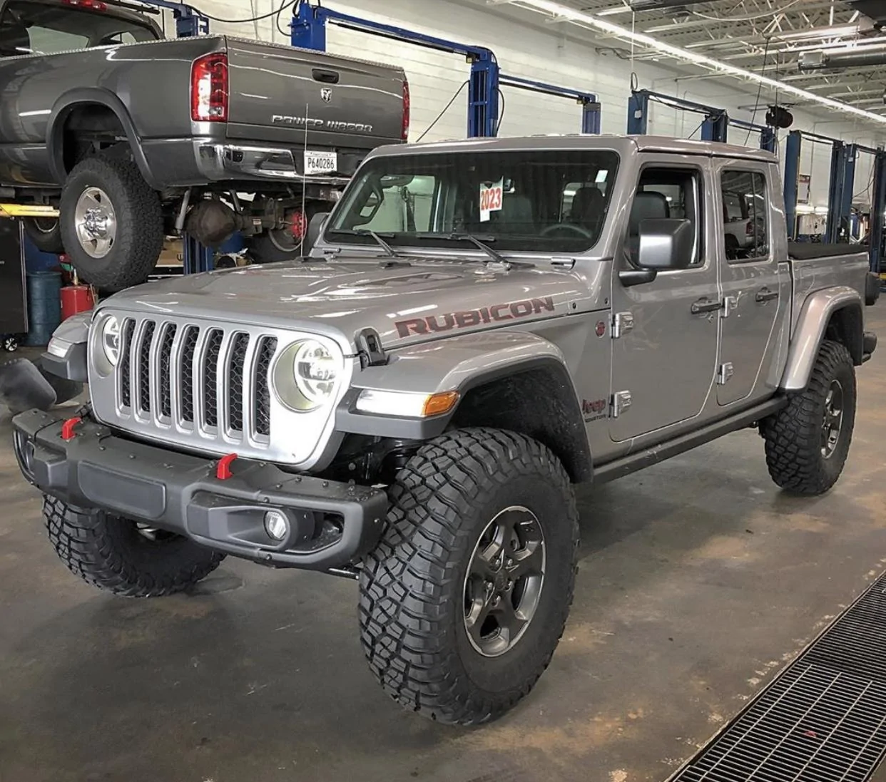

even in the pictures I posted above the rocks are going to beat the crap out of the rear fenders on that truck. I have a set of the heavy duty rock sliders that also act as a cab step to keep the rocks below the painted surfaces that are due to arrive on Monday so I will pick them up with my Gladiator. The rear door hinges on my JK looked like crap after about a month of driving without the cab steps I installed on it. I had to install them after we took it to church once and my wife had to hike her skirt up so high in the parking lot just to hop in the Jeep, but the secondary benefit was the rocks no longer got flung at the side of the Jeep.

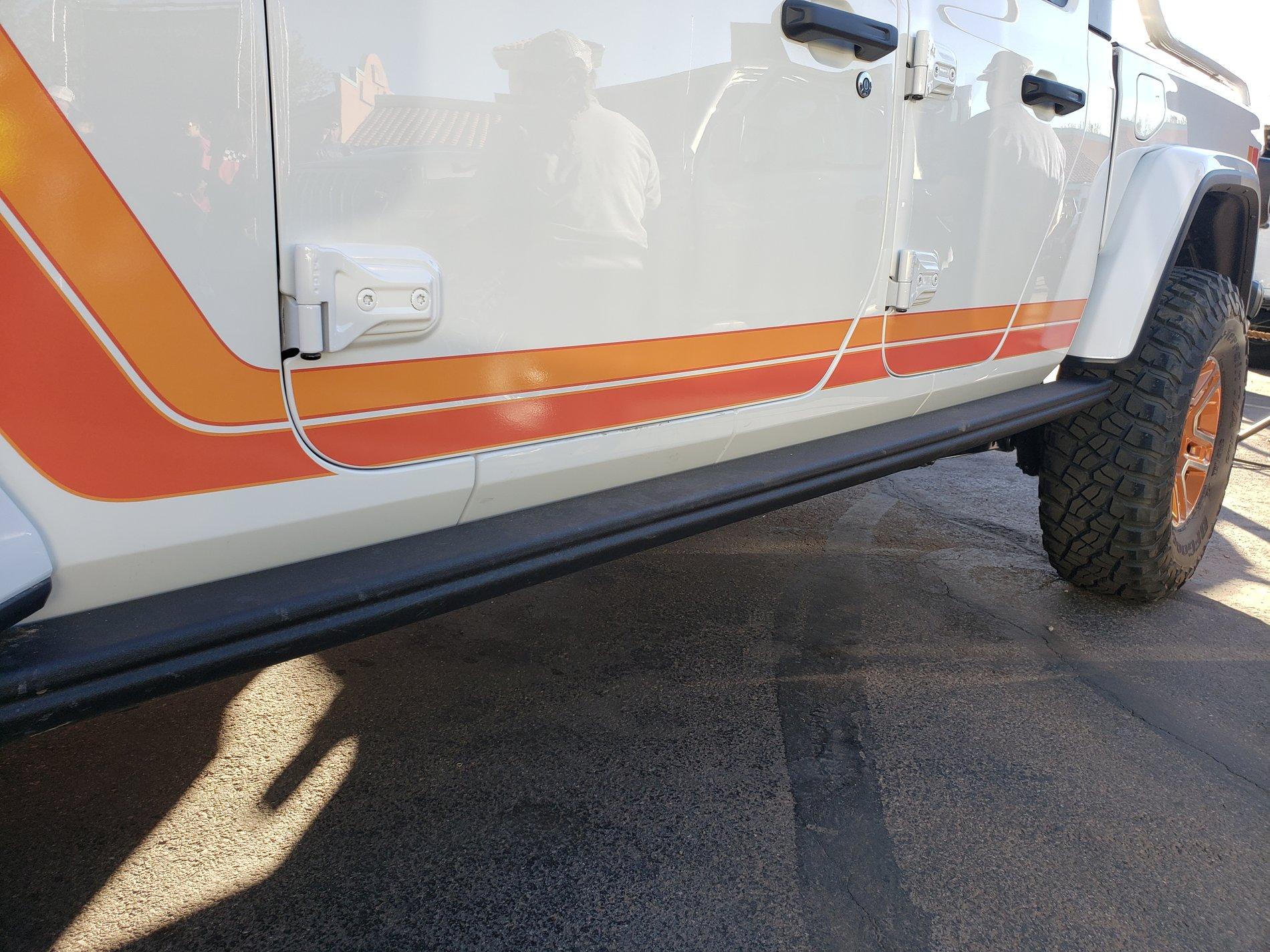

I was eyeing those but couldn't find info on how wide the quasi-step would be. Have you found anything? I run the RSE rails on my JK that also function as a step and I really like them.
I have not found any official dimensions on them. I just looked at a bunch of photos and I have convinced myself that they are wide enough to protect the rear fenders from the front tires. They are intended to be used as a step because they mention a non-slip surface. They are on most, if not all, of the EJS concept builds if you want to see more pics of them installed from better angles.

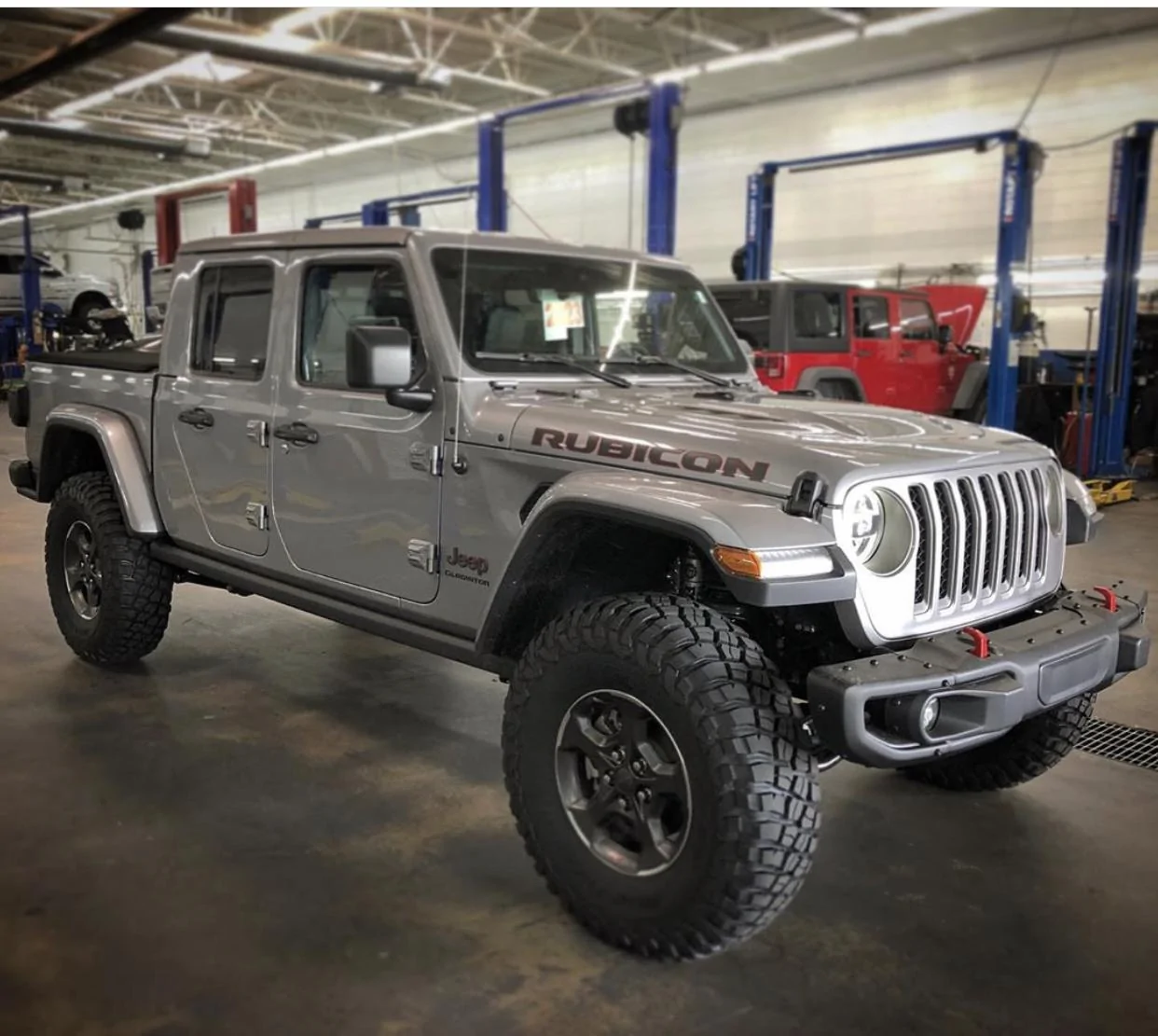

This is the best picture I could find that makes me think that the rock rail is at least wide enough to protect the rear fender. Maybe not full coverage but it is close enough to deflect most rocks thrown up.
