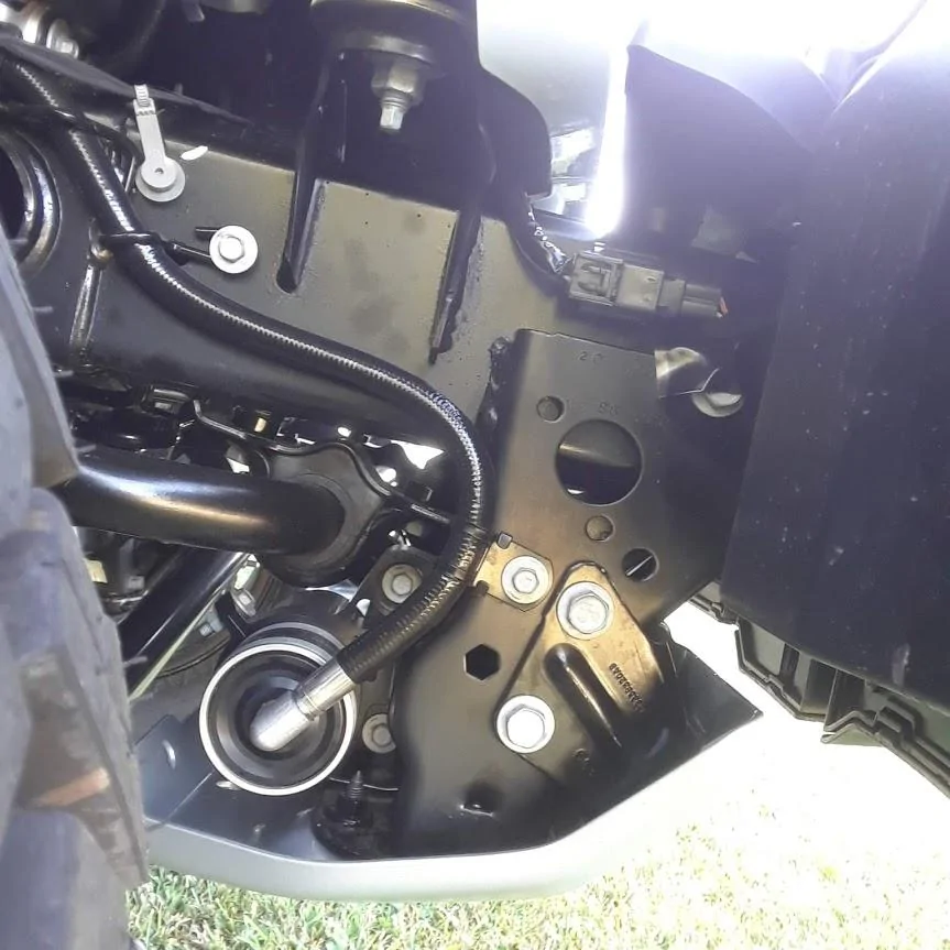

Let's see if I took a picture that helps:
Jeep Gladiator Mojave Aftermarket Bumpers reservoir

That looks like to me they are sitting where the skid plate is on a rubicon. Is that part considered a skid plate? If so I know mine will work for sure on there. It took me a while to find something at would work with that component. Most don't.
$500 is reasonable, but its not winning style awards. You are probably looking towards a stubby that is a winch plate with a shell. Thats really all mine it. Works and looks good though. Since you don't want to block airflow your options are further limited in that price range since many of the cheap ones have you bolt on top.
Since you tow options will be further limited because you ideally want to go down as low in weight as possible to not negatively impact your payload rating. Stubby is the way to go unless you want to make it rain for an aluminum.

Yes, the reservoir is just above the "skid plate". Stock photos show it from the front. Might keep snow from smooshing up in there..
