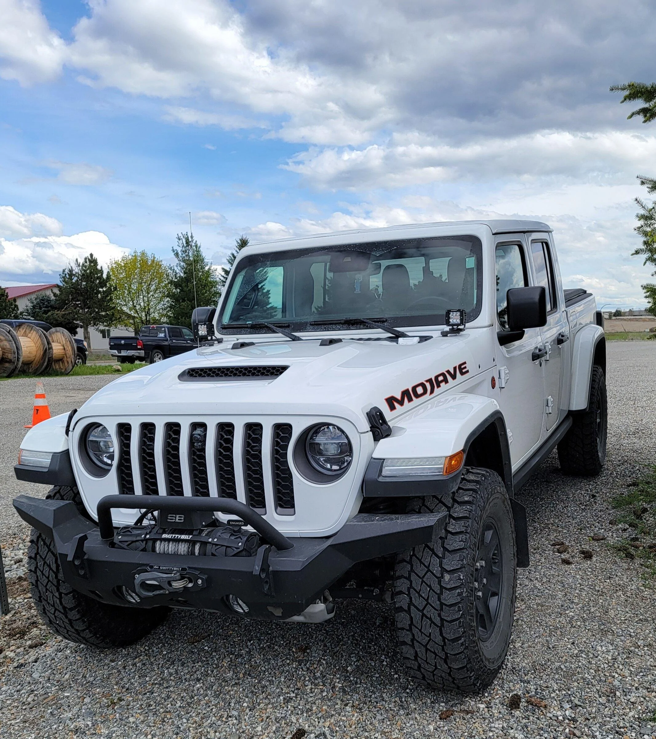

I love my Mojave...
Rugged Ridge HD Full Width Front Bumper
Smittybilt XRC GEN3 12K Comp Series Winch with Synthetic Cable
Did not notice a change in ride...
Jeep Gladiator Mojave Bumper Mods 20220512_160527
I like that one too. Stock led fogs fit?

Yes, stock LED fogs worked great
