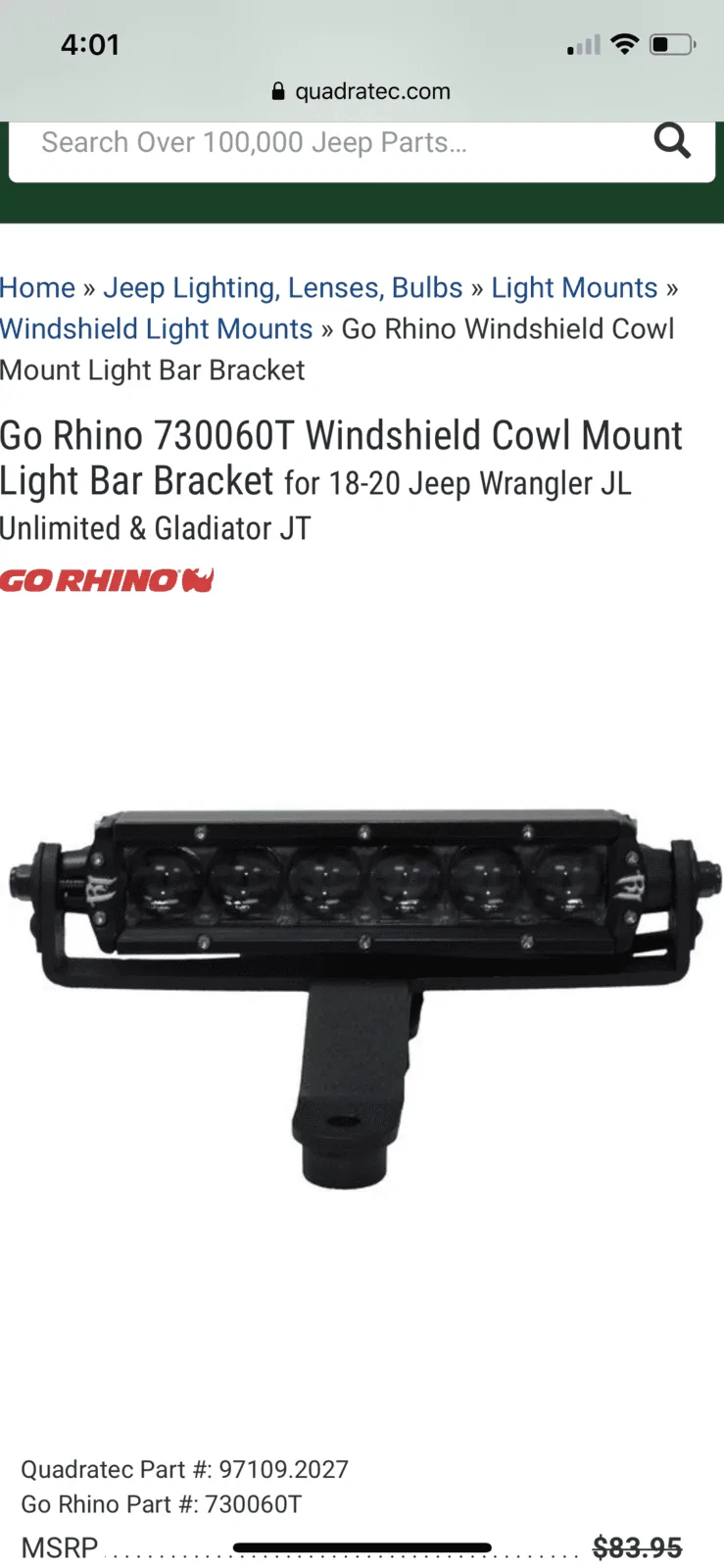

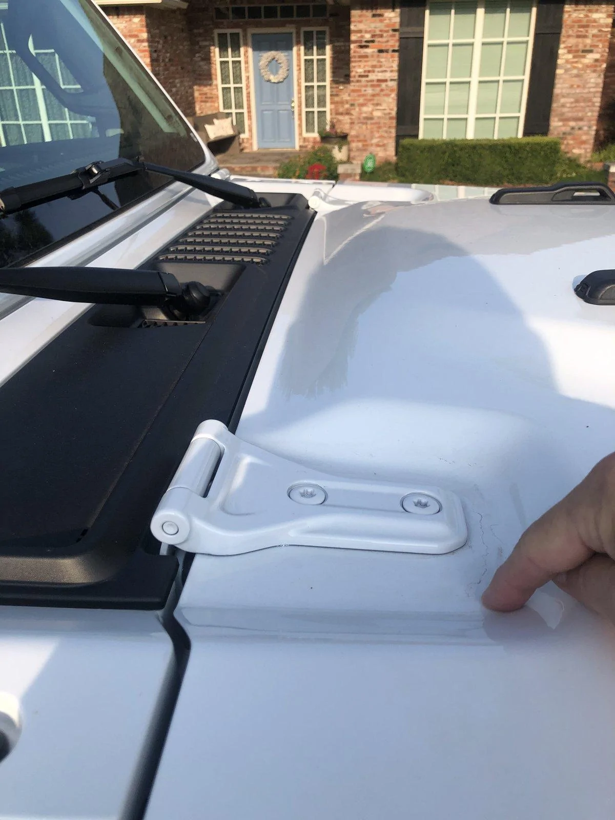

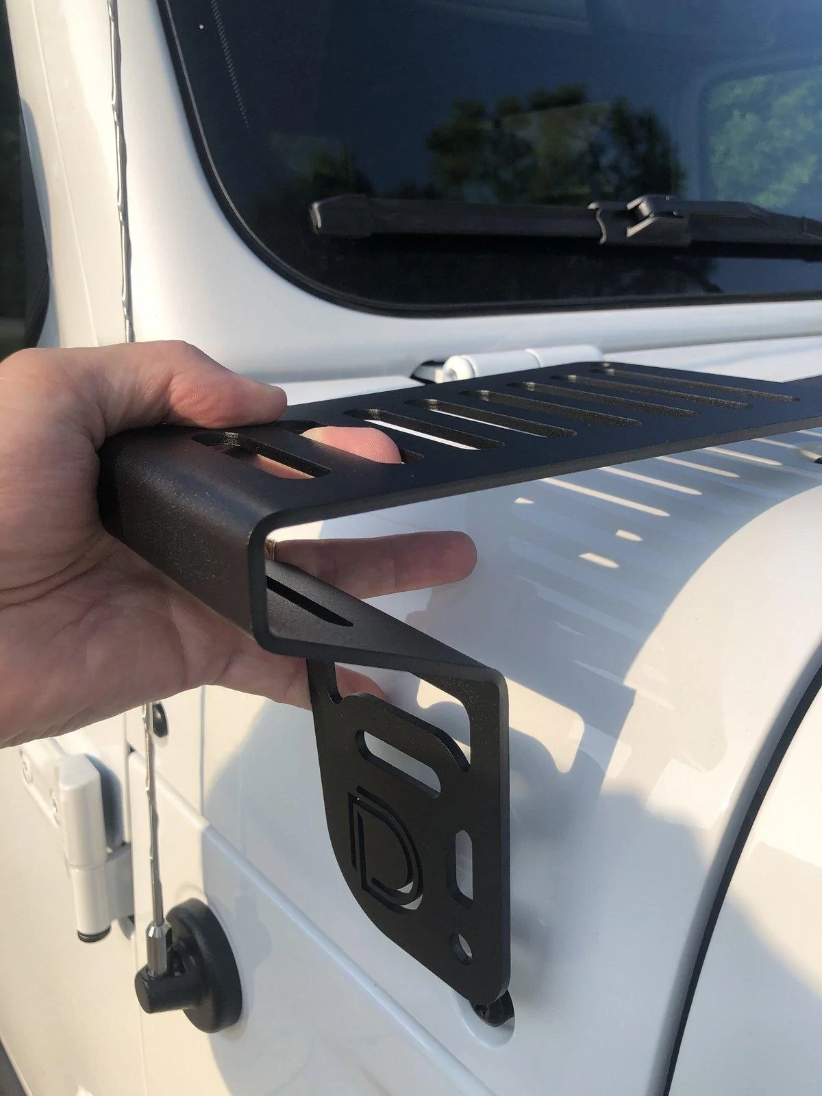

I just attempted to install a set of cowl light brackets on my JT Mojave. They don’t line up. Turns out the cowl on the Mojave is deeper than other JT and JL models.

Thanks but they seriously don’t fit. Not my first rodeo. I have a jk that has a painless trail rocker and multiple lights all installed by me.

My first clue was the new hardware is supposed to be longer than the factory Hardware and it was actually shorter

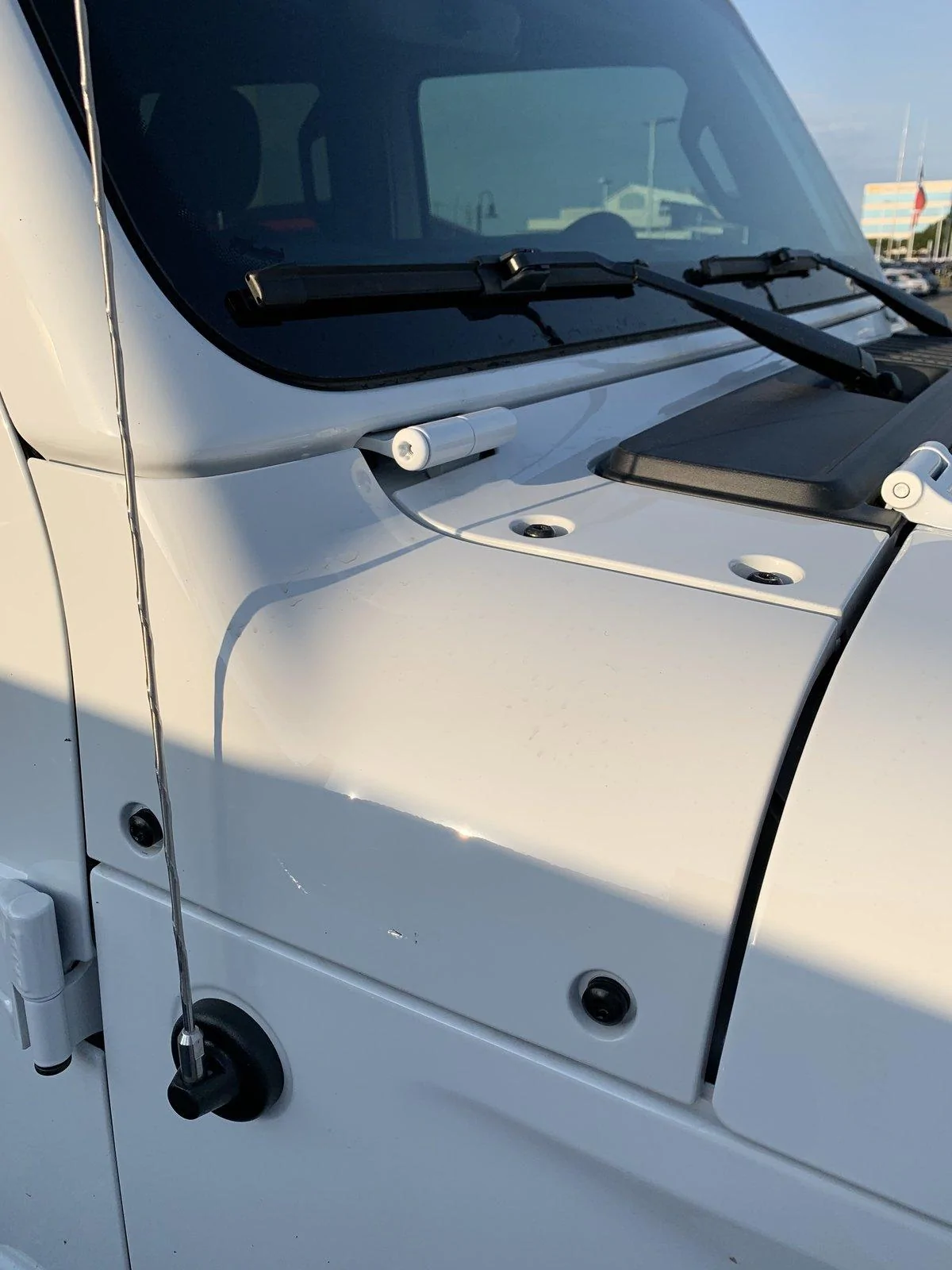

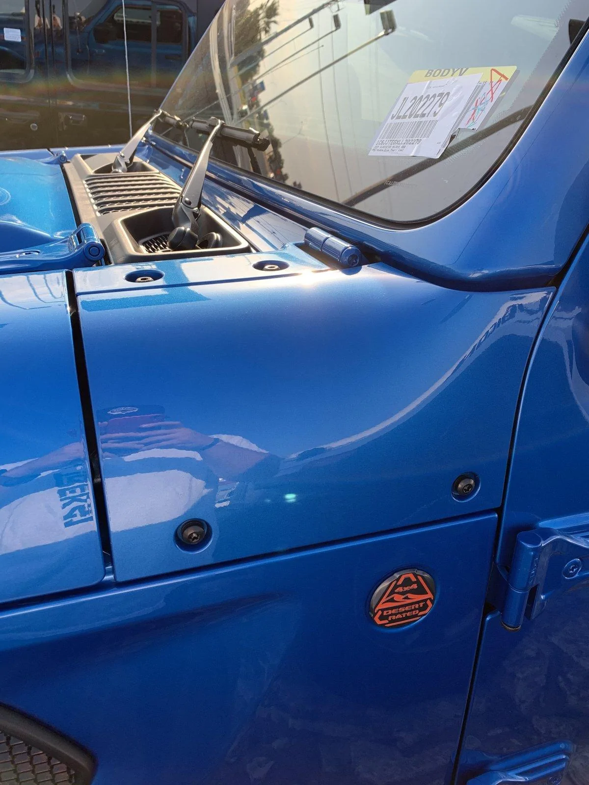

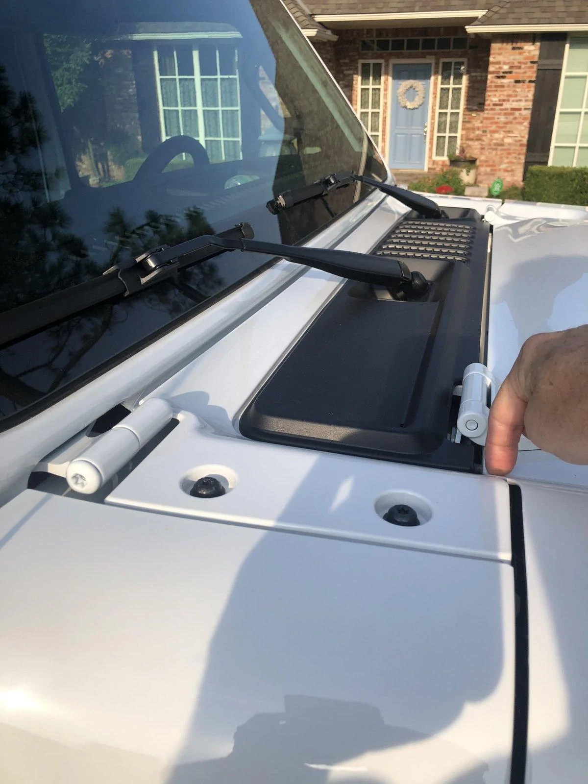

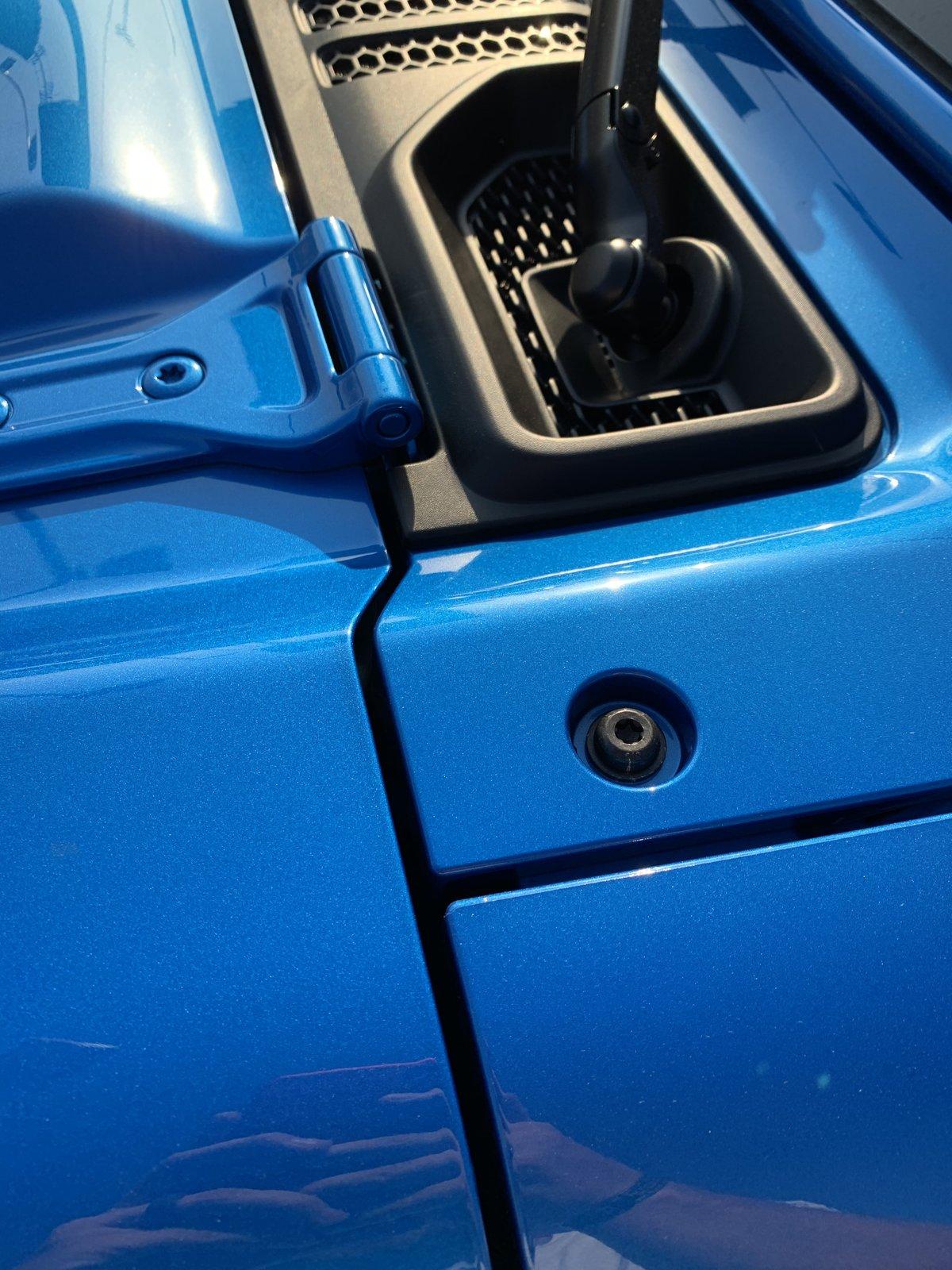

Definitely different. Your post got me curious since I’m working on a new product to replace the cowl on a JL/JT. Just got back from the dealer and the shape is different on a Mojave and the hood is taller. You can see the drop off the cowl in my last pic. White is aRubicon JT

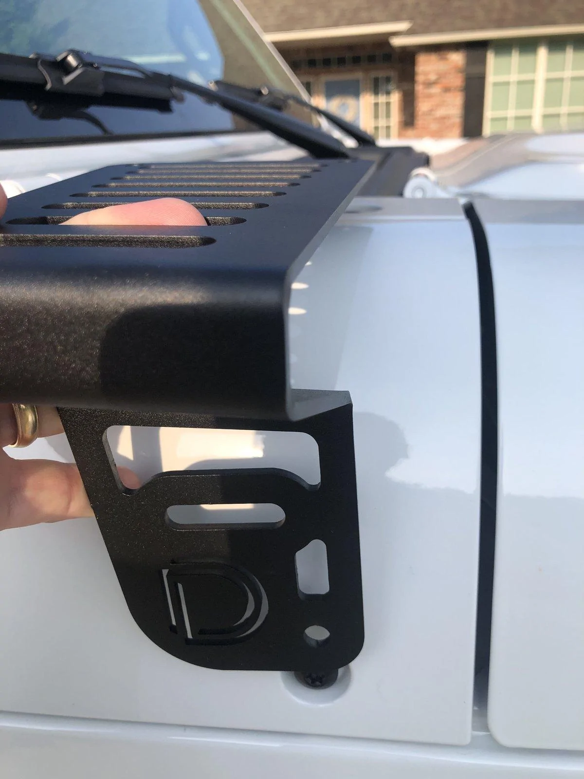

Ran into same issue with my Diode Dynamics cowl brackets I had removed the day before off my JL. The Mojave is different. Sent them an email Saturday morning. Also thought the hood felt heavier than the JL.

Different hood and wiper surround on the Mojave. DD will have to note that the stock mount won't work with the new hood. Not really their fault, but they should make it right.

Bought them from Quadratec and they are giving me a refund. Just disappointed because I like the way they look and was going to put KC cyclones on the side pointing down at an angle
