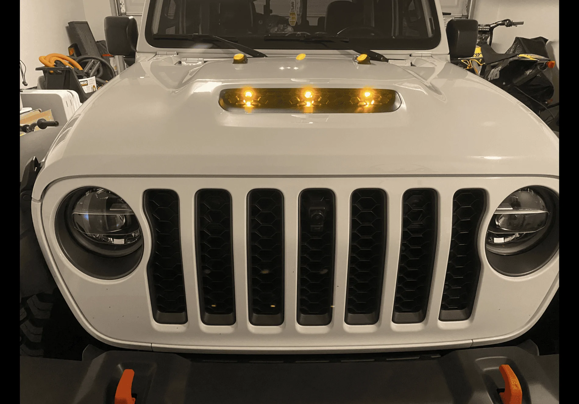

Nice work!!

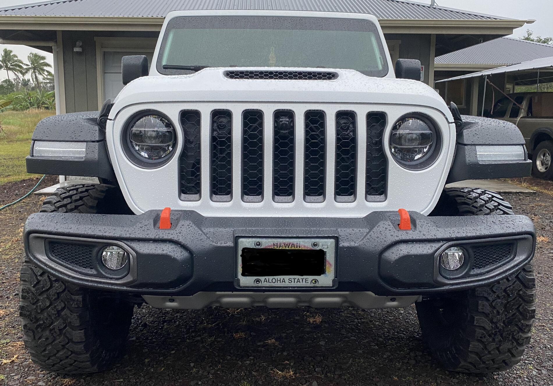

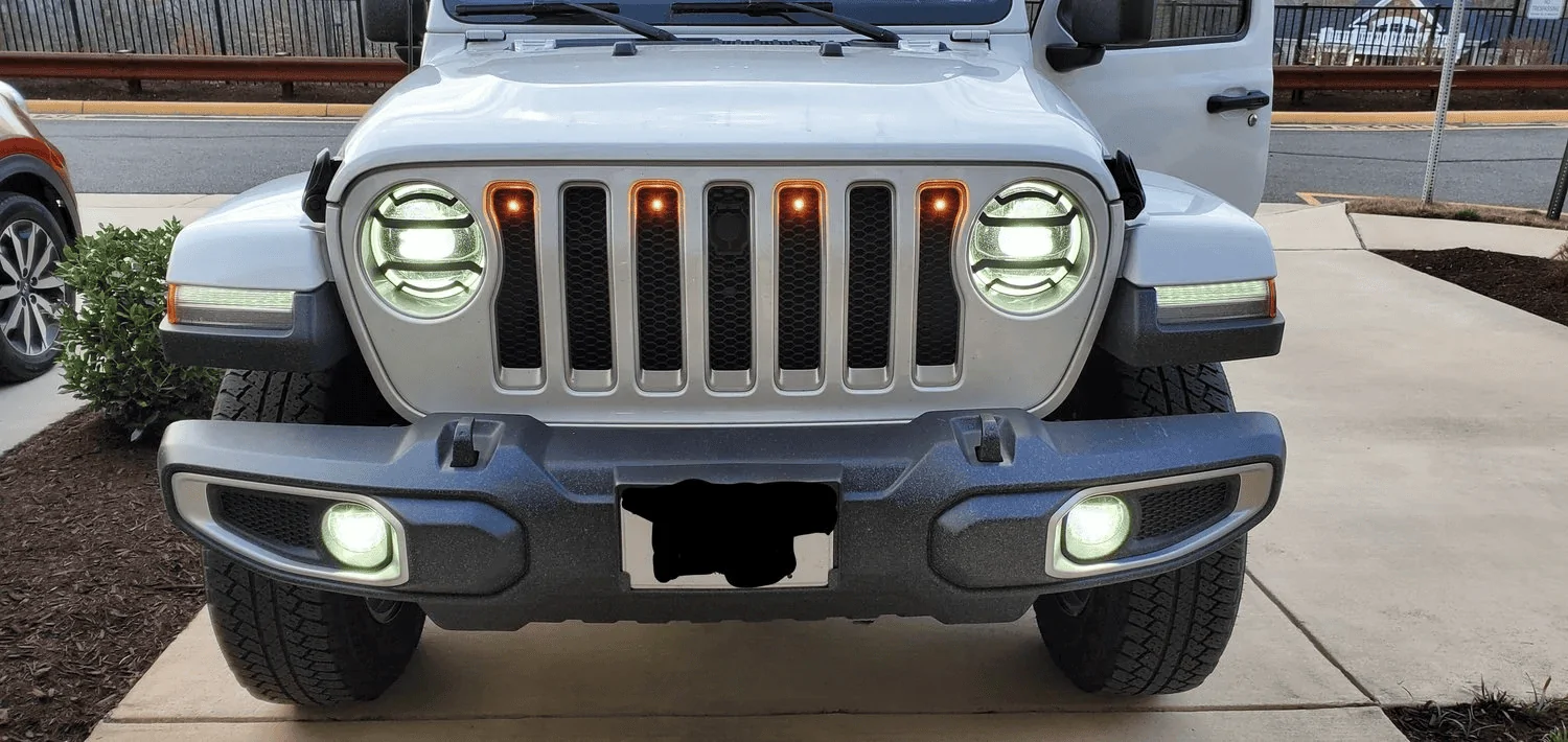

here is a pic i found on web, going around Front Facing Camera
I thought about that too’ but i kinda like the 3 light setup & putting them lower in the Grill below the Camera just didn’t look right...Thx!

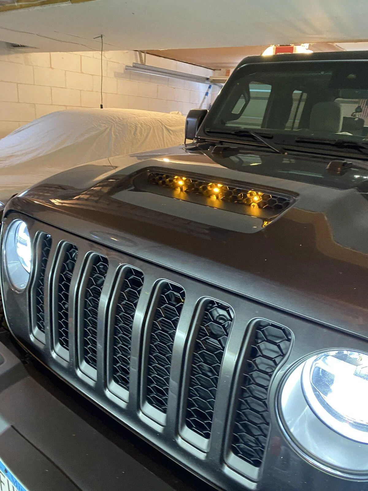

I don't even have to ask my wife, whether throw pillows or marker lights, odd numbers is WAY better. Looks GREAT!

Did you wire them into Aux switch or marker lights ??

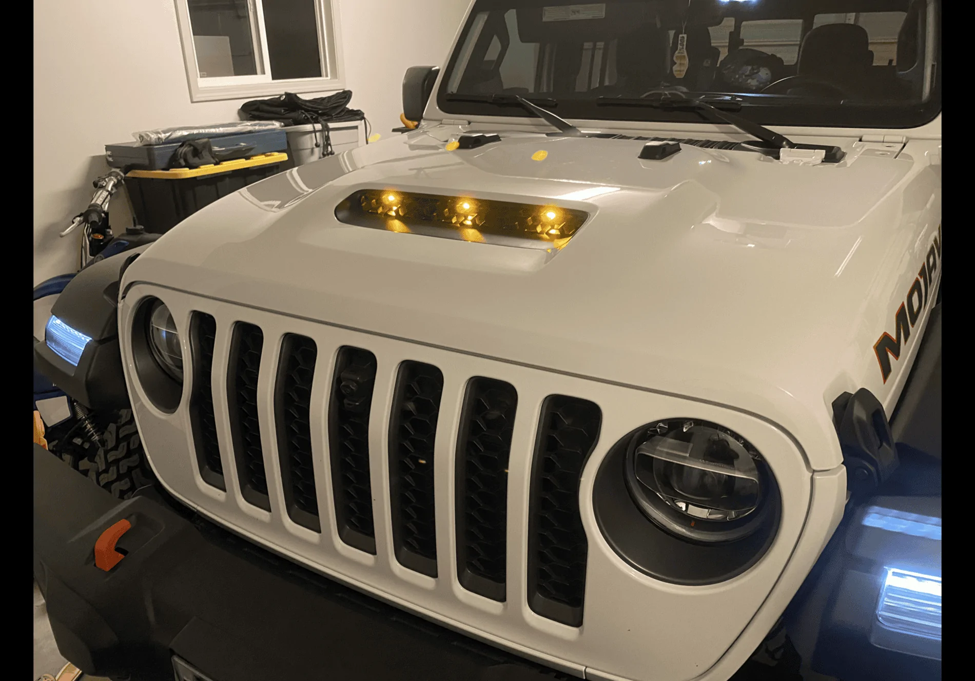

Ok you gotta write up how you did it! Looks great and gives that scoop a function. Love it.
mellendic
Rick
Jan 14, 2021
178
301
Maryland
revkit.com
2021 Jeep Gladiator Mojave
IT Security Researcher

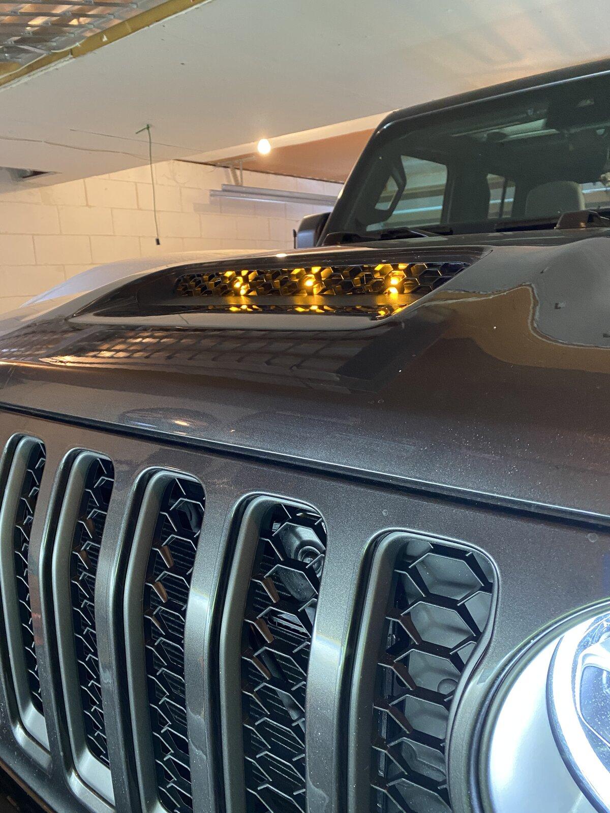

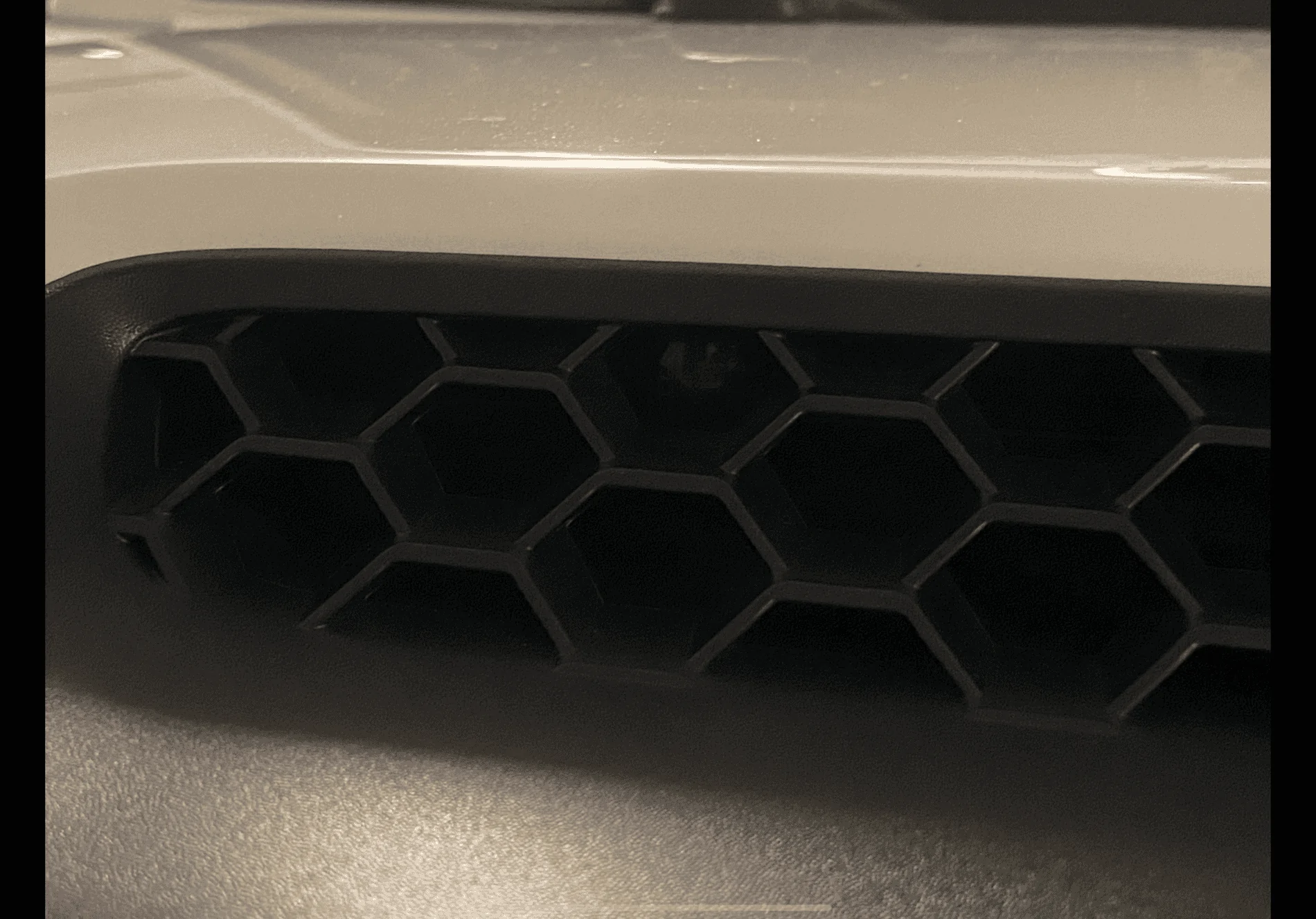

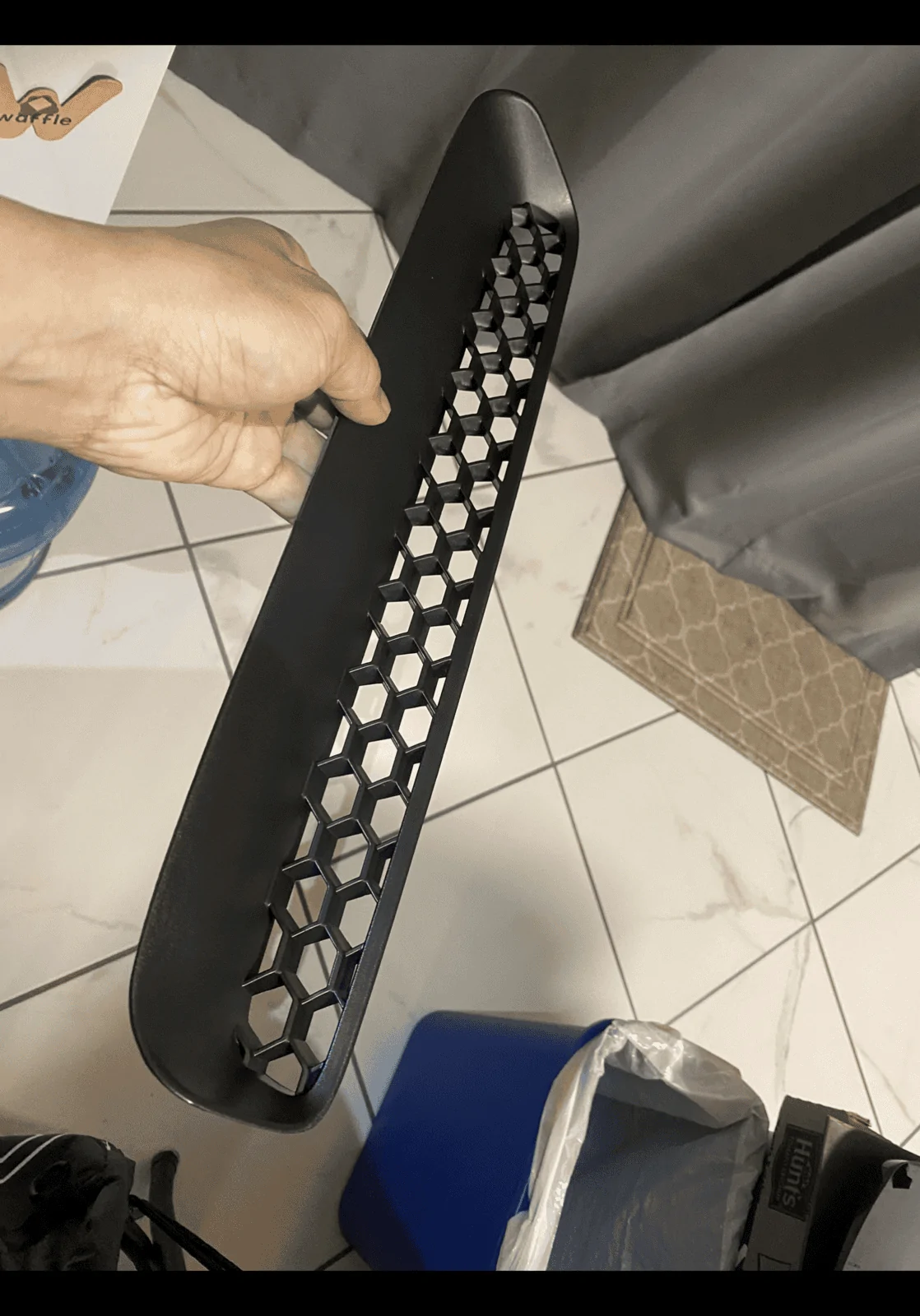

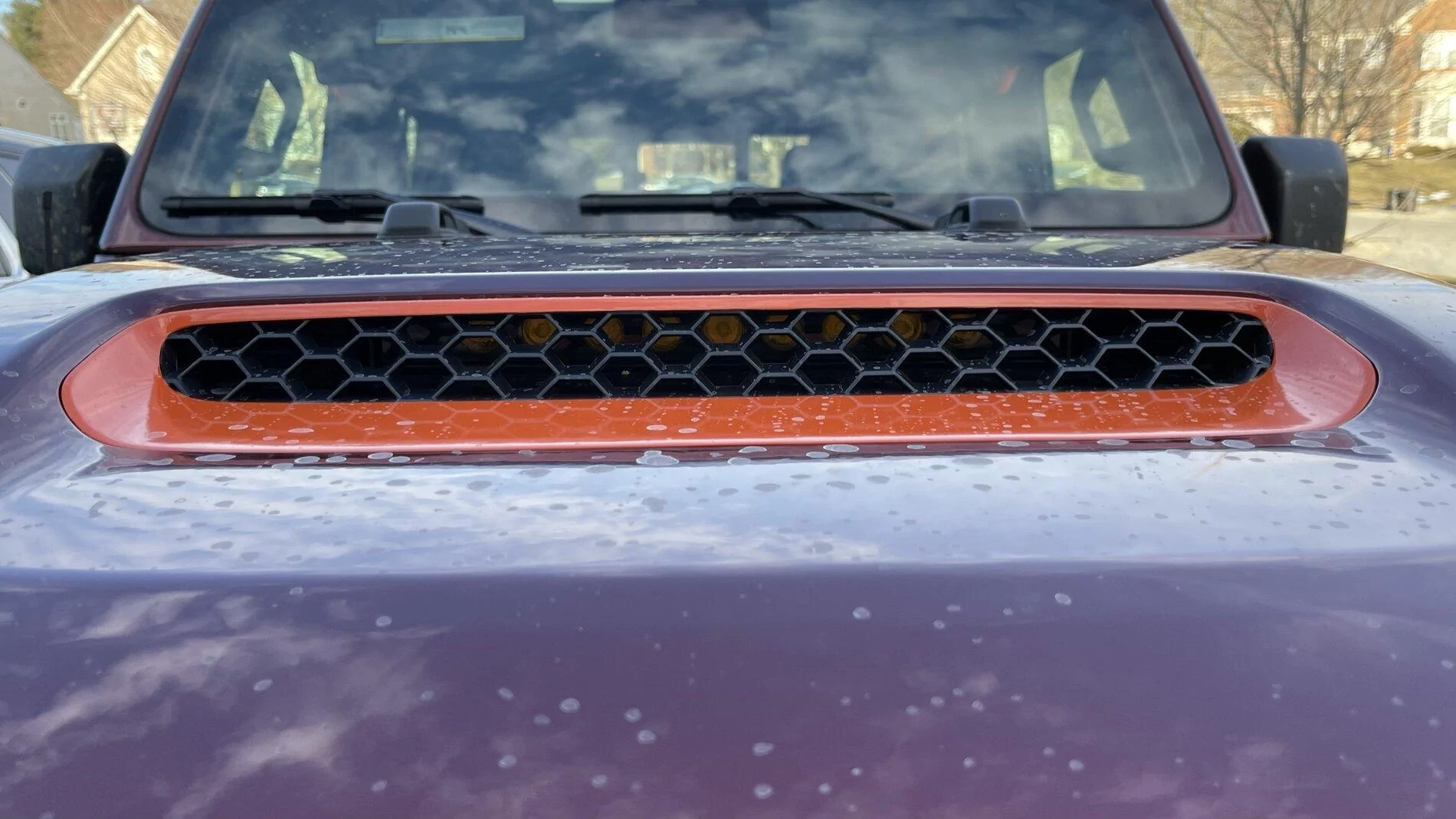

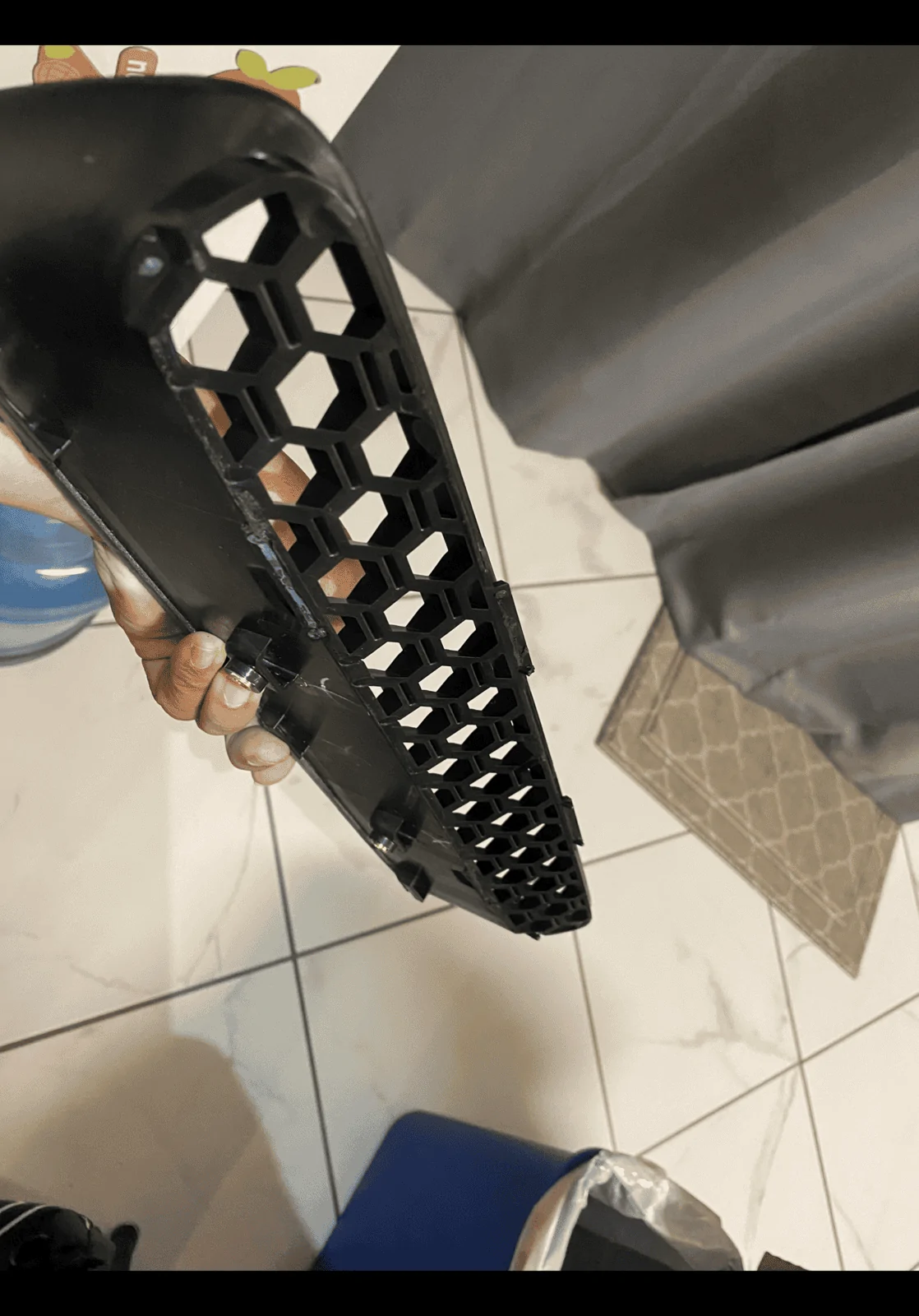

The light bar is a Rigid 10 inch bar with an amber cover. The vent was dremmeled out from the back to open it up and the light is mounted into the vent (in the plastic) and then re attached using the factory equipment. I had the edges of the vent painted with the rest of the mods to color match the Mojave orange. I had the idea when I wanted a second set of off-road lights on the front but didn't want to see them. The guys at ATO in Baltimore did the work based on what I thought would work, Jimmy figured it out and I am super impressed, it is run to the aux 3 switch and works great. I have to take out the hood Diaper to get better interior pictures and will do so when I install the KC light kit for under the hood... soon
