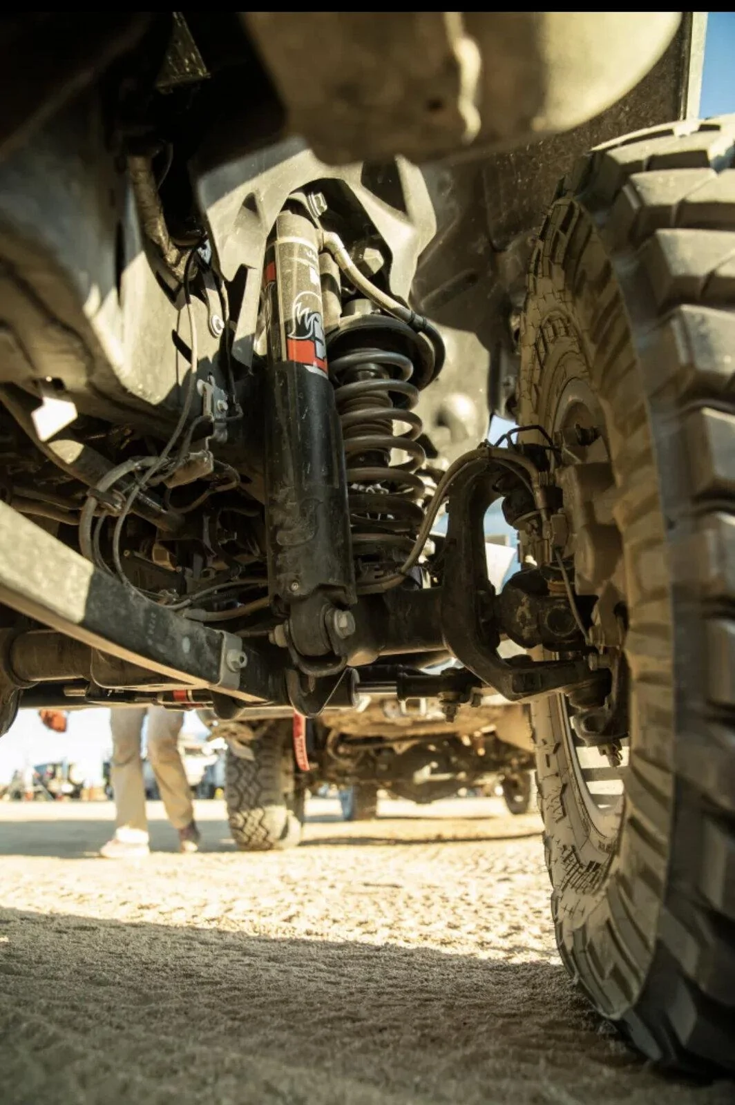

Mojave Fox rear Shock squeak/noise

I have it on the 2.5 adjustable version. I know that a lot of others had it too on the stock 2.5’s.
I reached out to Fox they said “it should go away once the seals wear a little” that was at around 500 miles, had them for about 3000 miles and they still do it. I just shoot some silicone lubricant on them and it goes away for a few weeks. I will eventually take them to Fox since they are local. Weird thing is that it’s only the rear not the fronts.
I reached out to Fox they said “it should go away once the seals wear a little” that was at around 500 miles, had them for about 3000 miles and they still do it. I just shoot some grease on them and it goes away for a few weeks. I will eventually take them to Fox since they are local. Weird thing is that it’s only the rear not the fronts.
How do you grease them?

The outer dust seals are dry. Smear a little silicone grease on the shaft near the seal. This should take care of it.
How? Looks all sealed up

Remove the 3 screws at the bottom of the black plastic shield. You can then raise the shield, exposing the shaft and the bottom of the shock body where the seal is.
I don't hear any noise from my Mojave when driving it, even with the windows down. However, in the garage, if I bounce the suspension by hand, I hear a faint squeak from both front shocks. The rears are silent.

all 4 of my mojave fox shocks are bad noisy and sound like old farm truck. the 1st of the 4 comes in tomorrow which is the right rear. it's the WORSE. i mean my truck sounds like it's 30 years old. I've had it for 11 months and only 11k miles. FCA wants to replace 1 corner at a time...
It's been all I can do not to trade it for a ram. If the top and doors came off of a ram I wouldn't blink an eye. it's only thing keeping me in this mojave. Last thing I want is this to happen again and truck not be under warranty one day. It's a damn good thing I didn't lift it yet though.

Right Rear replaced.... Left rear and front right should hopefully be in next week. Front Left is on indefinite backorder.... now that my right rear is replaced you can really hear the left rear now and front left. That's how loud the right rear was.... it feels great having a 60k truck that sounds 30 years old. If top and doors came off a RAM....this would be gone.... I've been fighting the trade though. I really like my gladiator but man it sounds like a PoS.

I am in the same boat! Mine sounds like it's going to fall apart and is embarrassing. I have an appointment to get it looked at but I am scared they are going to say my AEV 2" spacer lift is the cause ughhhh
