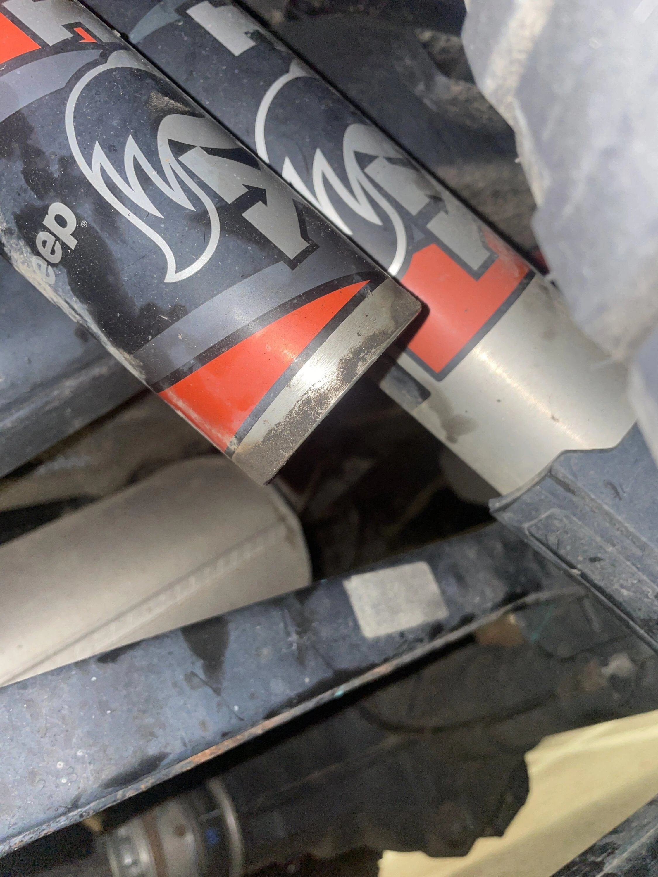

Pressure washed This morning I noticed there was a dark coloration on the bottom of the reservoir/ fox shock in my Mojave.
driver side rear
Could this be a small fraction of a reason this could cause subtle shaking from the floor board?
Have an appointment at jeep after the weekend. I have been scratching my head on why my floor board has a bit of a shake ness to it and not at the steering wheel.
driver side rear

That’s definitely what my shock looked like before they replaced it.
