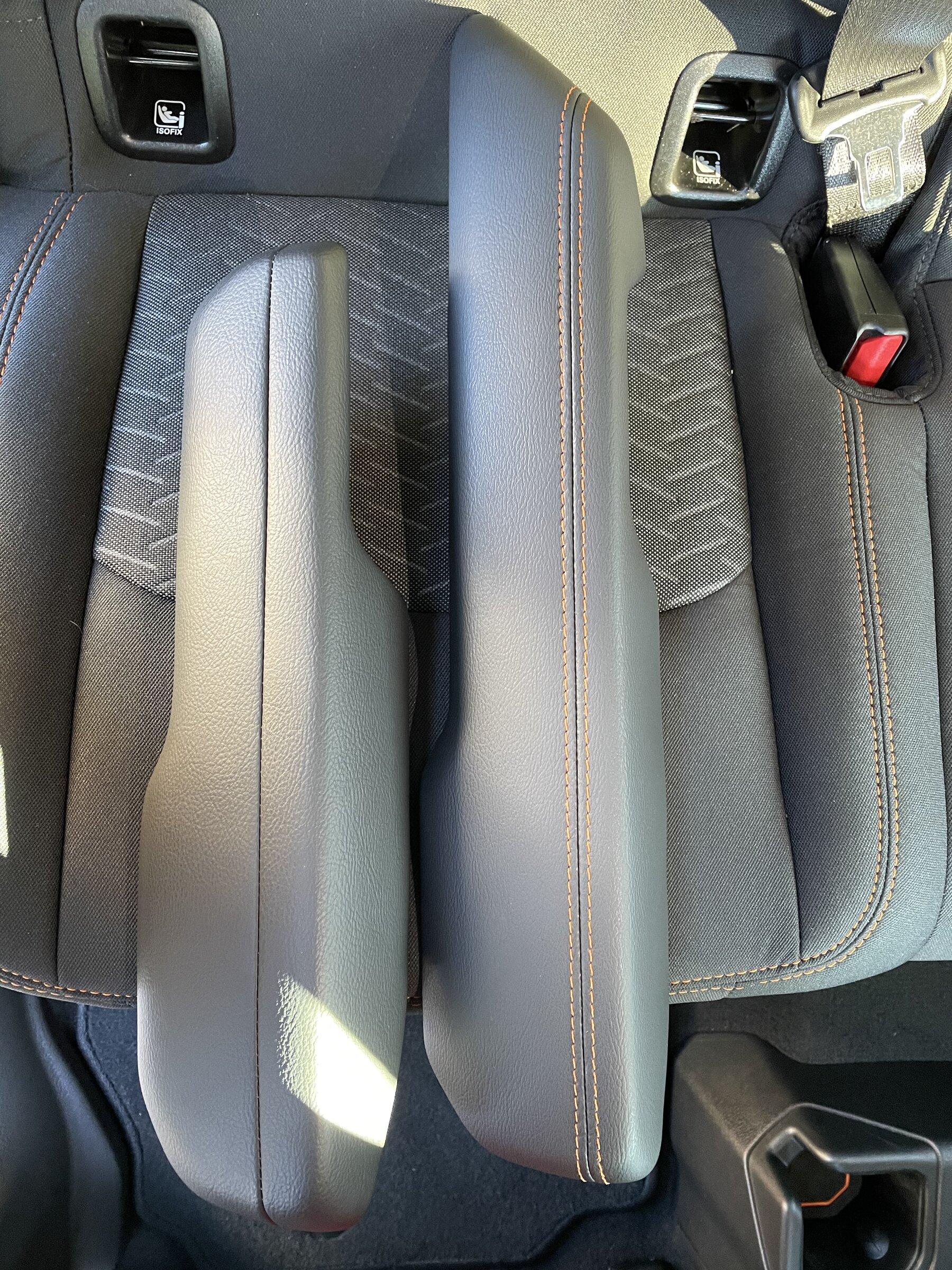

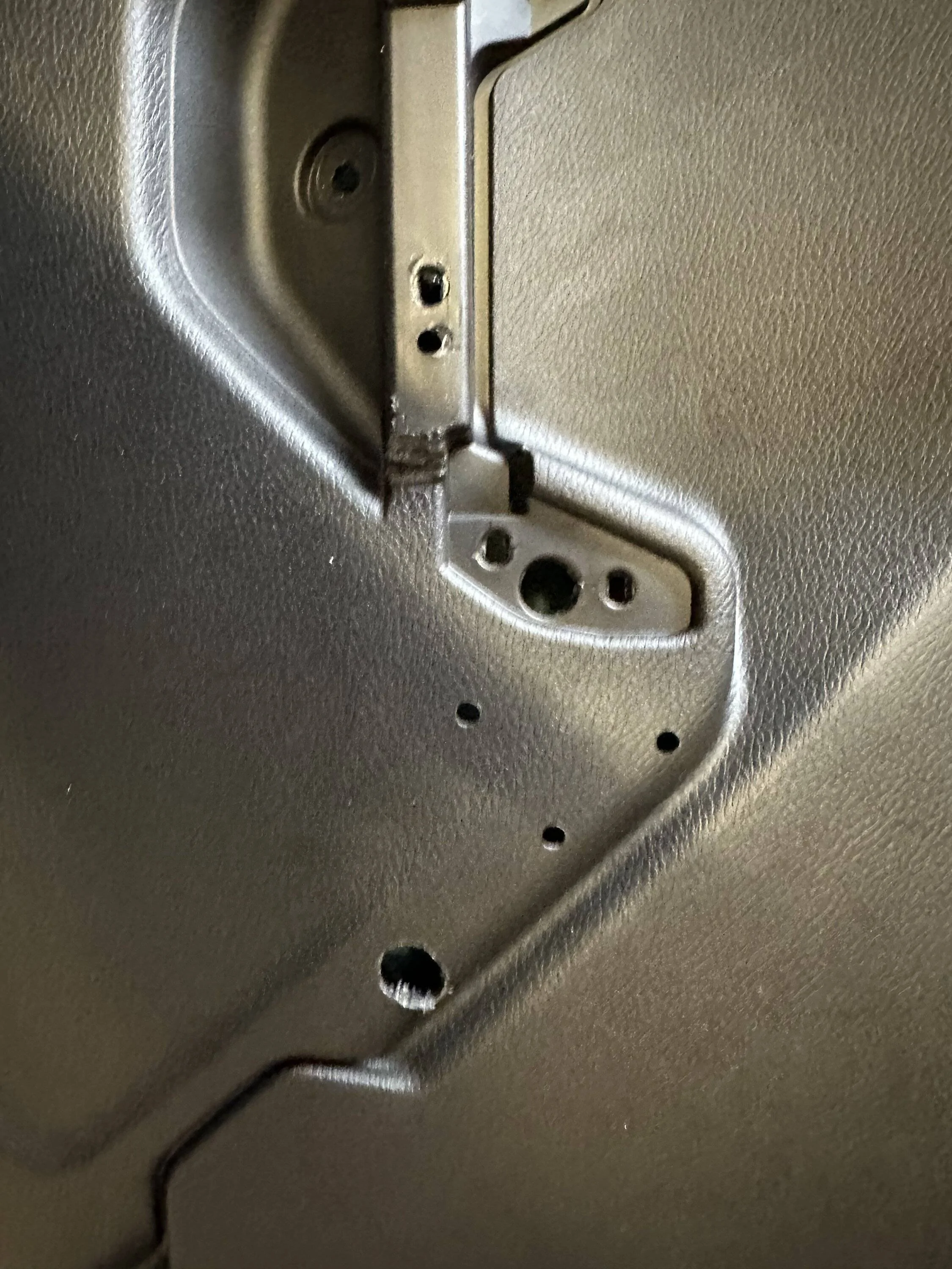

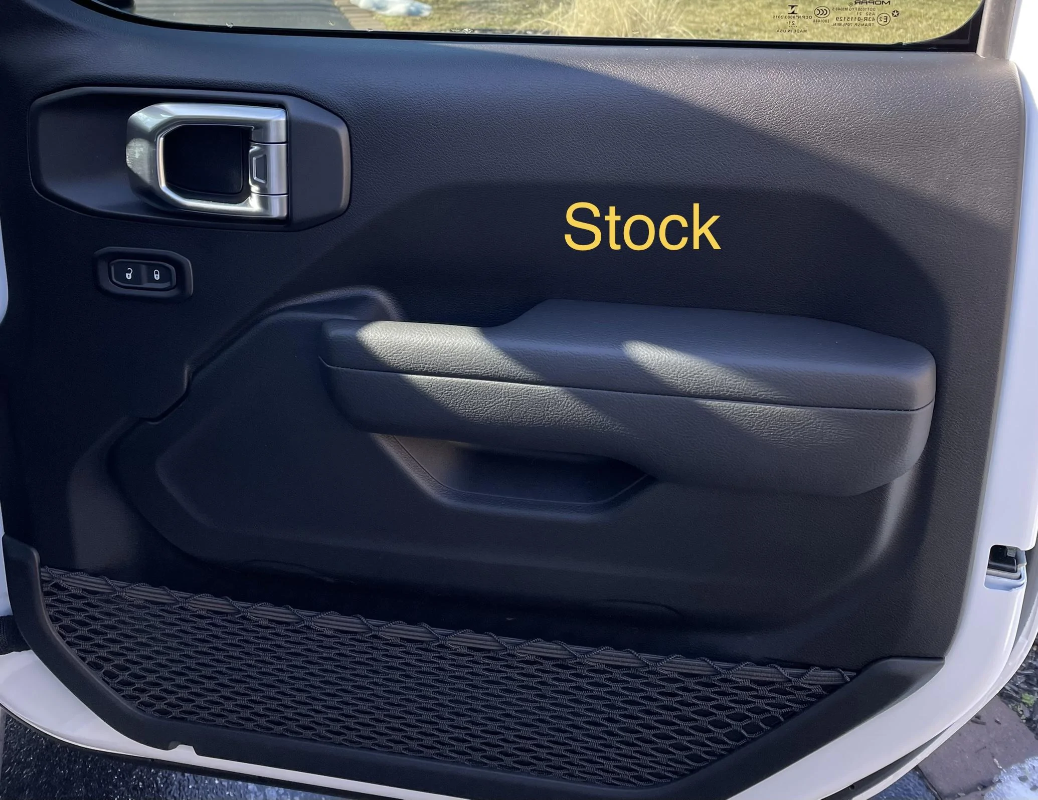

Purchased the Black leather w orange stitch Mojave door pulls/armrests from the “Mojave part list” thread and to my surprise the part is way different then the stock vinyl one from my cloth interior Mojave!! Any thoughts? Crazy they made 2 different size parts? And apparently different door panels between the 2 trims cloth/leather?
Jeep Gladiator Mojave leather Door Armrest fitment 576CD995-D803-4948-97B4-1382514B474C
Jeep Gladiator Mojave leather Door Armrest fitment 233C7DA0-85ED-421B-AA19-3D09D19E30AF
Jeep Gladiator Mojave leather Door Armrest fitment 1D8804A9-4A89-436A-B8AA-666F70B897A2

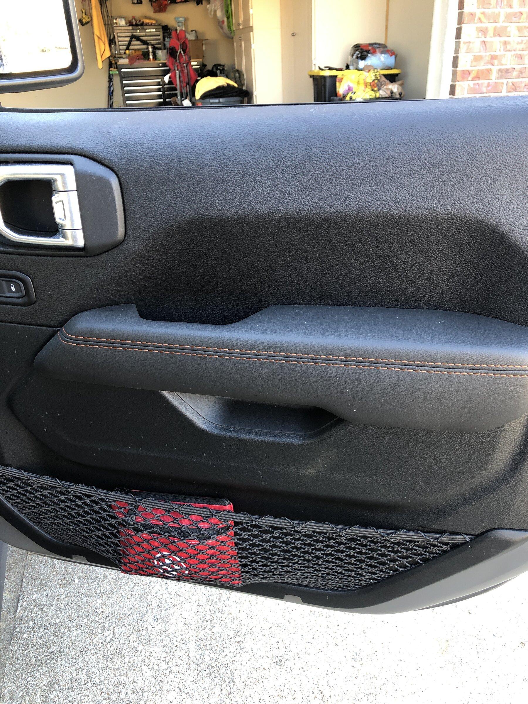

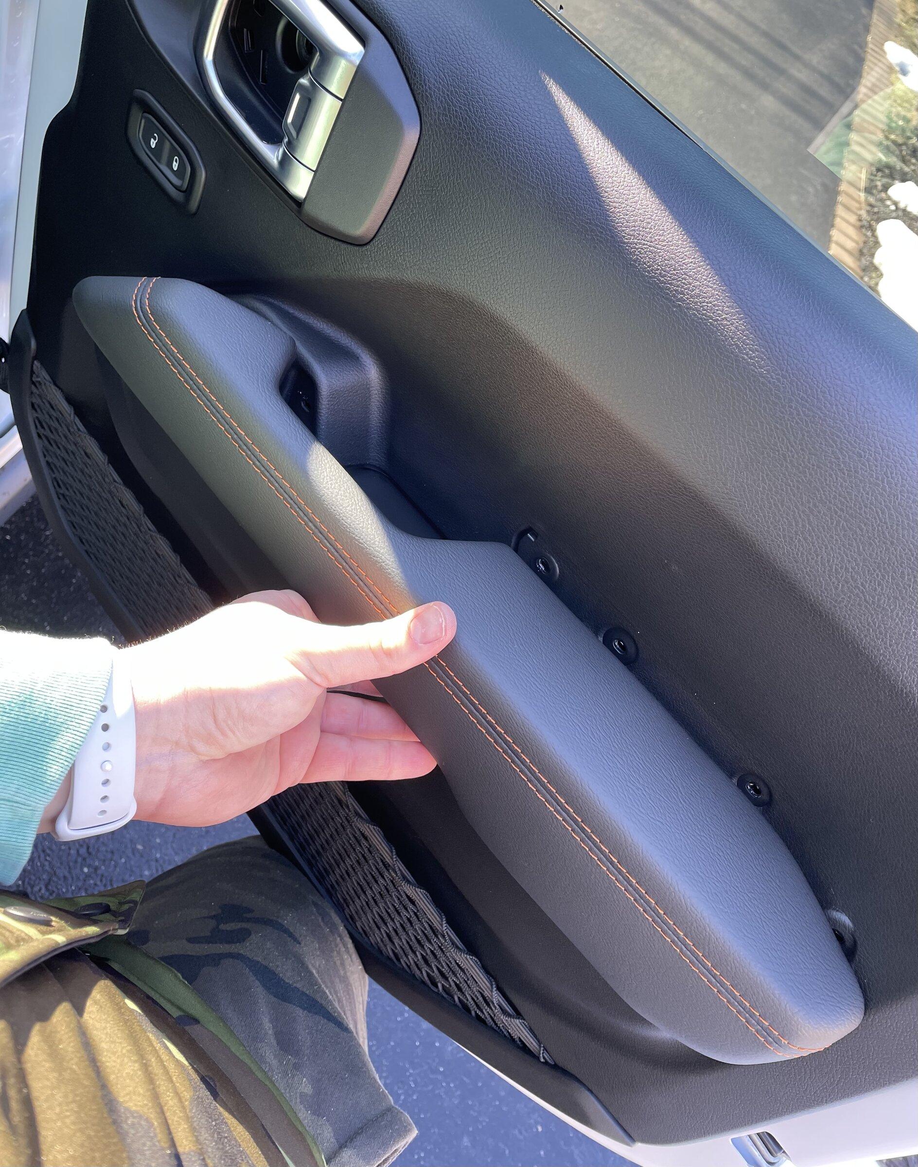

Looks like you may need new doors skins also to make it work? Here is my factory leather Mojave.
Jeep Gladiator Mojave leather Door Armrest fitment image

Looks like all the leather interiors have that extended arm rest... are the rear doors different?

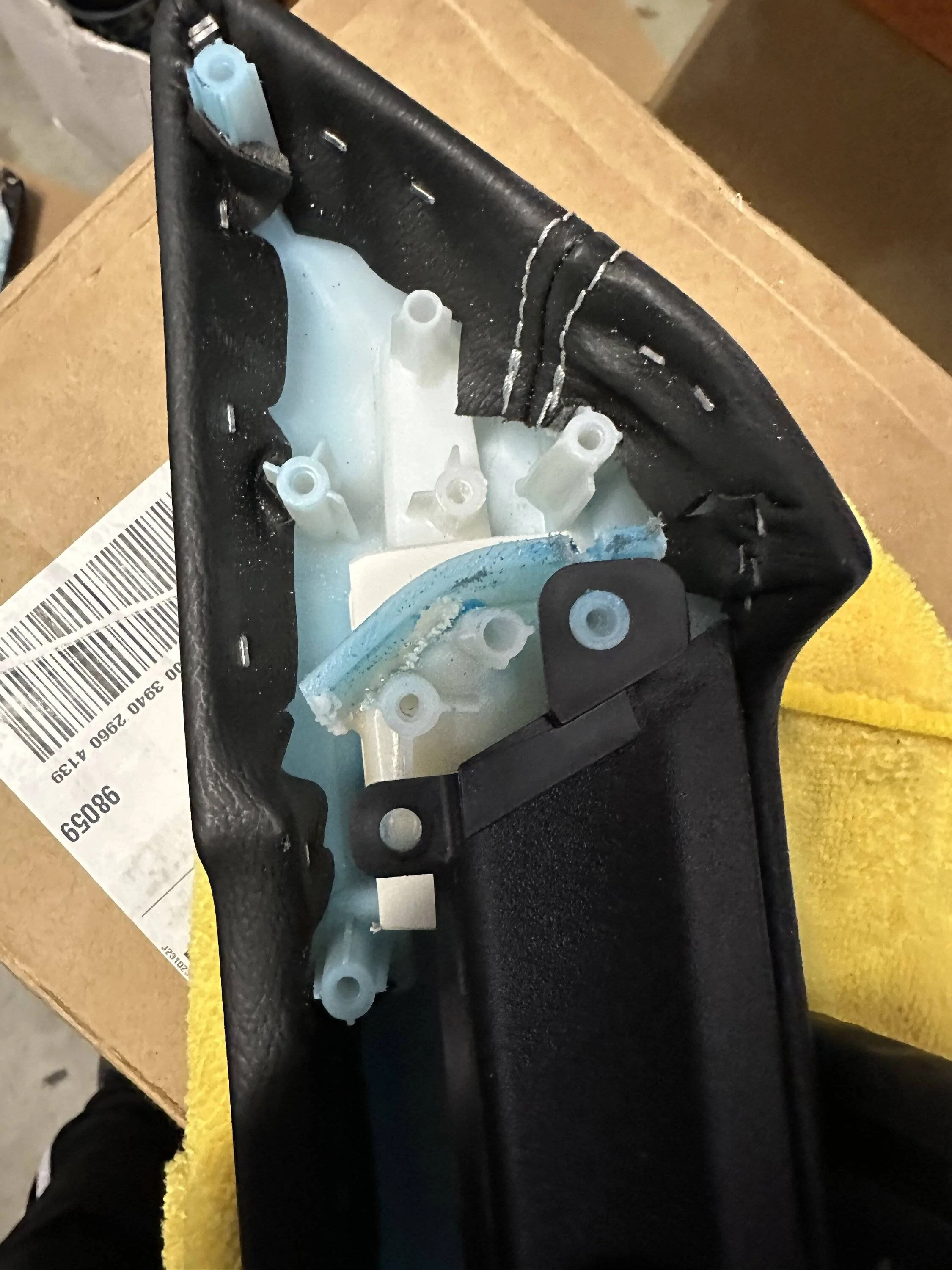

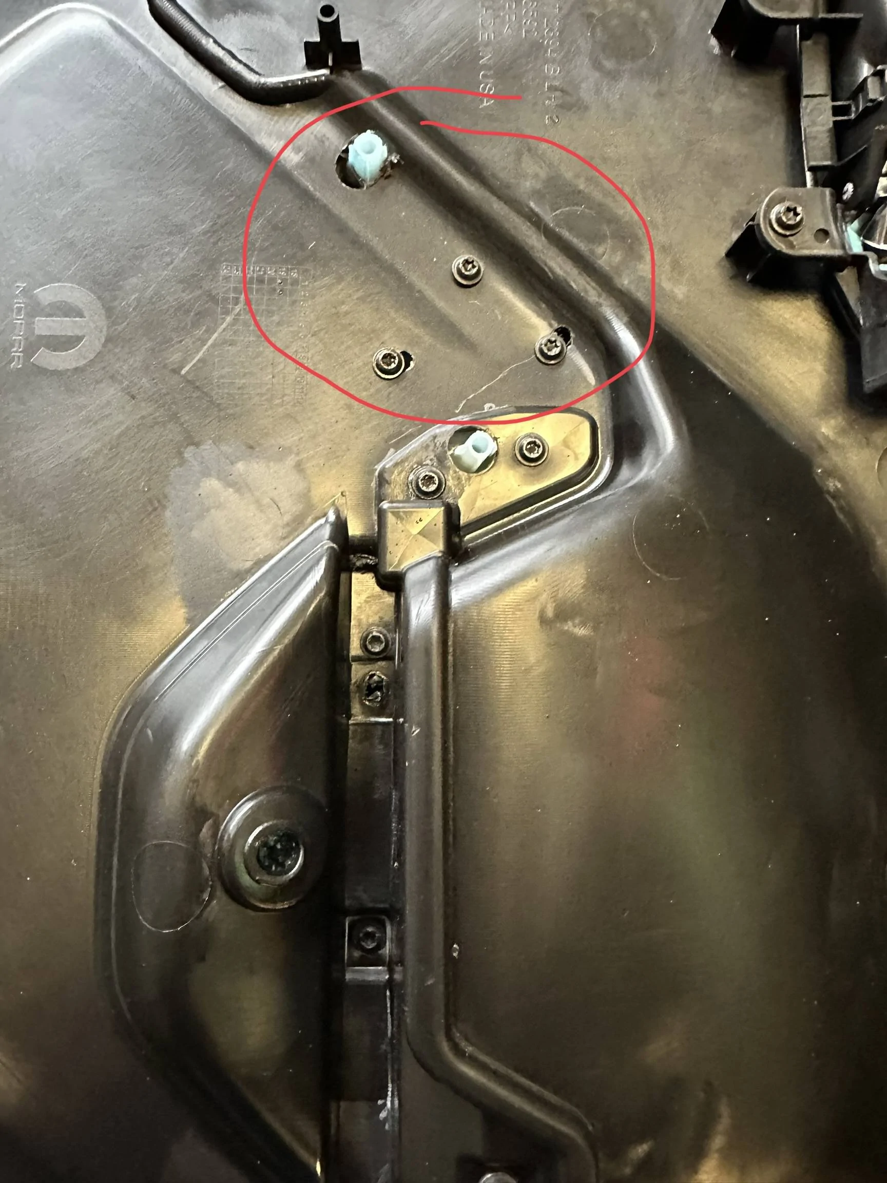

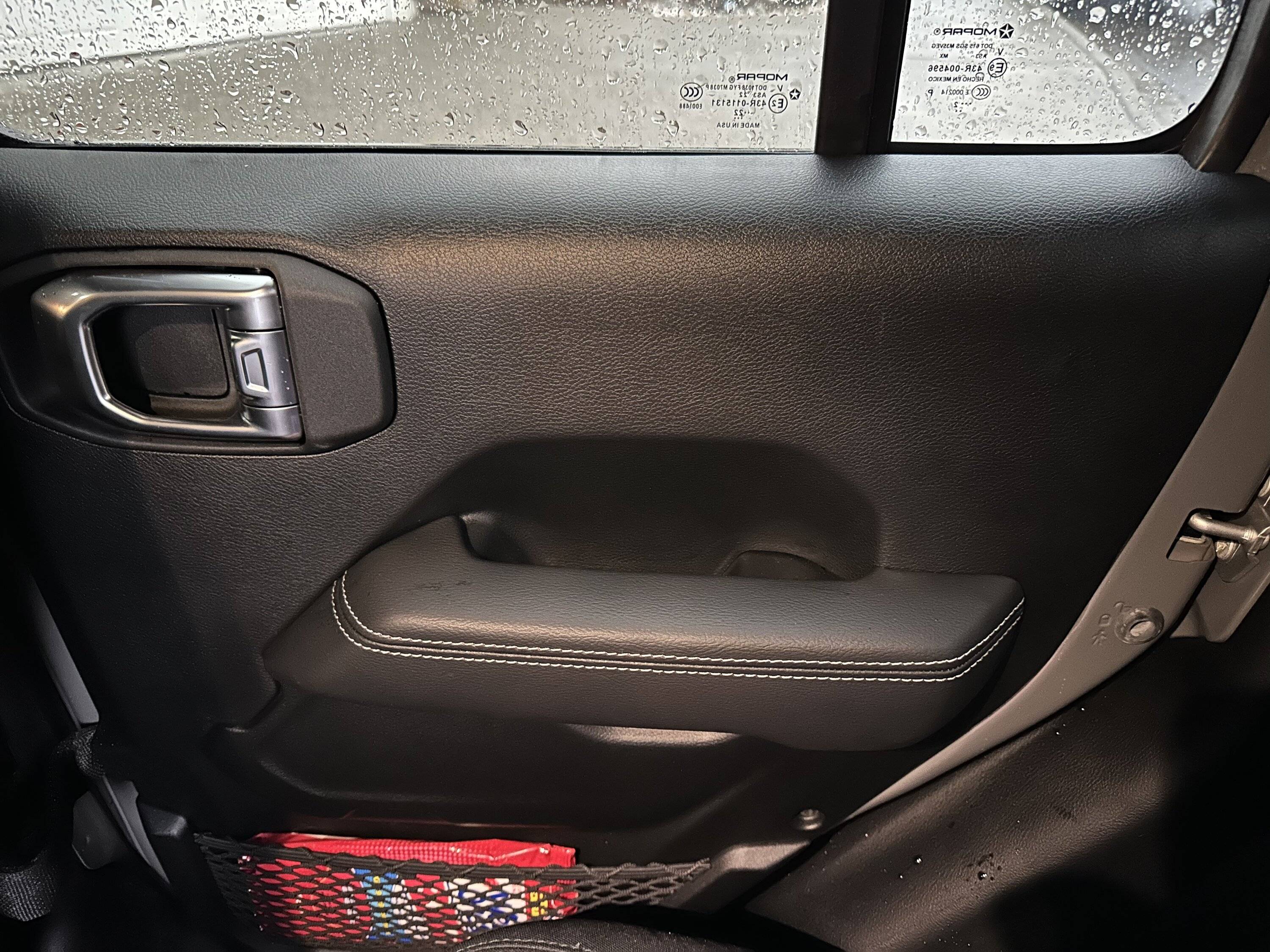

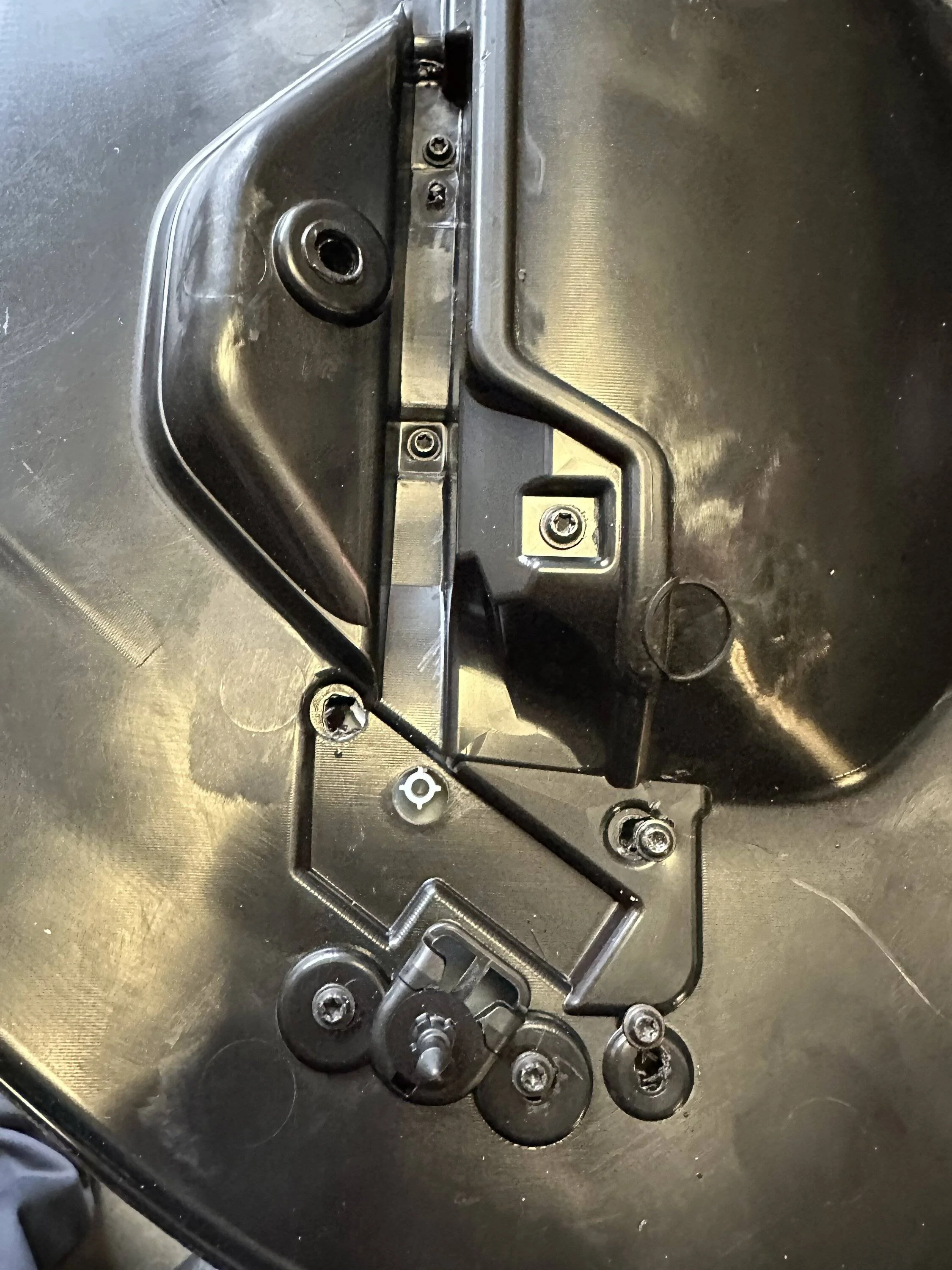

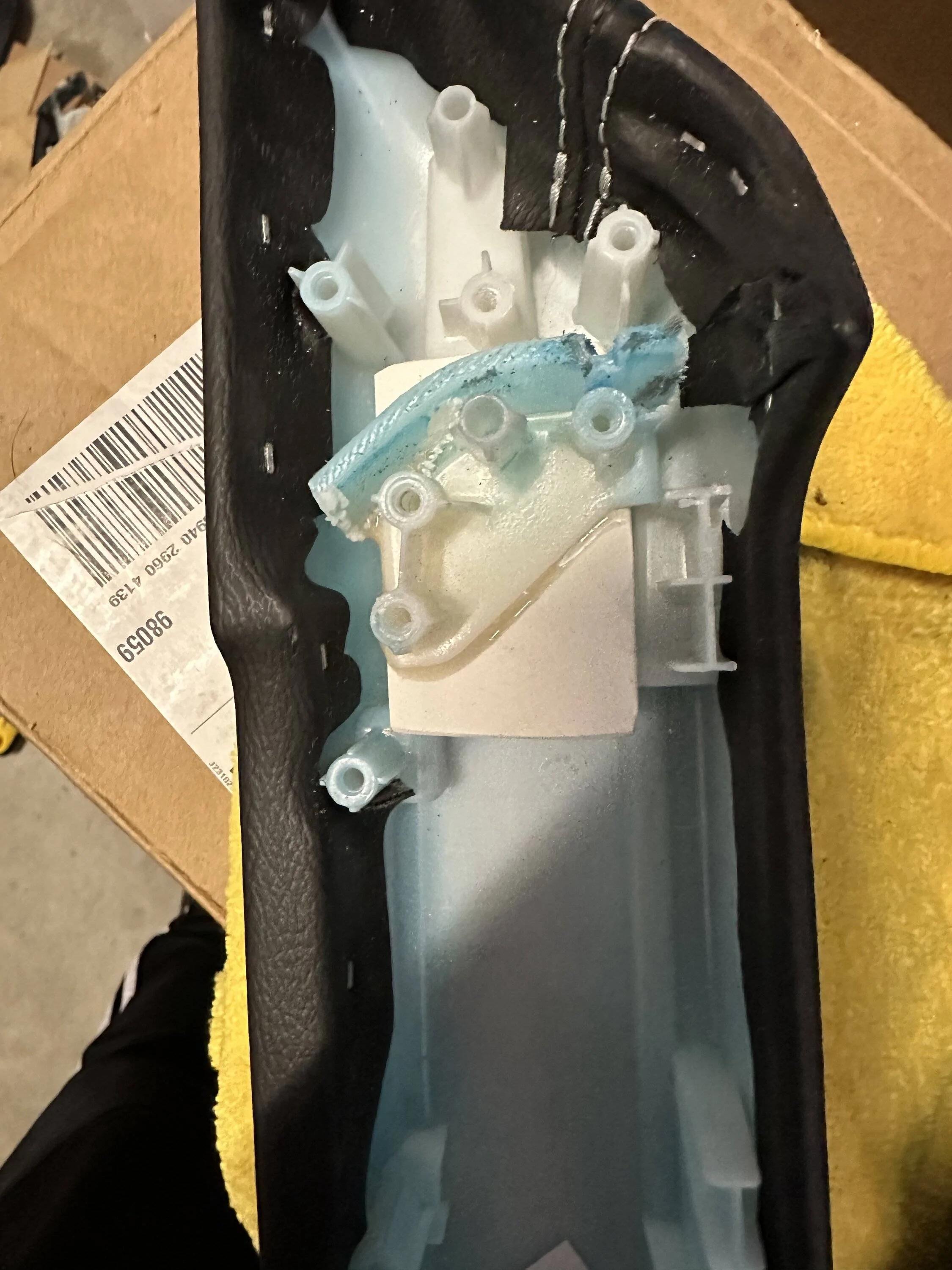

I didn’t find this thread before I purchased the Leather door armrests so I decided what the hell and tried to hack them in. I was able to make the rear door armrests work on the standard door skin, but haven’t attempted the fronts yet.
I did hack up the old armrests for a brace and reused the plastic insert so there was no plan B. It takes a lot of multi-tool usage for fine cuts to get everything lined up, and is not for the faint of heart.
It turned out looking like factory, but it’s not beautiful on the back by any means.
Jeep Gladiator Mojave leather Door Armrest fitment 639C73E1-965C-4DA6-8E5E-BC3BCF0EA494
It took a lot of messing around, but it’s solid since I used the front mount from the previous armrest to help hold the leather. Used some PVC I had laying around plus JBWeld plastic bonder.
Jeep Gladiator Mojave leather Door Armrest fitment 73885E3D-3EDF-42D0-95A3-5AE570B9934C
Jeep Gladiator Mojave leather Door Armrest fitment 18B16A83-9738-4E90-B21A-F2BDA798AB2B
Created a paper template & drilled some holes for the longer leather piece to be screwed to the skin. This allowed the leather to run with the natural line of the existing door skin.
Jeep Gladiator Mojave leather Door Armrest fitment E714543E-0277-46D6-BAE2-630581509907
Also had to shorten a few of the screw braces as they were too long for the standard skin, but got use of almost all screw brackets so it‘s fastened down as much as it would be to the correct door skin.
Jeep Gladiator Mojave leather Door Armrest fitment E867F329-6B5D-4B3E-892C-9990FF8DDA49
Jeep Gladiator Mojave leather Door Armrest fitment 7A231E8D-6D12-4F40-9DB4-6C38452E4713
Sorry, wasn’t planning on a write-up, so don’t have great detail of messing around with it to make it work. I can try to answer any questions if someone else gives it a shot.
