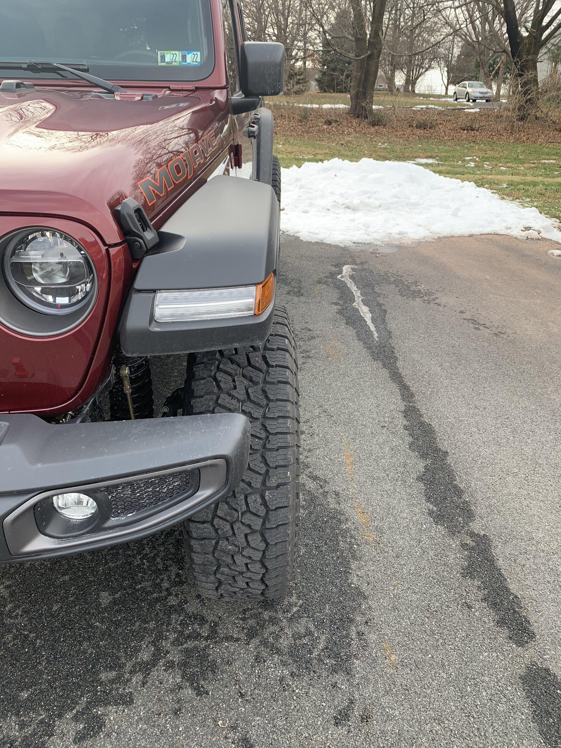

Assuming 8.5" wide, you'll likely want to go with the +25mm option on a Mojave based on your goals -- the wider axles and higher fenders mean you can run more offset/backspace without clearance issues. This is a good thing, as it helps keep scrub radius in check. I have the 705's in +25mm on my Rubicon.
A couple imperfect pics for ya.

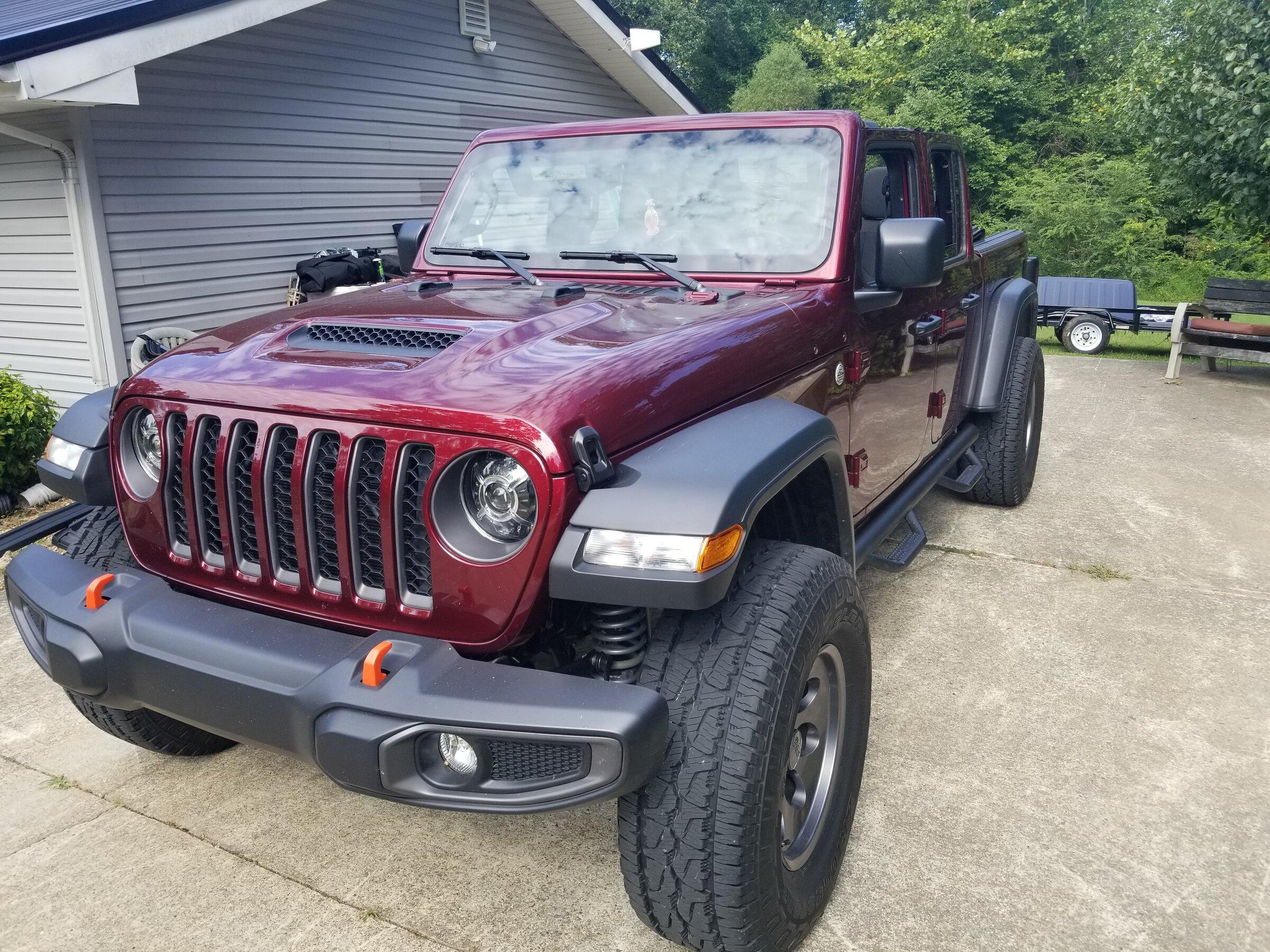

These are the Quadratec Baja Extreme 4.75in backspace (-6 offset) with 315/70-17 tires. Sticks out about 1.5" and slings stuff everywhere
Jeep Gladiator Mojave - Method 701s 20210829_095521
Thank you for the pic and info!
That’s what I’m trying to avoid lol. Unfortunately within a month of owning my JT I got a gnarly chip on the lower rear hinge. That eventually led me to getting RokBlokz.

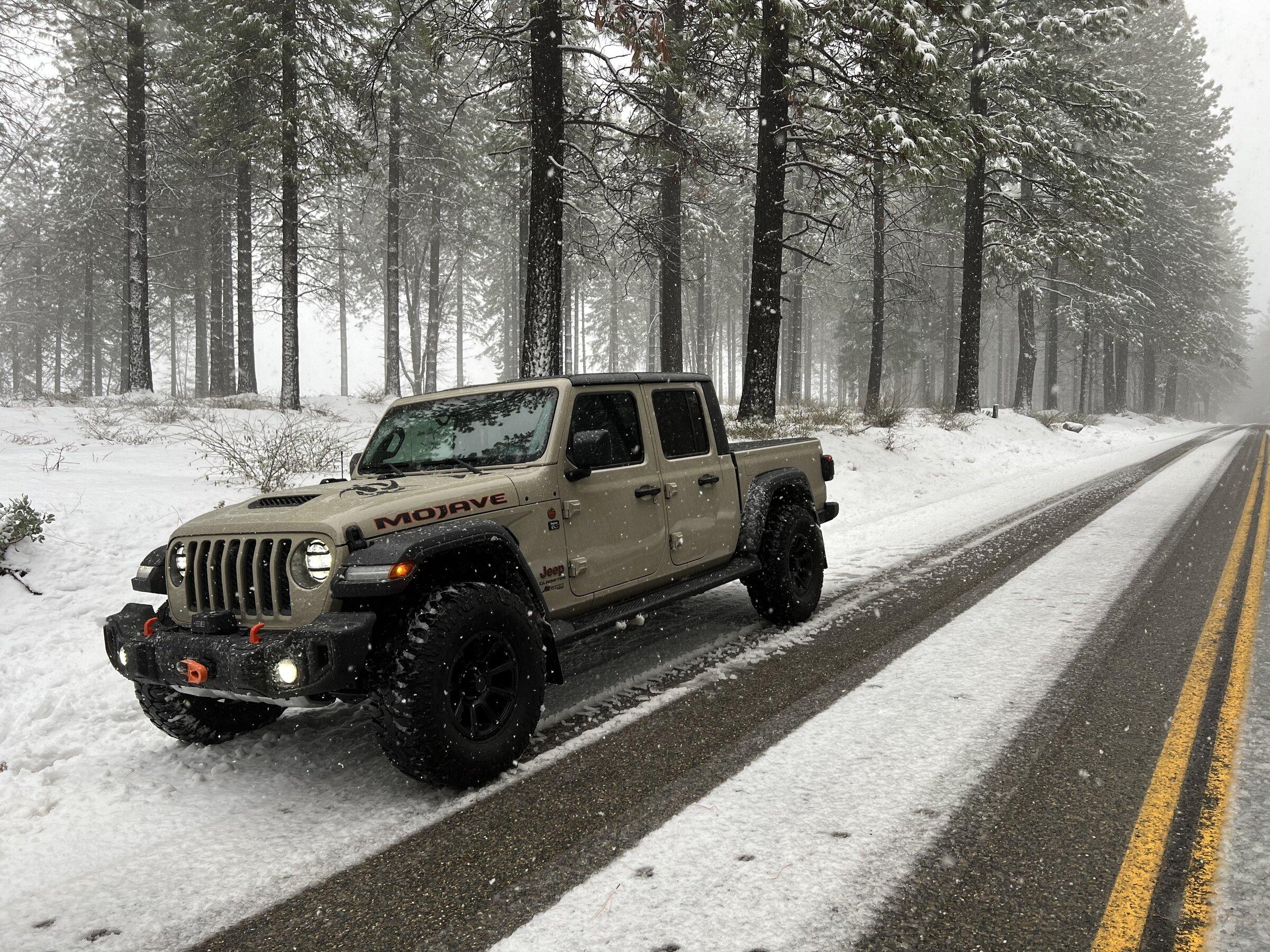

Method 703 with 4.75 backspace. With 37s, but also 12.5” wide.

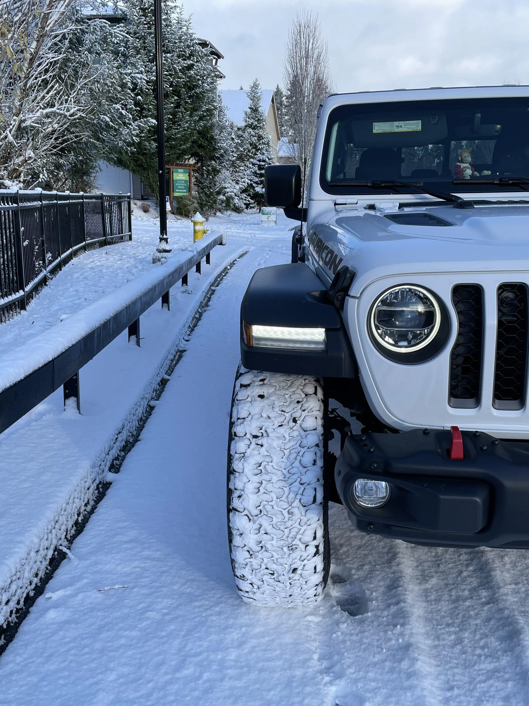

I'd stick to a higher offset.
I run +36 and still get a little bit of the tire outside of the fender.

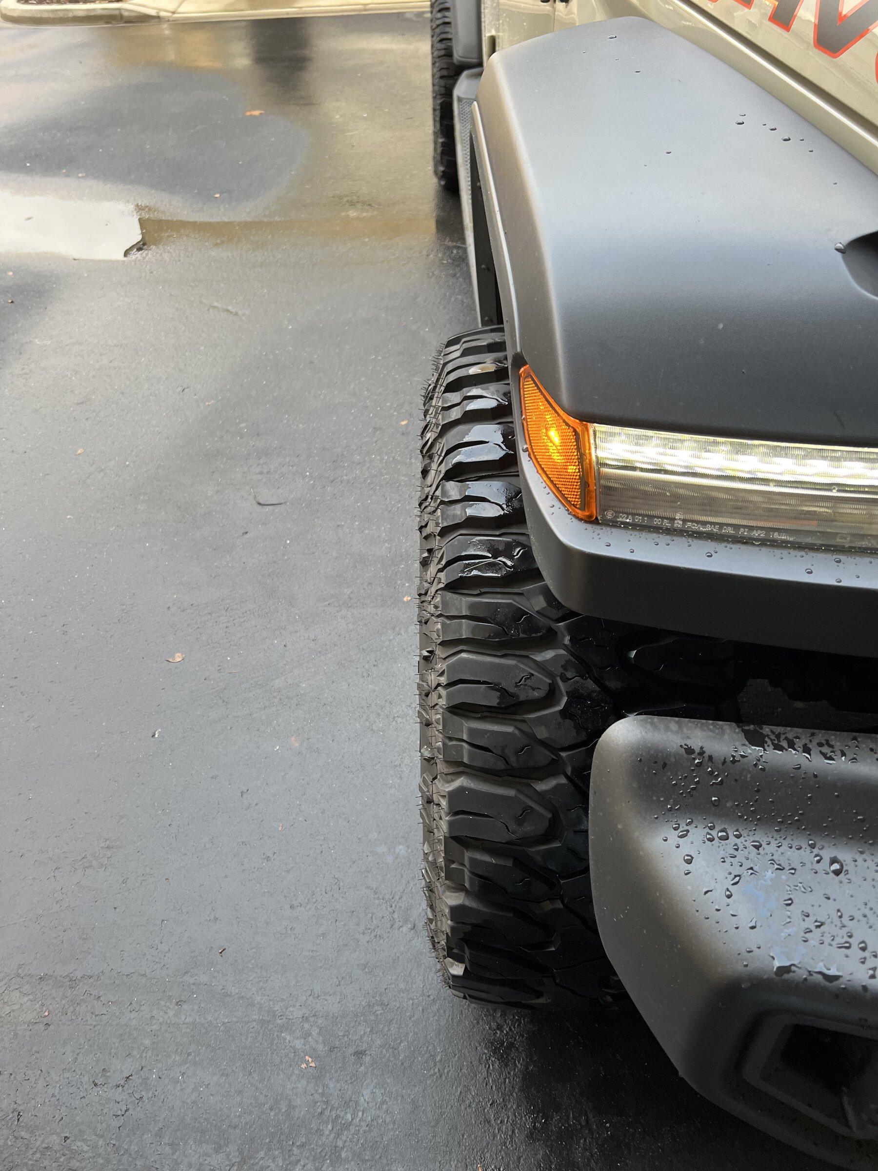

I have 701. They stick out a good deal with narrow axles and after market fenders. 17x9.
Hey I’m all about the look but Snazz is as bad as black…. Shows absolutely everything lol. My JK was billet metallic silver and was pretty forgiving.
What offset did you go with? The 12.50 doesn’t bother me too much, I just don’t want extreme poke.
