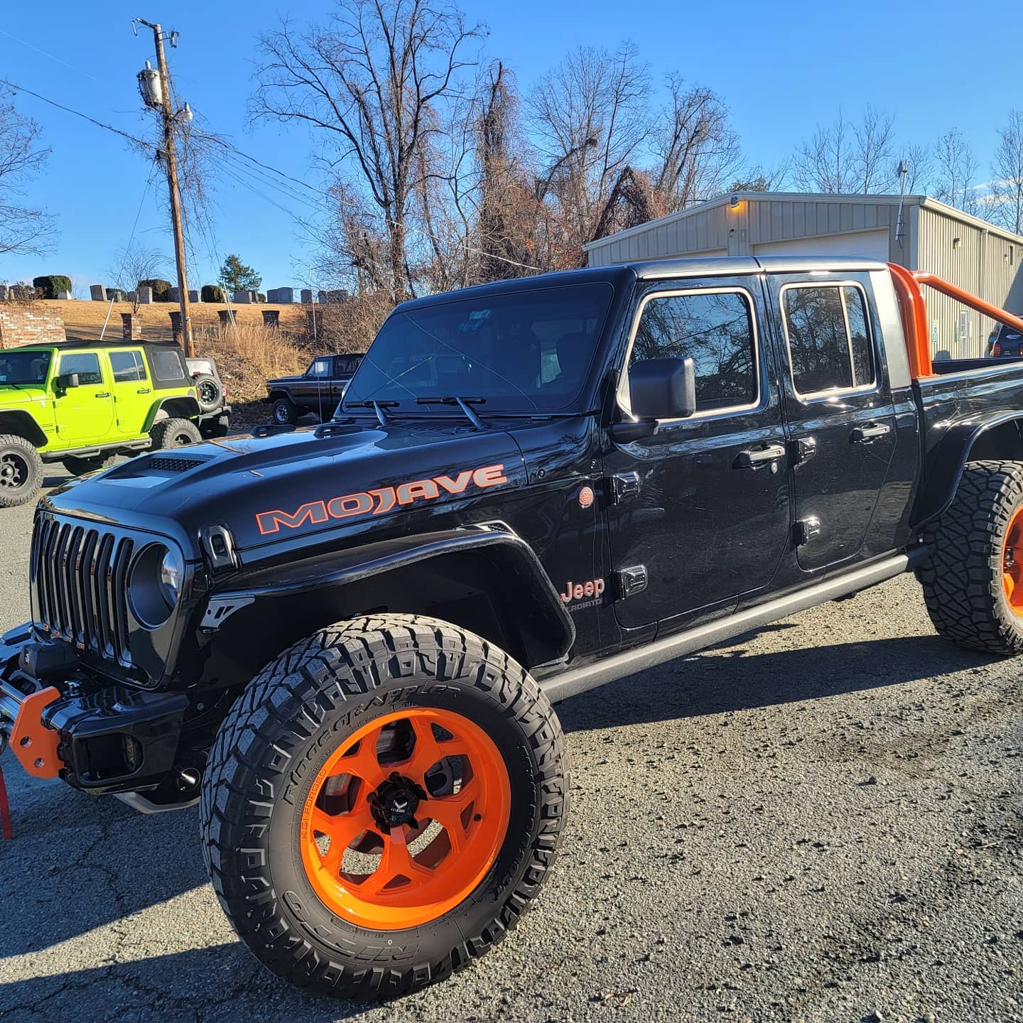

itsdapk
Peak Sponsor (Level 2)
PK
Feb 20, 2020
296
425
Forked River,NJ
www.hamburgerssuperchargers.com
2021 Mojave , 2019 Ram
Sales Manager @ Hamburger's Superchargers
gr82bagn
Feb 9, 2018
North Bergen
2016 Challenger 392 Shaker
Looks great! Looks like plenty of clearance for those of us not doing any rock crawling. Any rubbing at full turn? Stock gears?
itsdapk
PK
Feb 20, 2020
296
425
Forked River,NJ
No rubbing at all even over high speed bumps. Y
I have 5.13s and a Hamburger's Supercharger.

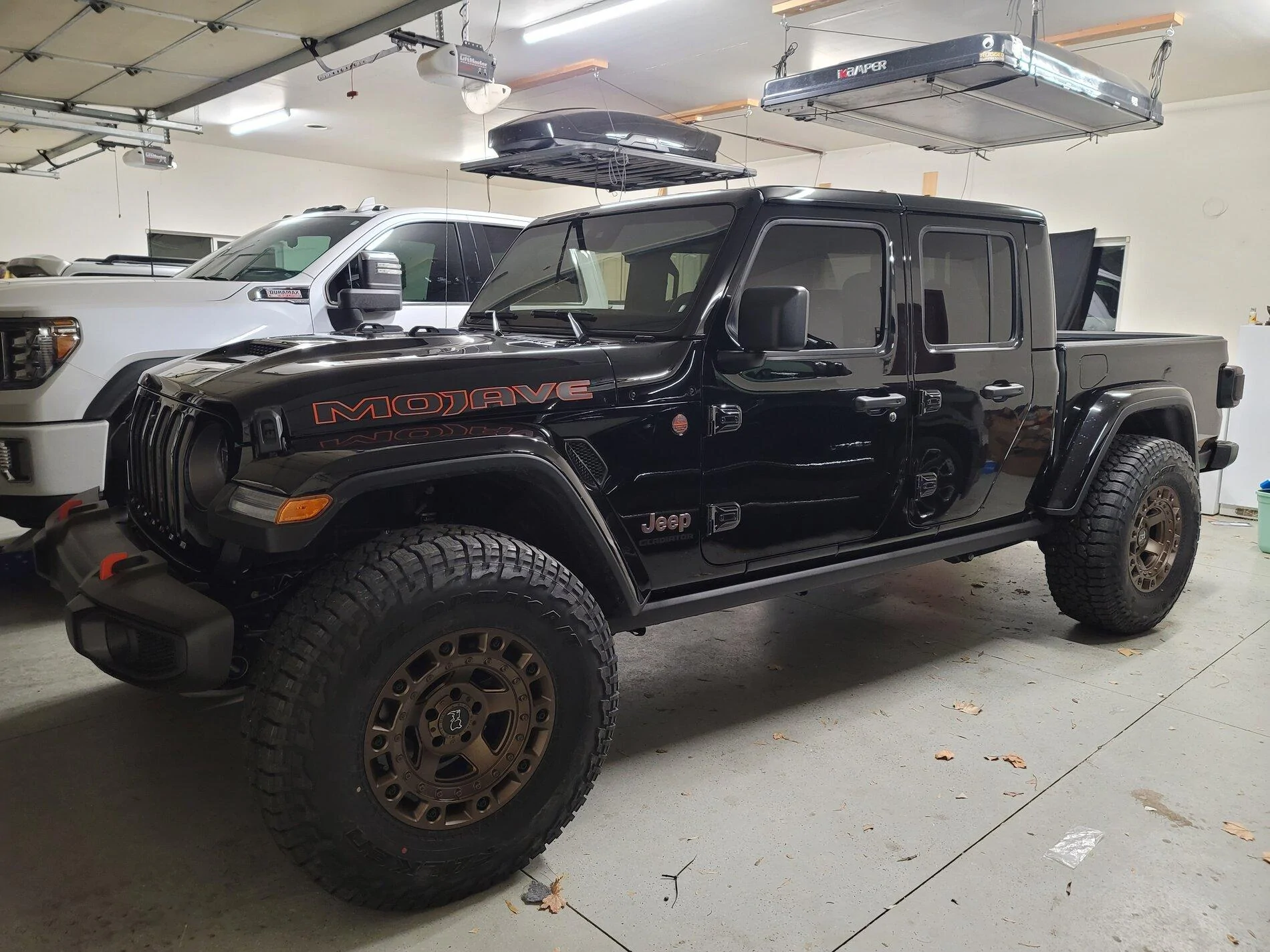

JBRLLC
James
Jan 4, 2021
44
IDAHO
2021 Gladiator Mojave, 2020 GMC 3500 Denali
Deal Architect/ Land Guy
37s are no problem. I've tried hard to make them rub and haven't been able to yet. These are 12.5 wide and -18 wheel offset.

Looks great I am looking. Black rhinos -18 and 37 ridge grapplers. What size wheels are those 17x9? Also can you put up some pictures looking at on high see how much poke there is. Thanks.
