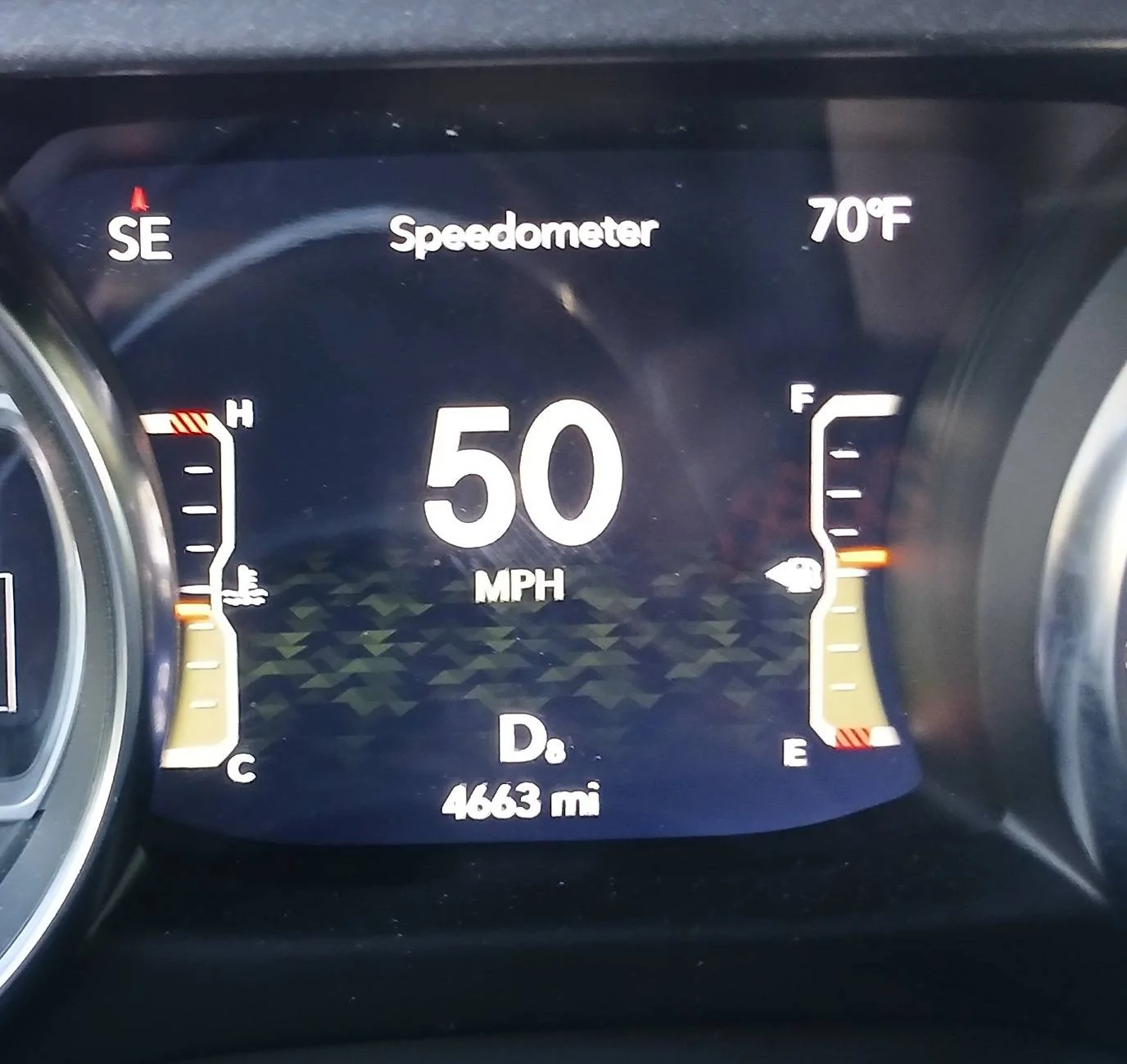

My stock (drive train, tries) ’23 JTM hits 8th on surface streets at 50-55 mph. No problem whatever holding 8th at freeway speeds. Just went through 60 mph Santa Ana’s here, no problem.
