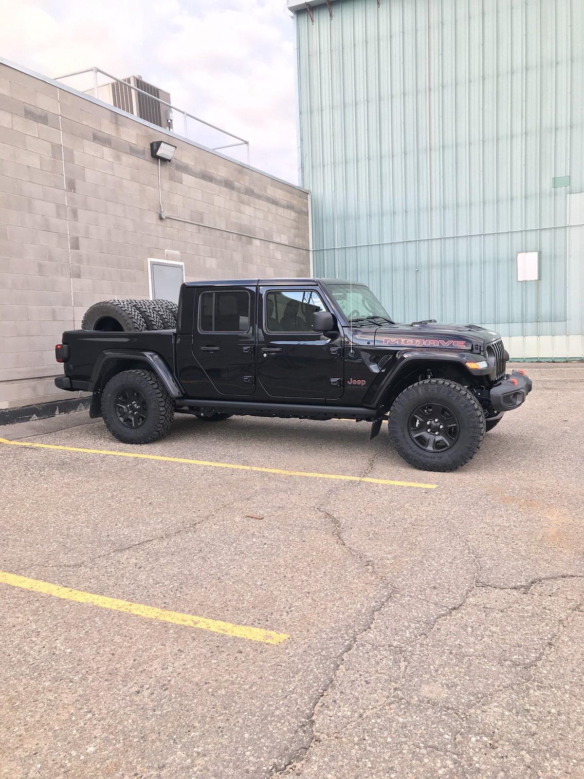

Has anyone put air bags in the Mojave rear springs, I have had a Jk, JL and trucks that I put them in and they all worked great for hauling different loads like quads etc. Airlift says all JTs but are the Mojave spring longer? Even with 300 pounds in the back it sags a bit. 35” 315/70R17 if you’re wondering
Not trying to side track this thread but what mud flaps are you running?
They look great.
I run Air Lift air bags in my F-350 for carrying heavier loads and they work great. It allows me to have a normal ride when empty. We took our truck with the Hallmark Expedition camper on it to Alaska this summer and ran the Haul road to Deadhorse which is a 500 mile each way gravel road as well as a bunch of other gravel roads, some of which were pretty rough and the air bags worked remarkably well.
