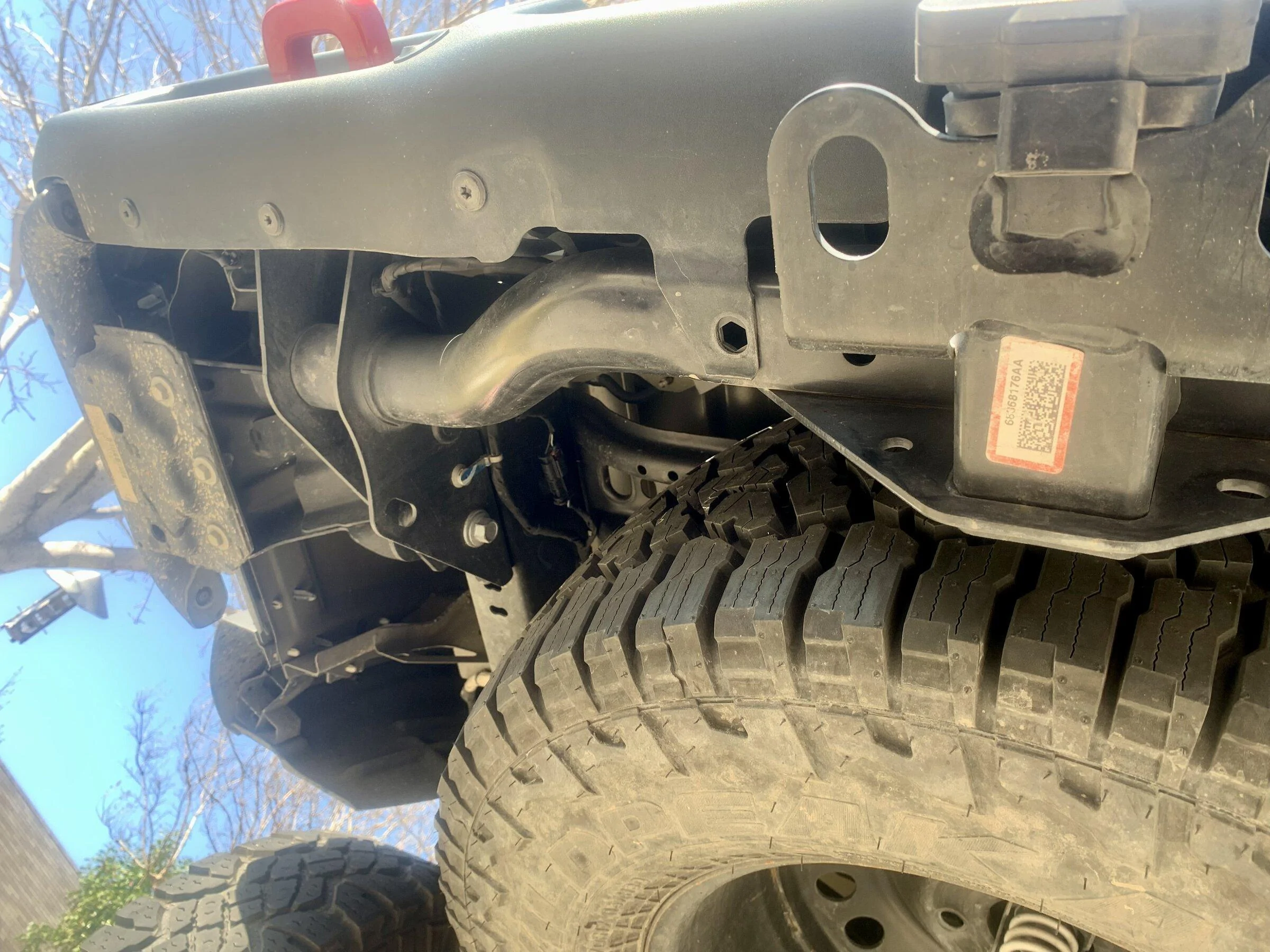

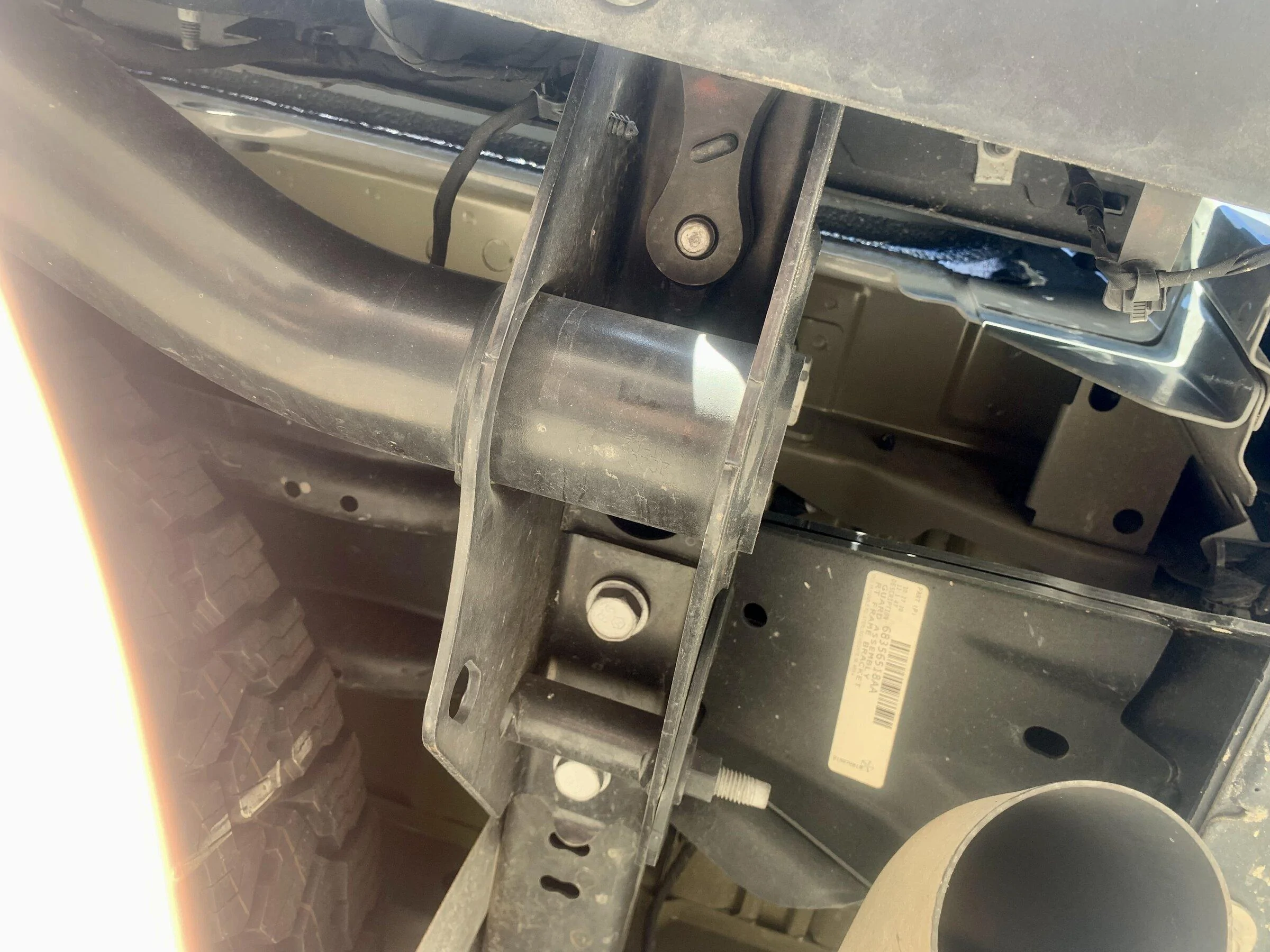

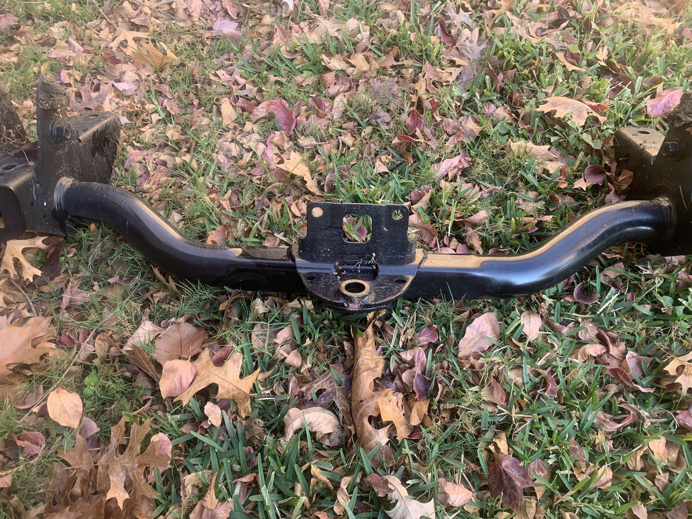

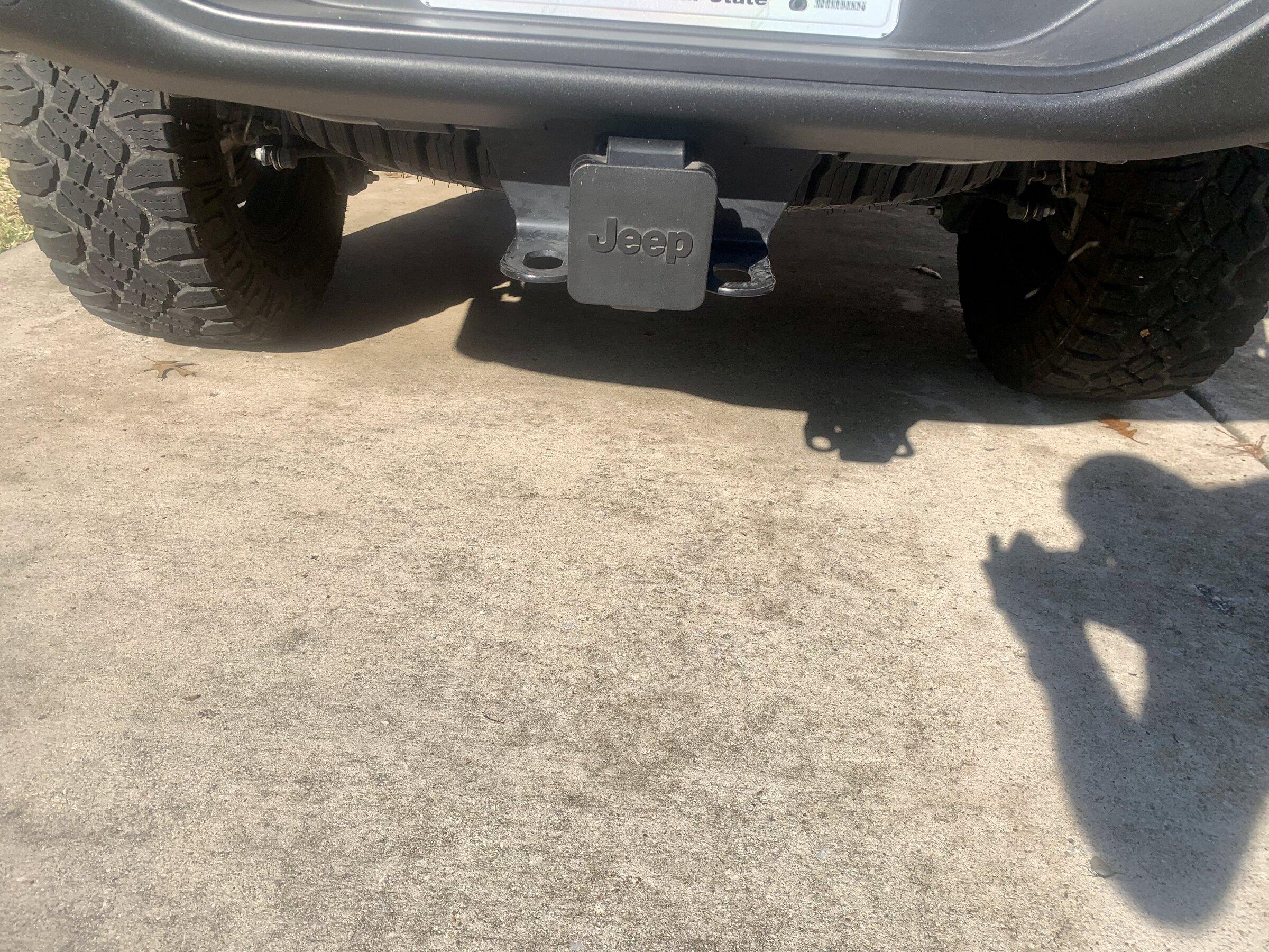

Here are photos of what comes on all non-tow package JTā€™s and what comes with the tow package.
You can see where it bolts to the frame.
Non-tow package for screw in type ball.

Tow package hitch photos:
Jeep Gladiator Mojave tow rating without tow package 72958624-EB3E-43BA-AED0-33EB2498A77E
Jeep Gladiator Mojave tow rating without tow package D00838F0-A5BE-4B02-A101-71912AB4C740
Jeep Gladiator Mojave tow rating without tow package 30443DCA-CB29-4BF4-8E75-071E9A64462D
180
29,549
35,148
