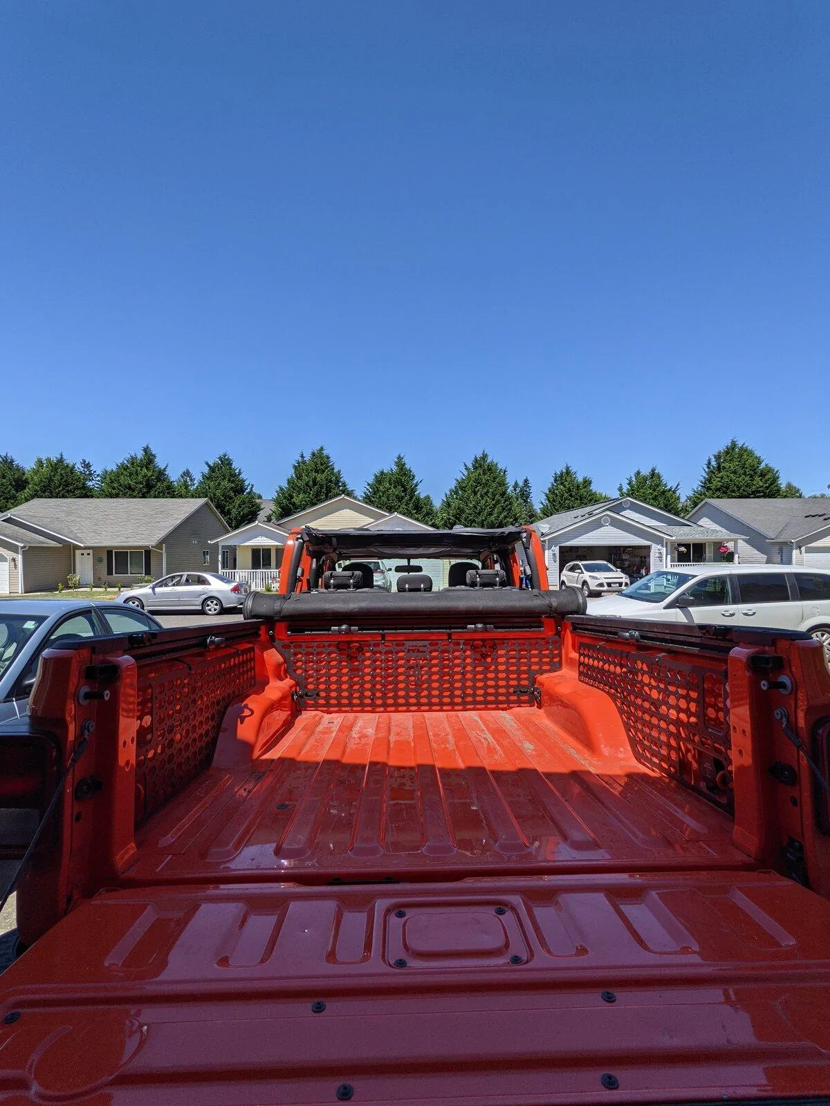

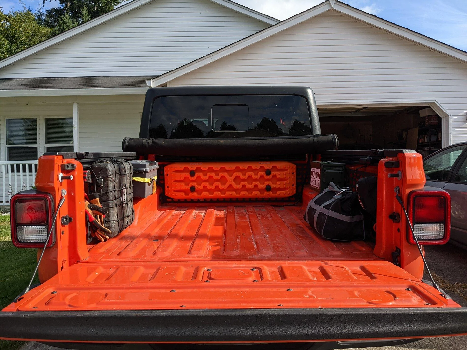

I just installed the RC molle panels today. I have not yet drilled and installed the rivnuts for the lower brackets on the side panel, Amazon been slow to deliver the rivnut tool.
The rivnuts are definitely required. When I closed the tailgate I heard them rattle quite a bit.
The front panel mounts nicely without any drilling, quite happy with it.
After I get the sides fully mounted I'll be organizing my gear on them. And expect to really like them.

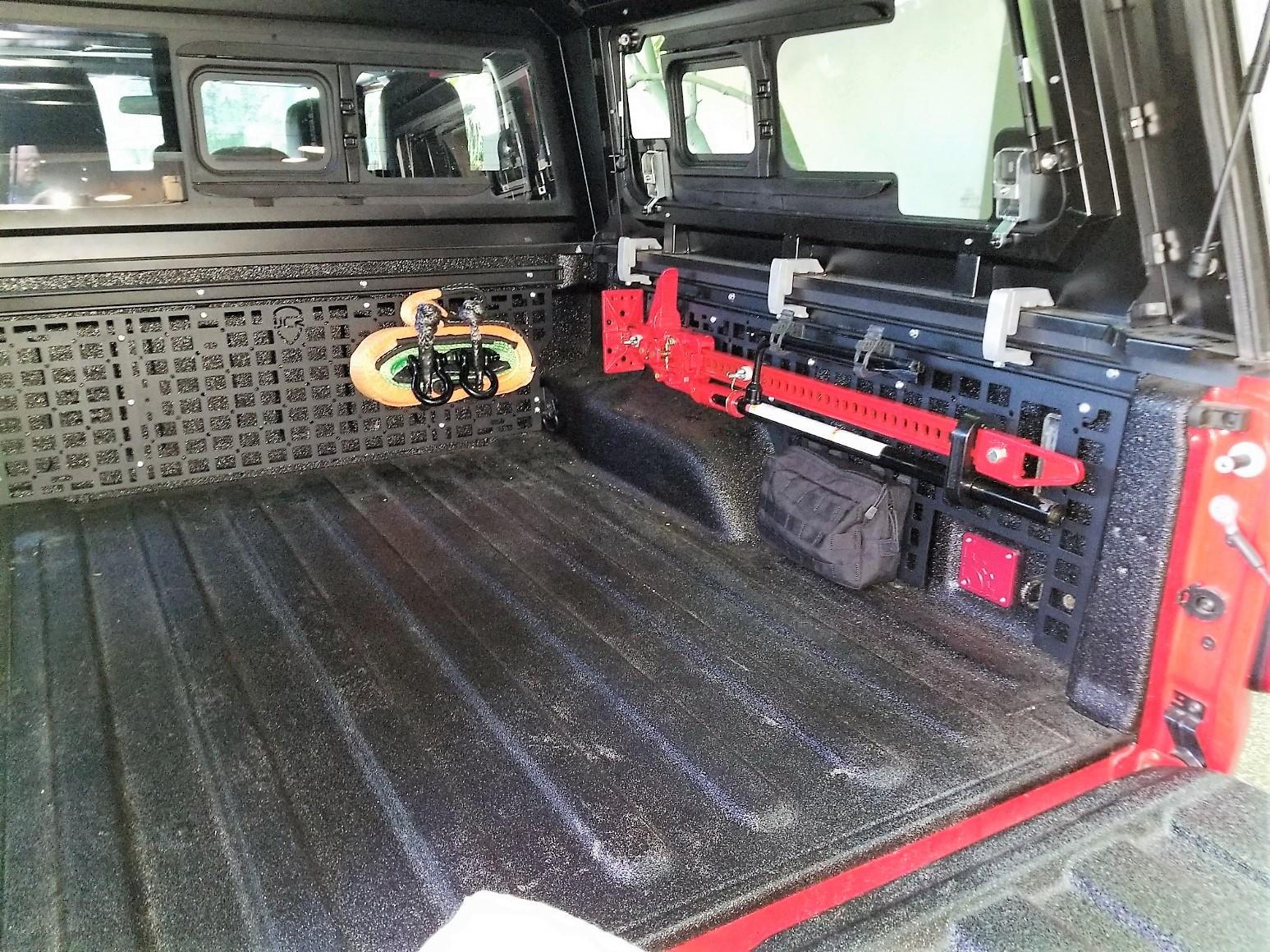

I've had the JCR Offroad panels for about 9 months now and really like them. They install in the factory cargo rail holes so no drilling, if you have the cargo rail installed the brackets sit between the cargo rail and the bed, in my case I have the BuiltRight rails but it would work the same with the factory rails. They are a little tricky to get nuts behind the mounts without taking the panels off but it can be done, just need a bit of patience.
Super solid, they don't have a lower mount on the side panels, just a standoff bracket with some rubber on it but I don't seem to have any issues and there is a lot of weight on the side panels.

Happy to take any measurements or provide specifics on the JCR panels if that would be helpful to anyone. I don't have experience with any of the other panels but the BuiltRight panels look nice. The deciding factor for me was the fact that the JCR panels mount behind the cargo rail so they don't take up any space on the rail.
Initially I was going to get a bed rack and didn't want to have a panel mount where the bed rack mount would need to be. At the end of the day I ended up with a SmartCap so it wouldn't have mattered....

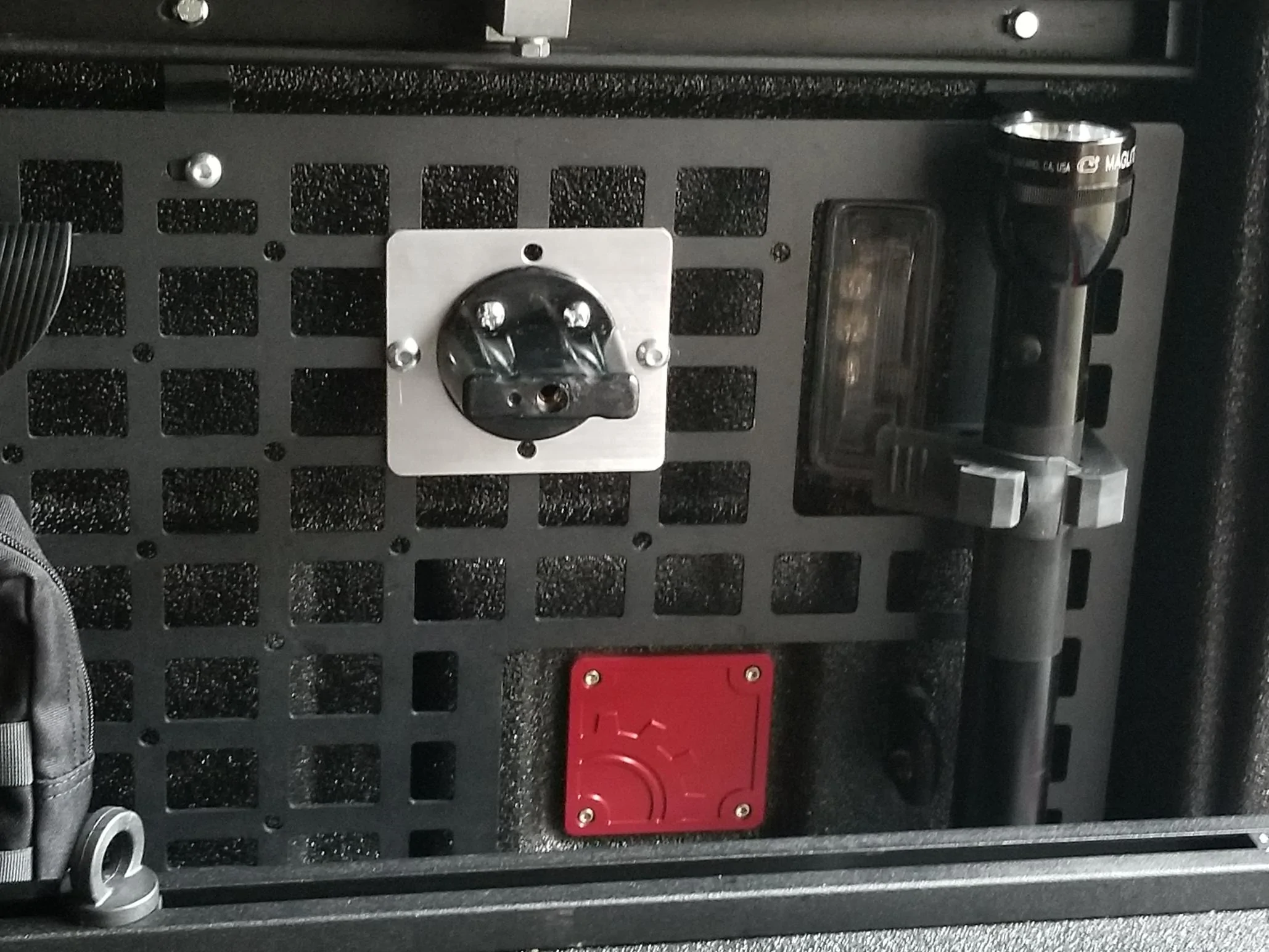

Bed drilled and now the panels are super secure. I started adding some gear and trying different arrangements. I put some rivnuts into a metal ammo can and bolted it directly to the panels, I really like this am am gonna pick up a few more.

I use various quickfist mounts for most of the gear I have on the panels. I also installed some nutserts into ammo cans and bolted them onto the panel to make some tool boxes.
I've been playing around with the Milwaukee packout system and a mounting plate but haven't found a setup I like with this.

A combination of a few different things, but like Animal mostly Quickfists. I have the Hi-Lift mounted using the JCR mount that comes with the MOLLE panels, fabbed up a quick mount bracket for the small gas can and I think the rest are Quickfists.
