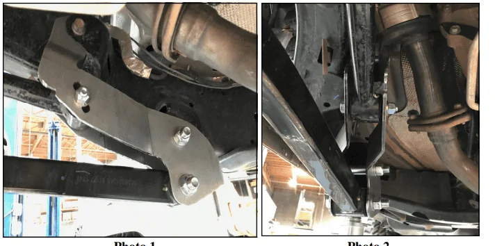

Build it right and skip the relocate bracket. Just becomes a weaker point of fail, in my opinion. The Mopar lift alone is great, the rake is not that bad. and if you tow anything the rake will help. Skip the brackets. If you have to put a level on it, look for another lift kit or buy adjustable control arms.
Jeep Gladiator Mopar 2” Lift Kit with Lower Control Arm Relocation Kit 1609328099944

Geeze that sticks down LOW, it's going to get damaged offroad. There's a reason I put skidplates on all those low hanging brackets from the FACTORY design!
Adjustable control arms is going to hang that low once you adjust it right, no different. If you know what your doing you want do any damage. I had them on my JKU and never damaged one.
Adjustable lower control arms sit exactly same place and height as stock. Just 1/4" or what ever you adjust to longer. And built like tanks!
