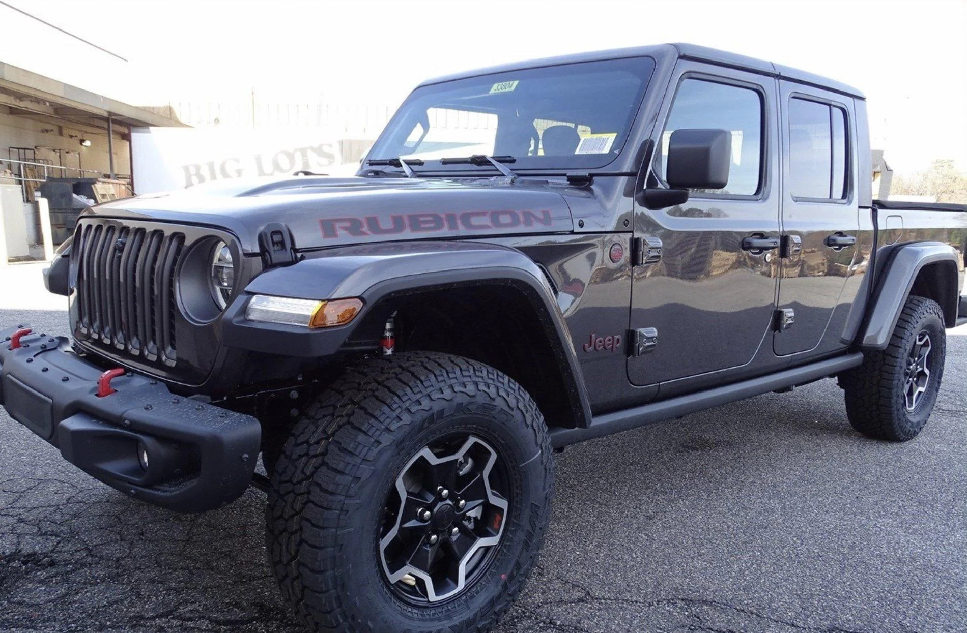

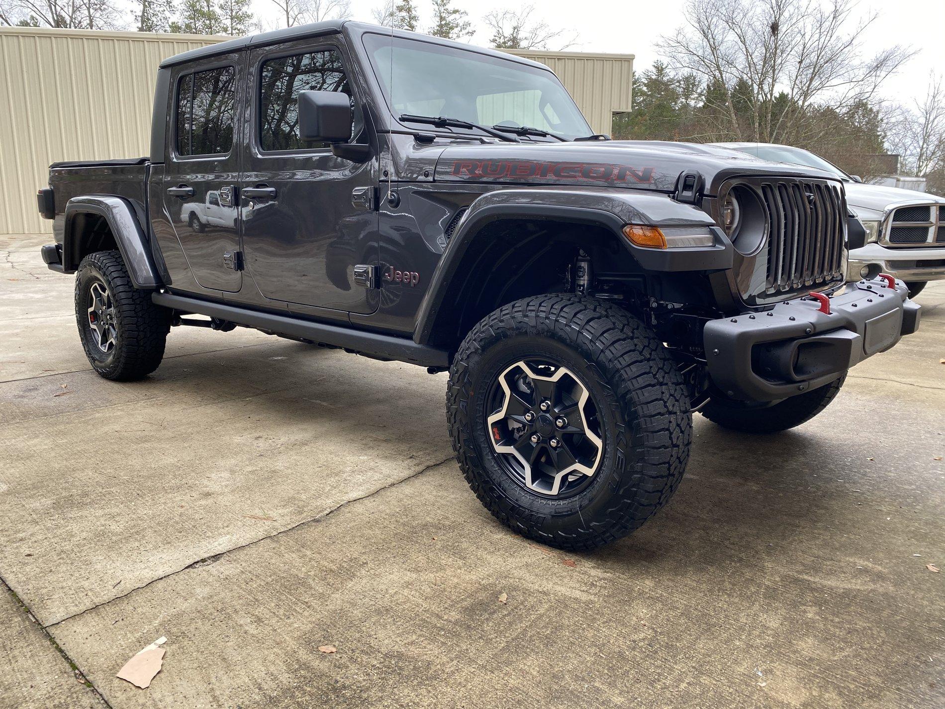

No, the shocks, Springs and control arms are different. Here is mine before and after on the same wheels:
