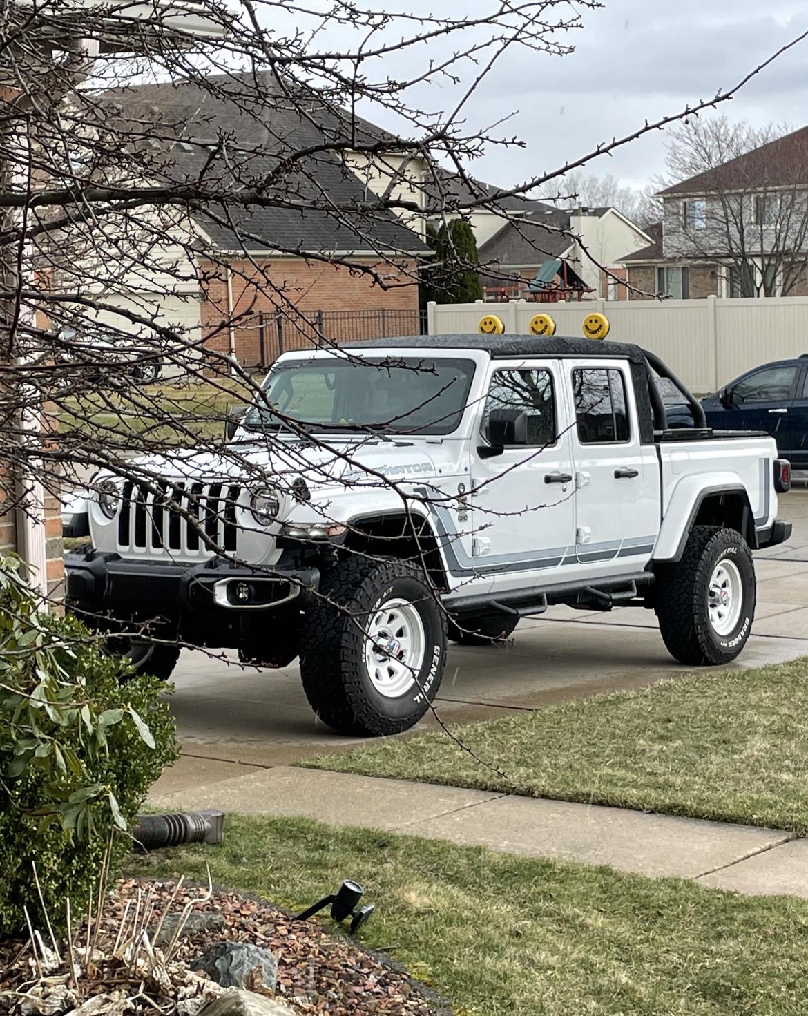

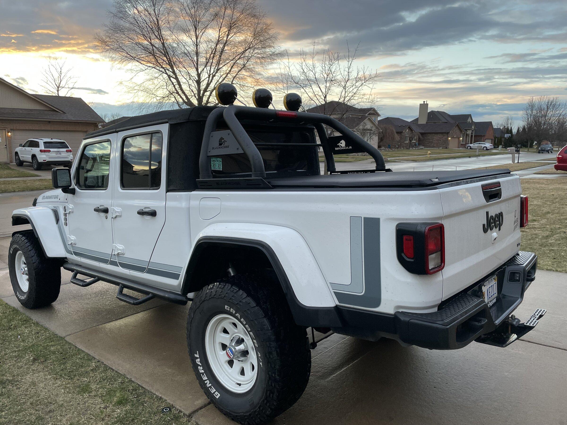

I got 3+ inches of lift on a Sport with the mopar 2" kit
Jeep Gladiator Mopar 2" lift Front view
Jeep Gladiator Mopar 2" lift Side View
