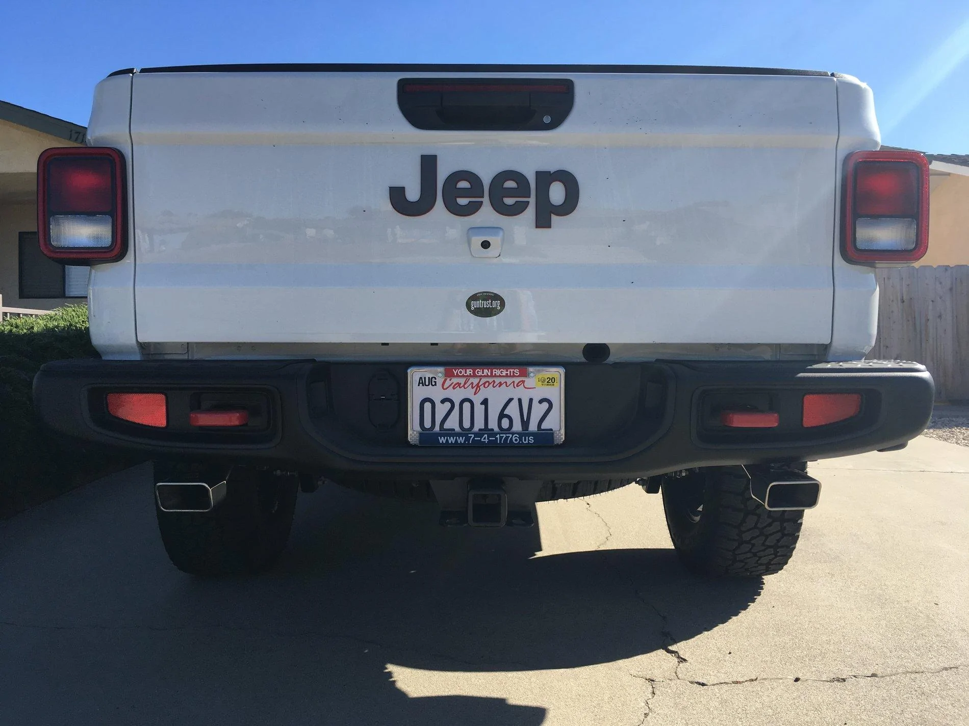

That looks to be the correct part number. Searching for it the best price I found was 1117.00 plus ship? Does anyone have anything better or even a picture of it?
Discount is great if you can install yourself. I paid full retail 1395 so dealer would give me half off labor (330 not 660). Plus i got 5% back on everything by using Jeep credit card.
Gladys Kardashian pic:
Could you take some pics of the exhaust under the truck? Are the rectangular tips part of the kit? The only option for this kit is a dual rear exit?

Besides the price, I can already see two problems with this exhaust—they are visible just below the rear bumper!
I like the dual square tips on that. Looks sharp.
