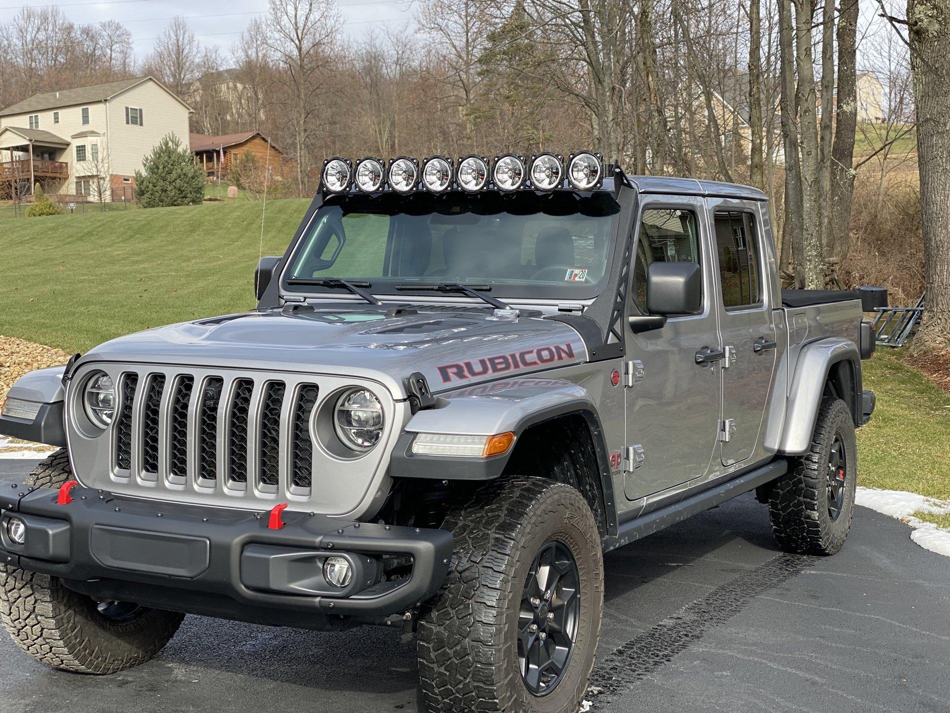

Just wondering if anybody has used the spray cans of the mopar color matched paint? I was thinking of painting the mount fishbone off-road a pillar mount for my lights to match the truck. Was wondering how well they matched and how well it would work on a black powder coated finish of the mount. Thanks
