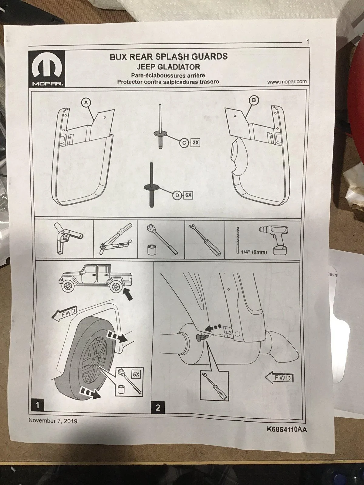

I bought the oem flaps when I picked my truck up. There yrear ones were wrong had to wait till beginning of April to get the Max Tow flaps. Can’t find the part no right now but this is the instruction sheet.

The Mopar part no for max tow fenders is 82216377A. Like I posted I had bought the flaps from the dealer for like $74.00. But the tears where wrong. The right one are the above part no.

Sorry no is 82216377AA don’t know if you need the other A . I have factory running boards and the front fit rather well

Oh, is this the part number for ALL 4 splashguards, or just the rear?
From the instructions you posted, do you REALLY need to remove the wheels?

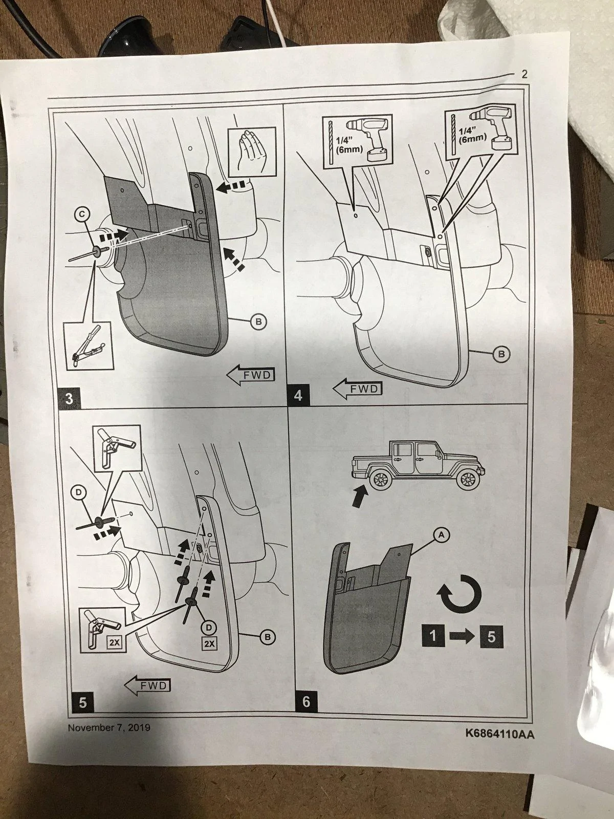

Rear only. The front are probably the same that you had on Amazon. I didn’t remove the rear tires, but the only reason I didn’t was I have a right angle attachment and a 1/4” hex drive bit. The directions are remove push pin from inner fender, then rivet flap in place, the rough part was drilling in the plastic edge. Watch that the drill doesn’t wander. Push rivet in place then check for straight, then drill second hole. The only mistake I made was doing the drivers side first. I recommend the passenger side first, if it is a little crooked you will know what you did wrong before the drivers side. My one one the drivers side is about a 1/8” off. Most wont notice the mistake, especially at 55 mph. The right angle bit is for the inner most hole in the flap to plastic wheel liner.
