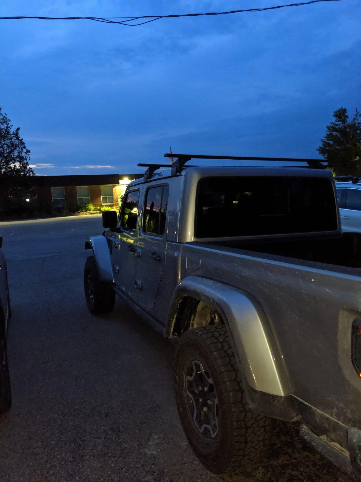

Hi all. Just got the Mopar gladiator roof rack/cross bars. Gonna install them tomorrow. Anyone got any comments/hints/tips/ problems?

Yeah... I got ya on the freedom panel thing. They are pretty obvious about how they shouldn't go on there... Sometimes though for a short trip with my canoe at low speeds I would consider it. Anyway, couldn't wait and installed them tonight. The flat screwdriver locker plastic items for the cover plate are kinda weak and won't be surprised if I end up looking for
replacements for those. 3 outta 4 went back in fine and 1 needed to be turned around and around until it gripped, although not at the suggested angle.
Be careful with those when putting the cover plate back on.

And also,look out for the rubber seals at the door/ roof points for pinching when installing.

For locks instead of the flimsy plastic piece I used the
Yakima - SKS Lock Cores Car Rack System Components.
They worked great

I believe Yakima lock cylinders fit the rack, I had one on my JLUR and that was a planned upgrade but traded it before I got around to it. If it whistles, you can cover the seam along the bottom of the bars with gorilla tape or vinyl and it should cure it.
You read my mind...the whistle is definitely there. I'll look later for the seam you mentioned. Thanks.
Will totally look for those lock cylinders too.

Yup, there's a long thread on the JL wrangler forums (sister site) that details all of that stuff, but those were the two main things. It's a nice rack and I got good use of it on my JLUR. The whistle was disappointing for a factory rack, but luckily not too difficult to fix.
