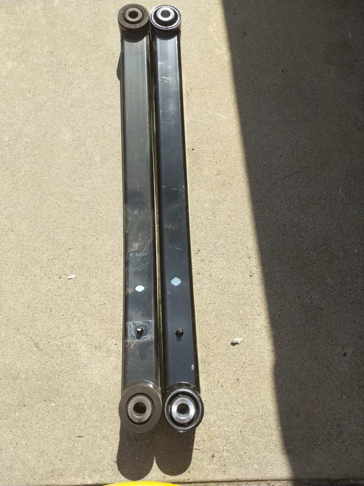

The LCA's in the kit are .25" longer than the factory arms. You REALLY want them until you get the adjustable LCA's.
You can see the offset in the eye position.
I'm running the longer arms on my JTR as a cheap fix for too little caster, with no lift yet. Works well for $60.

Jeep Gladiator Mopar lift lower control arms IMG_20200726_095102
Yes I can definitely see it now. Thank you for posting that!

You should have been able to tell they are different lengths by putting a bolt through one end of each and not being able to do it on the other end. They may not be that much longer but when you're dealing with 1* increments it matters.

Seems like a very small difference, I have used Rancho geometry correction brackets in the past and they would seem to make more than a .25” change, definitely make a big difference in driving feel even with just 2” of lift.

Long story short, we took the Mopar lift off of my friend’s Gladiator and then put on Rubi take-offs. While doing so we compared the Rubi take-offs control arms to the Mopar control arms but couldn’t really see a difference so we left the Mopar lift arms on. Butttt now after reading what you all have written/showed we have to remove and replace.
A .25" change is about 2 degrees of caster movement. That's not insignificant.
Also, geometry correction brackets drop the control arm mounting point requiring more adjustment for the same degree of correction.
