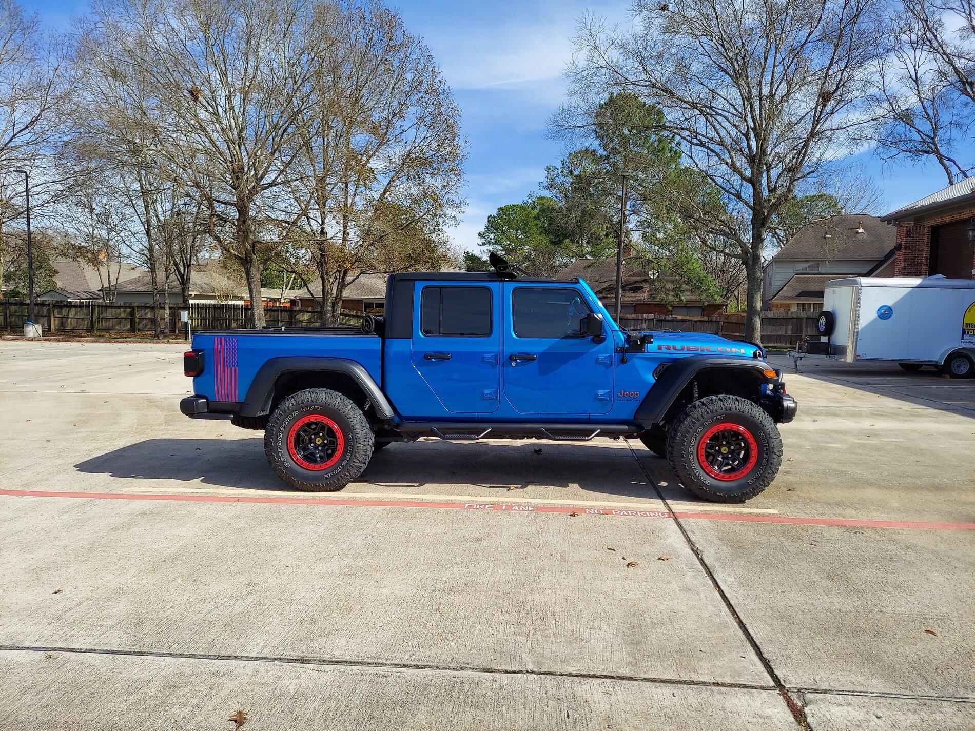

I'm running the 2" Mopar with 1.5" pucks in the front with 3" bump stops, RockKrawler adjustable front trackbar, Falcon 2.2 SS and Rancho drop brackets. The rear is the lift springs, bump stops and RockKrawler relocation bracket . Camber is a little higher than I would like (6.8) but it tracks absolutely straight and the ride is phenomenal. The only thing I might do is get some adjustable upper fronts to pull the camber in a little.
