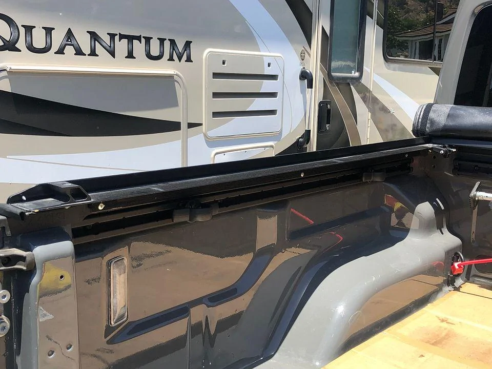

Just received and installed Mopar bed rails. They conflict with the tonneau clamps - WTF?
I ended up using 3/4" self drilling screws to keep the tonneau - but I'm NOT happy about that. UGH!
The tonneau sides with shiny self-driller heads showing Hate 'em

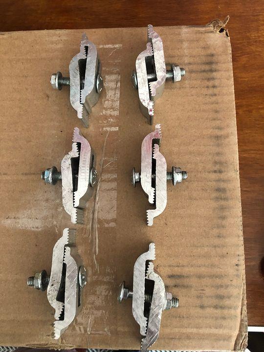

The clamps that held the tonneau sides. Yeah, kinda big but at least no holes in the bed.

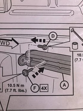

ANOTHER ISSUE: MOPAR provides 12 bolts to attach rails to factory threaded holes. There is one more hole on the rear of each rail. They provide T nuts to hammer into pre-drilled holes but they DON'T provide the 2 bolts! Again, WTF?
For over $300 such penny ante saving, 2 frickin' metric bolts and they don't design to allow use of both the rails and their own tonneau attachment method?
The instructions show "D" as both a hex head and as a Torx head bolt. They say "12x" provided, so they know they're not giving you enough. Chintzy bastards!

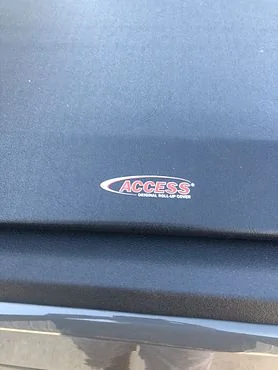

If the tonneau cover doesn't say Mopar at the back left (US driver's side) corner, then it's aftermarket.

That's definitely an aftermarket tonneau. I have the mopar/factory tonneau, and it is substantially different than that one.
So yes, someone bought the truck and decided to add an aftermarket tonneau. There are lots of reasons someone might do that - price, preference, truck on the lot was marked down and didn't have a tonneau, etc.
Edit: And I suspect you have a literider. They're a little cheaper than the factory option, and some folks prefer them regardless of price as they tend to work better with bed rack systems.

Thanks for the clarification you guys. I went back to look and it says "Access Original Roll-Up Cover" so it is this Literider brand.
The clamps they provided don't look like the ones on the website you linked but close enough. I guess using the self drilling screws was all I could do unless I custom modified the clamps the provided or found something else.
