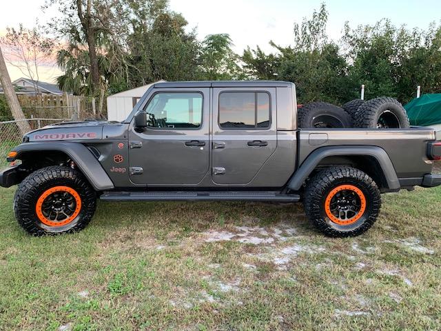

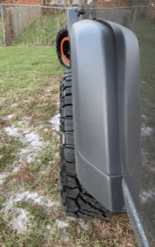

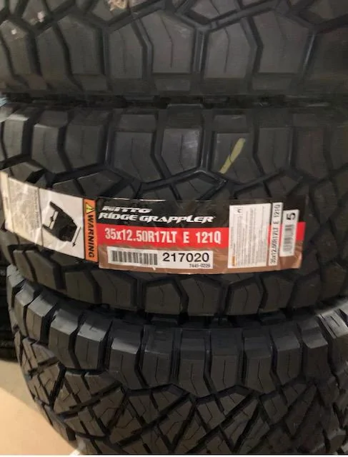

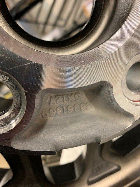

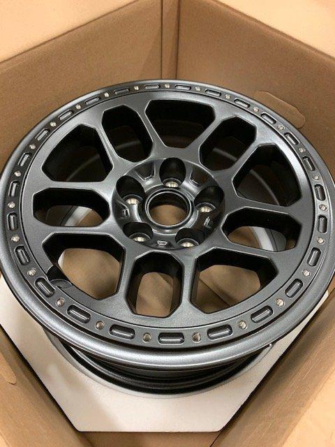

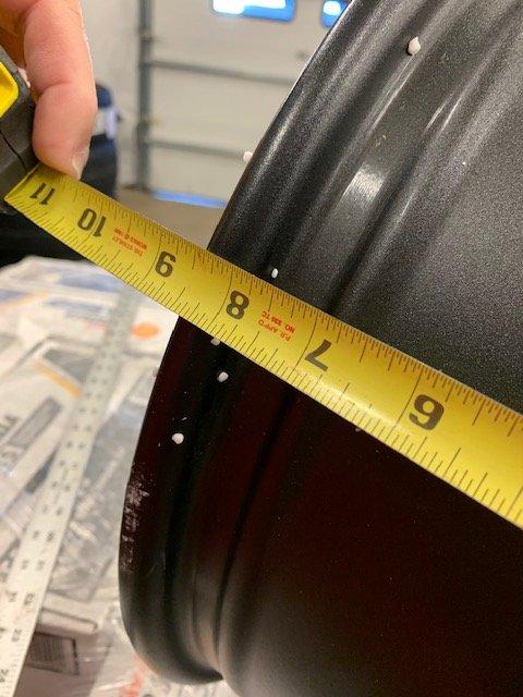

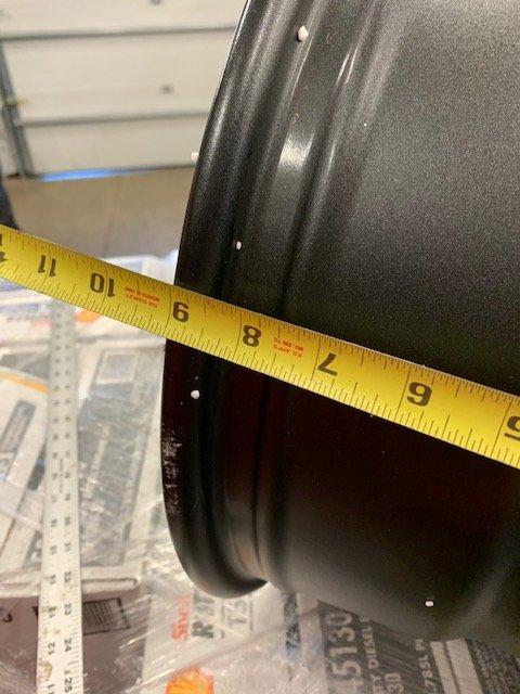

Wondering if anyone is running these 17x8 Mopar Beadlocks (as streetlocks, not with the actual beadlock ring) with 35x12.5s and no lift. The wheels are +12/4.4"BS, which will keep them mostly tucked, but still give a more negative stance (pushed out) compared to the stock JTR wheels (maybe 1/2"-1" total difference).

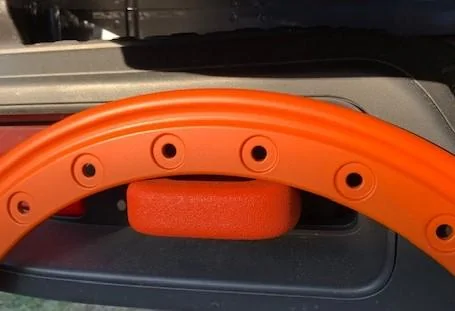

I've read/seen different setups, and I know 12.5s should be mounted on a wheel at least 8.5 wide. Not interested in running the true bead ring to get the Mopar wheel to 8.5 and don't plan on lifting above a TF 1.5" level.
Any rub issues on drag links/control arms at wheel lock for those running that setup?
