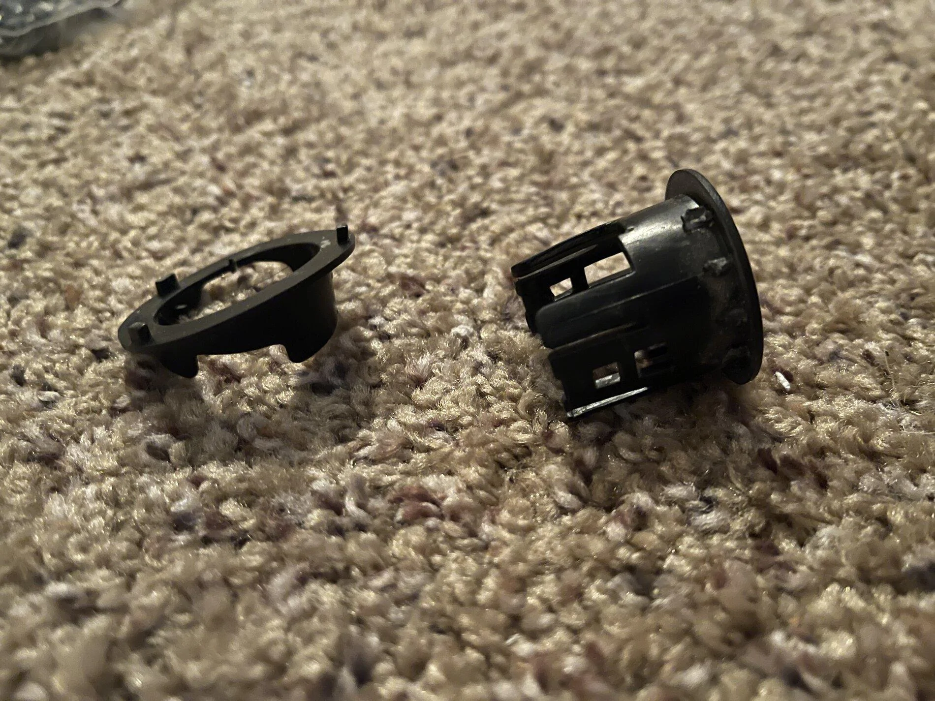

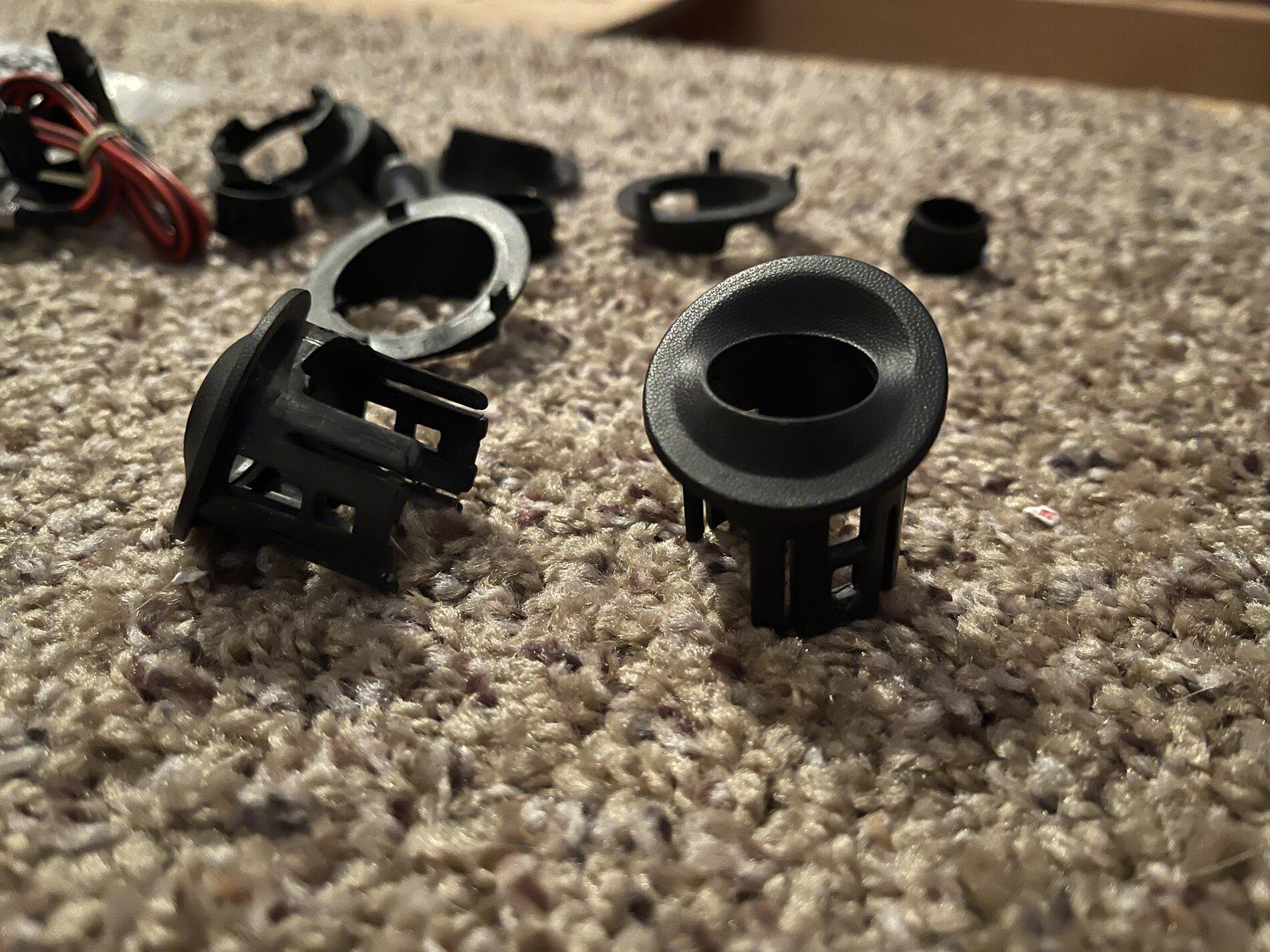

Ok. Someone HELP! I thought I had everything To mount these sensors to the steel bumper.
I have ordered these brackets that push through from the outside of the bumper.
The sensor clicks into this bracket from the back.
But I cannot find the piece that secures the bracket to the bumper from the back side. I saw a video on YouTube of someone replacing the sensors on a JL bumper. The piece looked like this...
I found that part on Quadratec. It’s made for the JL steel rear bumper. I CANNOT find the JT equivalent.
Someone that has done this, PLEASE HELP! I’m stuck!

Sorry, I don’t see a part number on them. This is what they look like though.

I ordered offvquadratec. It is the same
quadratec has them
