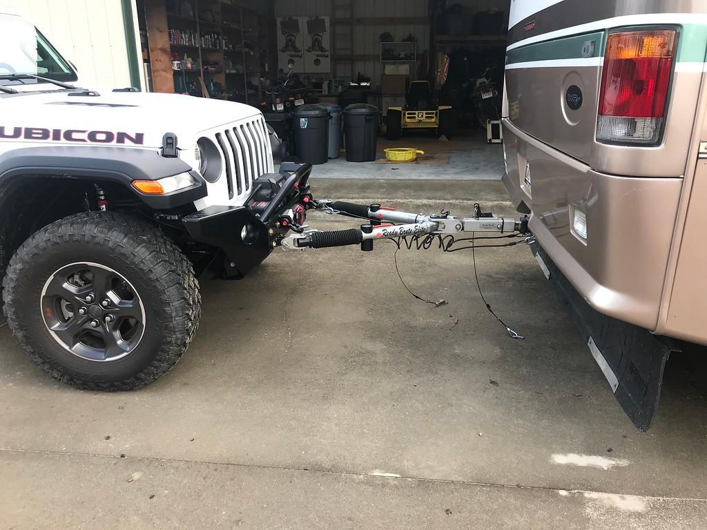

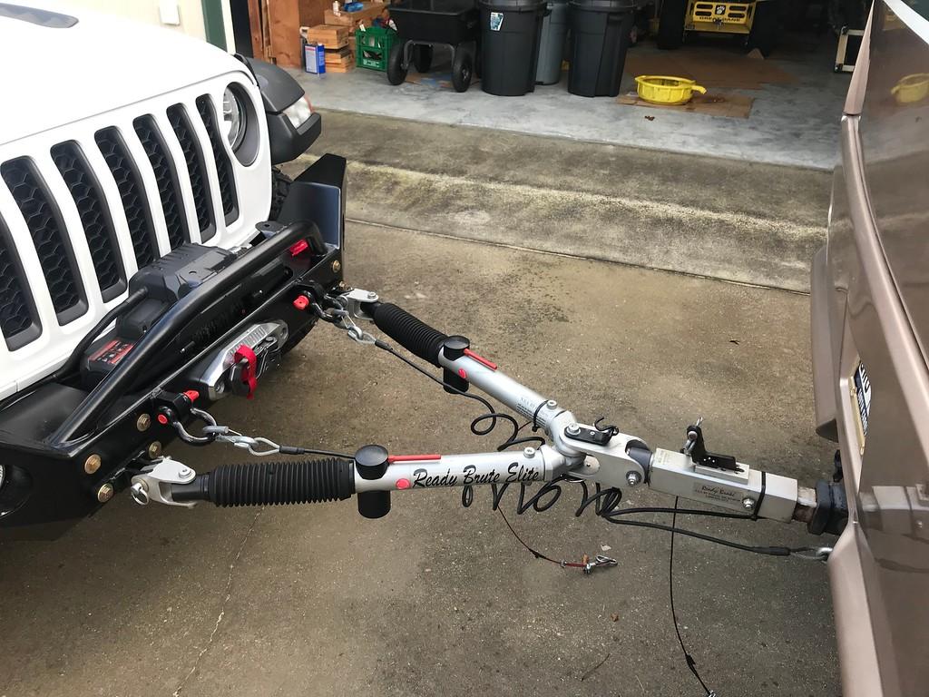

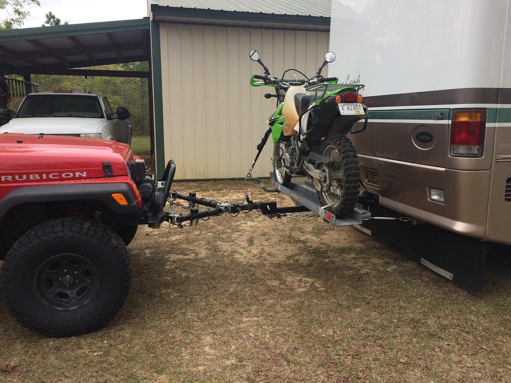

Not a Rugged Ridge guy, but I've been towing for several years. You need a tow bar, a way to connect the tow bar to the vehicle, a brake system, and lights. Putting this together is not cheap.
I use a Ready Brute Elite tow bar with surge brakes. I started with one of these because it was given to me. :) I have stuck with the Ready Brute tow bar because of the simplicity.
Manufacturer of the Ready Brute Elite tow bar and the Ready Brake
I connect to the front bumper via bolted on brackets. The brackets on my TJ were made by a friend. The brackets on my Gladiator were made by Rockhard and I ordered them when I ordered my Rockhard bumper. The impression I have from looking at the Rugged Ridge bumper is that if you use the d-ring mount to tow with, then you need somewhere to attach your safety cables.
I have a thread covering my bumper install:
Rockhard full width bumper install | Jeep Gladiator Forum - JeepGladiatorForum.com
Like I wrote earlier, the Ready Brute system uses surge brakes. The tow bar comes with a kit to run cables to the brake pedal. Install is fairly simple but you have to drill through the firewall. Regardless of the brake system you use, you need the stop and go braking system and a break-a-way (emergency) brake system.
I use wireless lights that are battery powered and have a magnetic base.
https://www.etrailer.com/Tow-Bar-Wiring/Pilot-Automotive/NV-5164.html
