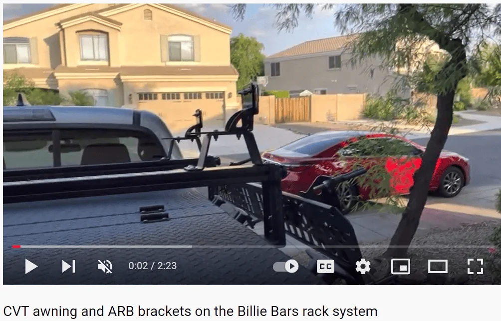

I would like to keep my RTT low on bars but have an awning up a little higher. There is a video on youtube showing your RTT brackets for that purpose, just wondering if anyone has seen a better solution. I have the Diamondback cover like in the video.

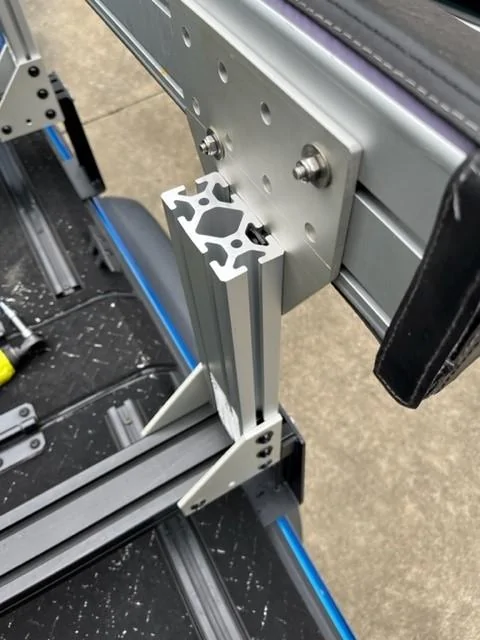

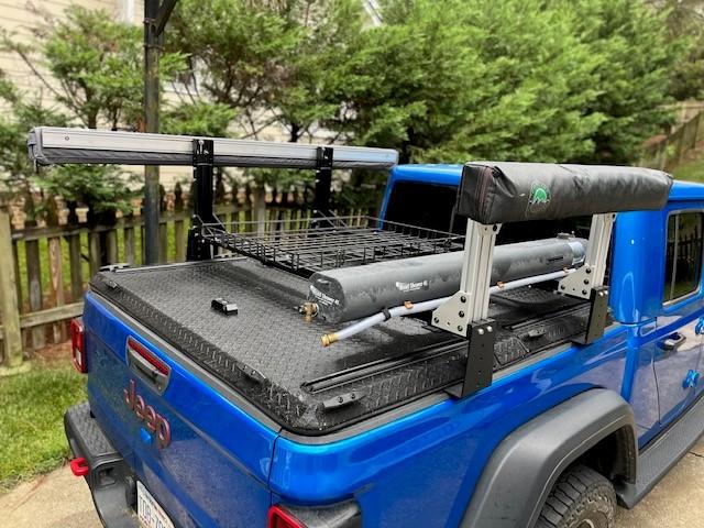

I went with a DIY set up with parts from Automation Direct as a comparison. Ended up spending about $170 on a 40x80 T-Slot setup for my shower. They cut to length and the shipping was relatively quick, 2 days. I will need to paint it in the future but ok for now.

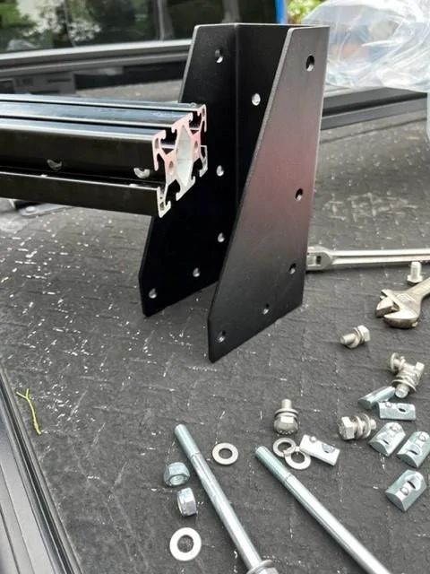

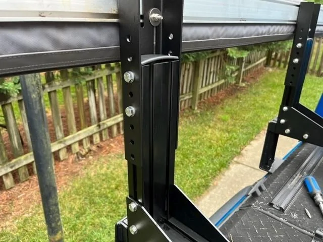

The BIllieBars were packaged nicely and the bracketry seemed well engineered. For the heavier awning, well worth the extra $130 over the DIY solution.
For the goals I started with, Diamondback cover, awnings on each side and maintaining visibility out the back window I like the set up.

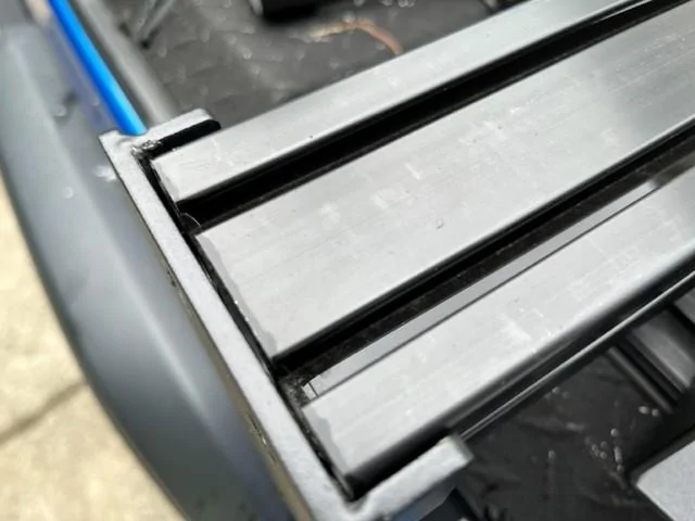

I REALLY wish the BillieBars had a weep hole for water, I'll probably drill some. Since the fasteners are not stainless (would not play well with the aluminum anyway) I expect it will cause a corrosion problem in the future for the nuts.
