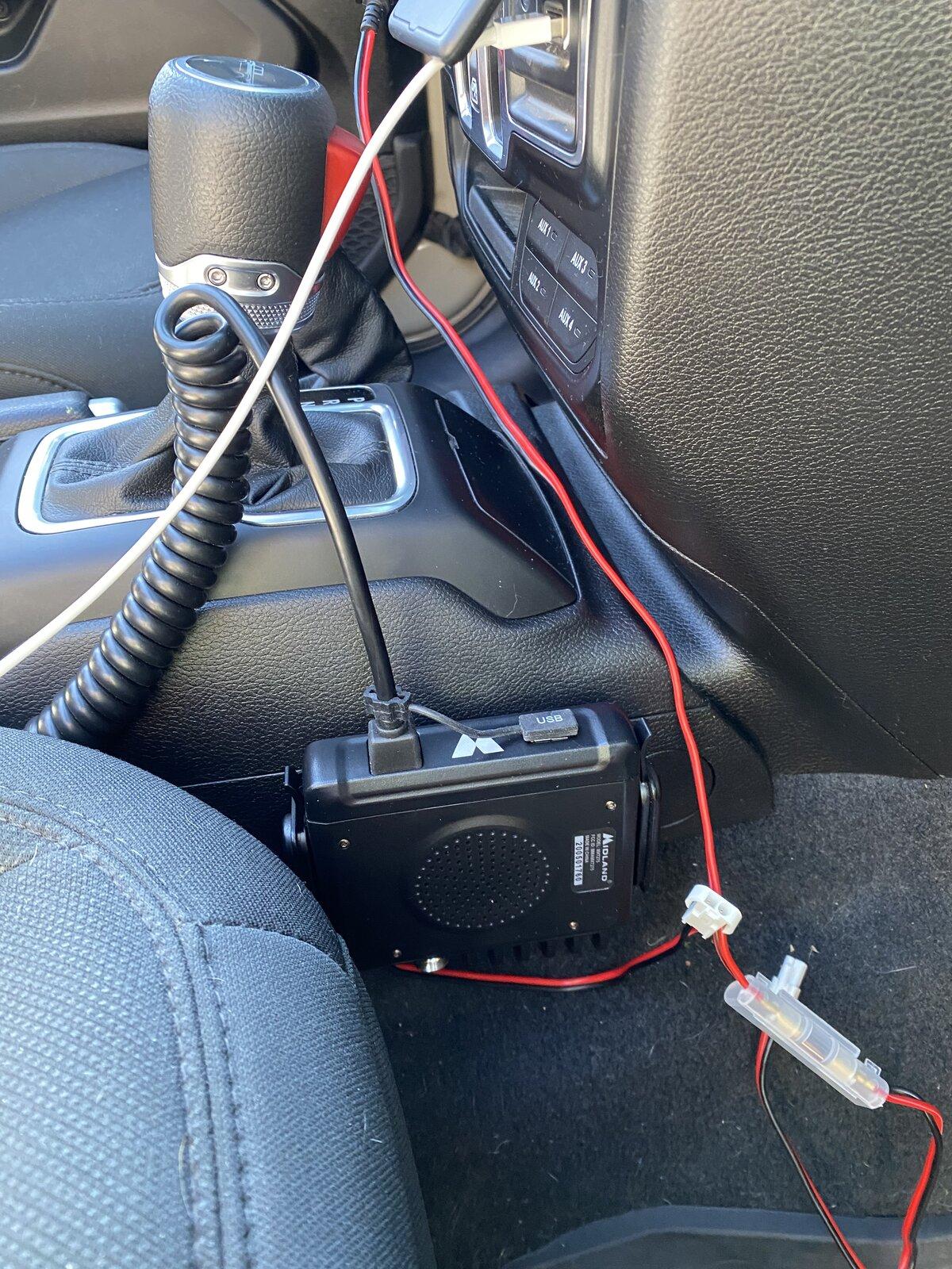

Putting my Midland in today. Some thoughts and links.
I went with this:
https://www.amazon.com/gp/product/B07FN2FBML/ref=ppx_yo_dt_b_asin_title_o03_s00?ie=UTF8&psc=1
Several people on here recommended it. It was a decent price and I like the idea of having weather band easily accessible. Overall the kit is decent and gives good info on getting the FCC license. I opted for a passenger side mount. It is out of the way and I will still be able to mount a holster for my side arm by the driver. The kit has a quick release and I will be able to easily pull the radio and lock it in the center console if I leave the top off and the Jeep unattended. I can run it off the cigarette lighter, but I intend to hardwire it with the wires that I understand are under the glove box.
Drawbacks and solutions: The antenna is probably not effective. It mounts with a magnet and I would like something better.
I opted for this. I'd assume it will be mounted driver side and away from the radio antenna.
I went for the full kit with the antenna and adapter. It should be in shortly.
https://www.cooltechllc.com/2018-je...t_bracket_options-bracket_mount_hardware_only

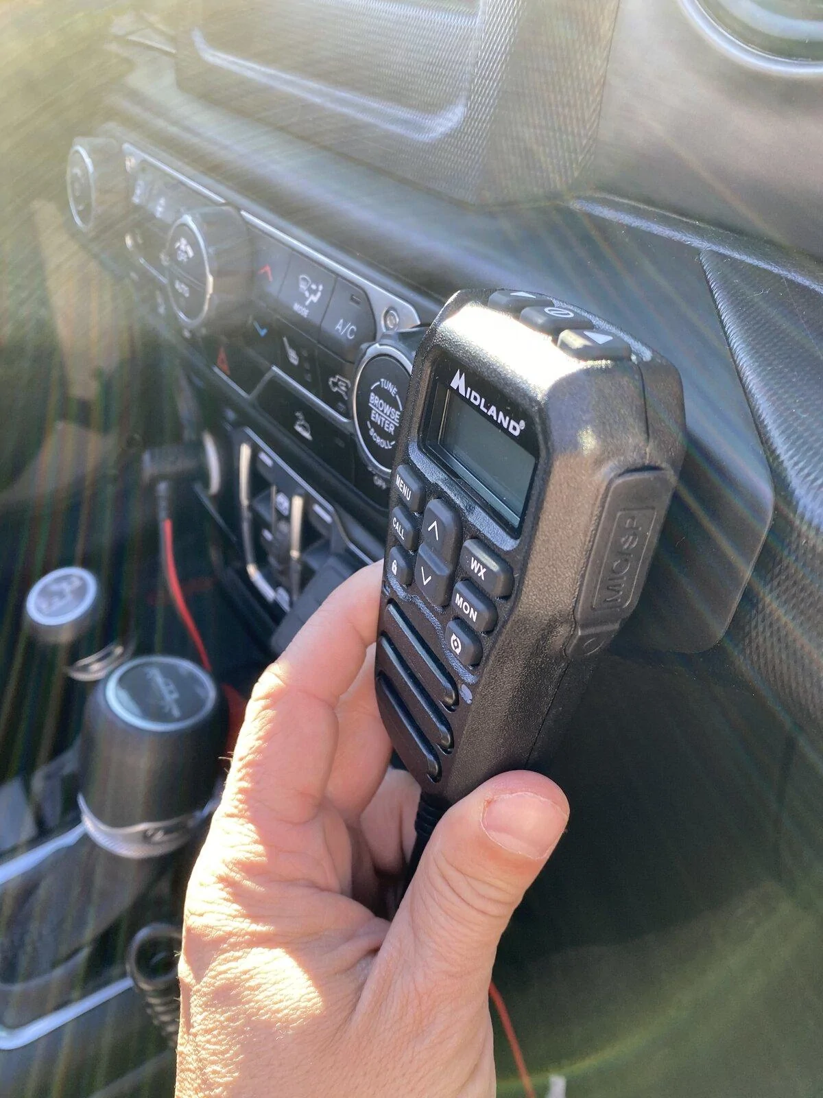

The mount for the mic that came with the kit is not idea. It has sticky tape and will not affix properly. I had the mount fall off under its own weight. I'm not crazy about finding screws and drilling into my dash in a rather visible place so I ordered this:
https://topsyproducts.com/collectio...ccessories/products/universal-cb-mic-mount-jl
Pardon the wires in the pics. I wanted to give some reference.
sarguy1941
Aug 20, 2019
529
331
USA
Jeep
I have the same unit. I was able to tuck it under the carpet below the glove box and behind the dash area. Out of site. I used the pre-wire from the factory for accessories. Also used an NMO mount antenna on my back rack. Night and day different than the one that ships with it.
