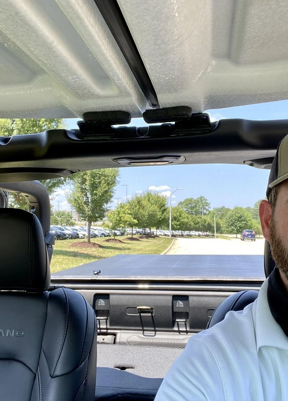

Yes, but I can’t really tell a difference with it open or closed.
That’s with the freedom panels only, in case anyone is curious. It works great.
Jeep Gladiator MPG with top off--Big difference? D6A70E53-ED14-4146-870A-4E25E91E1A26
