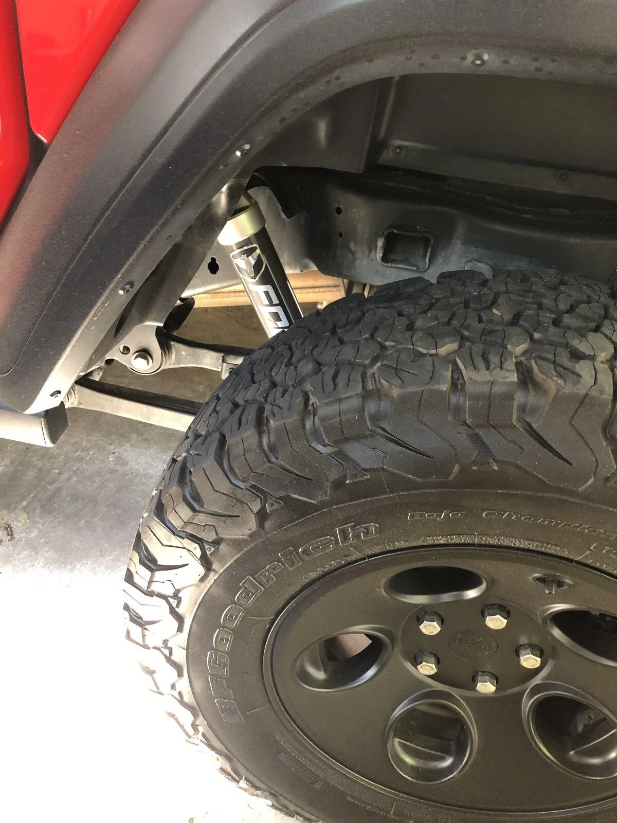

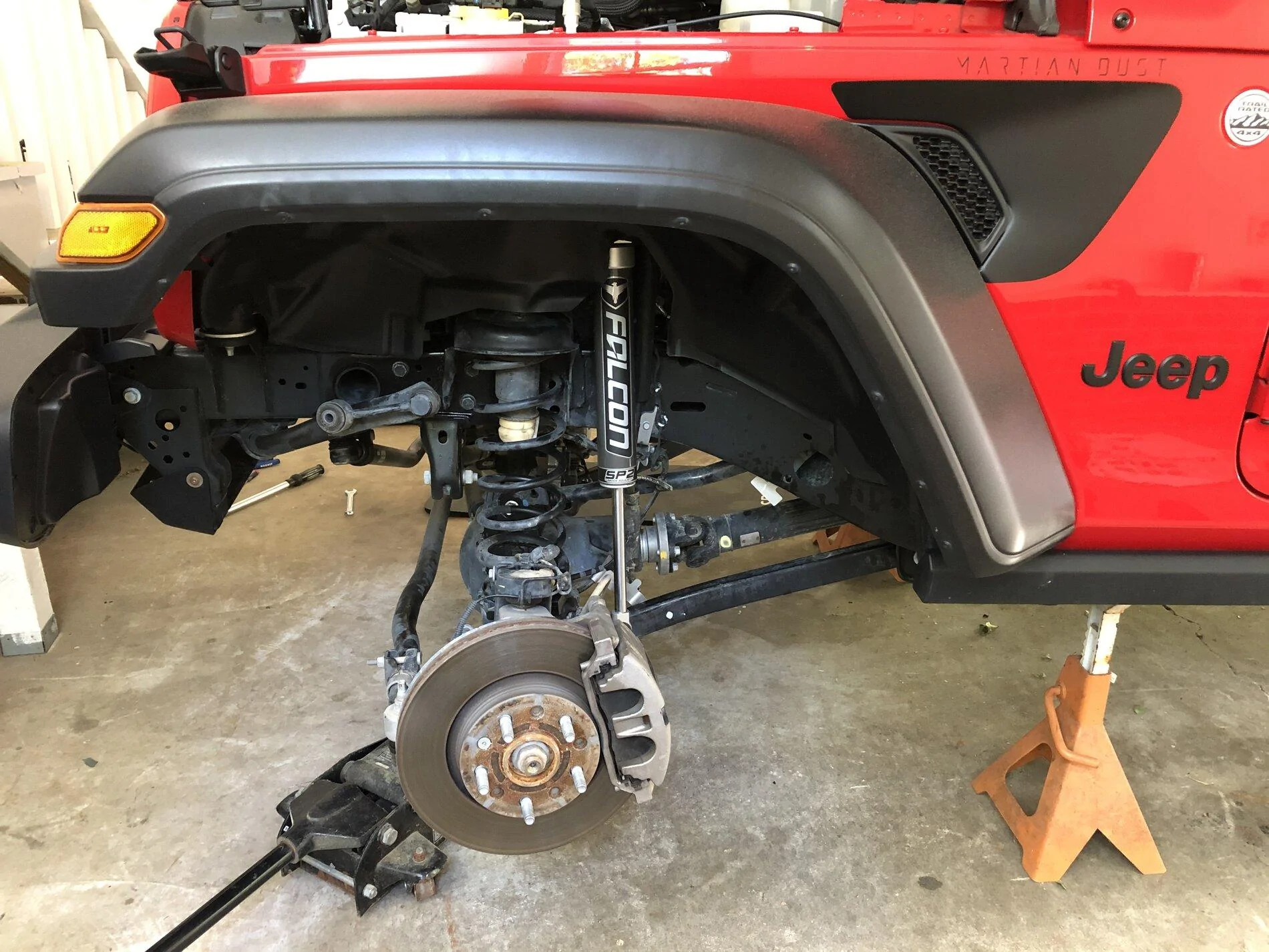

the falcons, like the fox shocks, look great, peeking out behind the tire. I need to take a good side pic but in the meantime, here are the couple of install pics i took

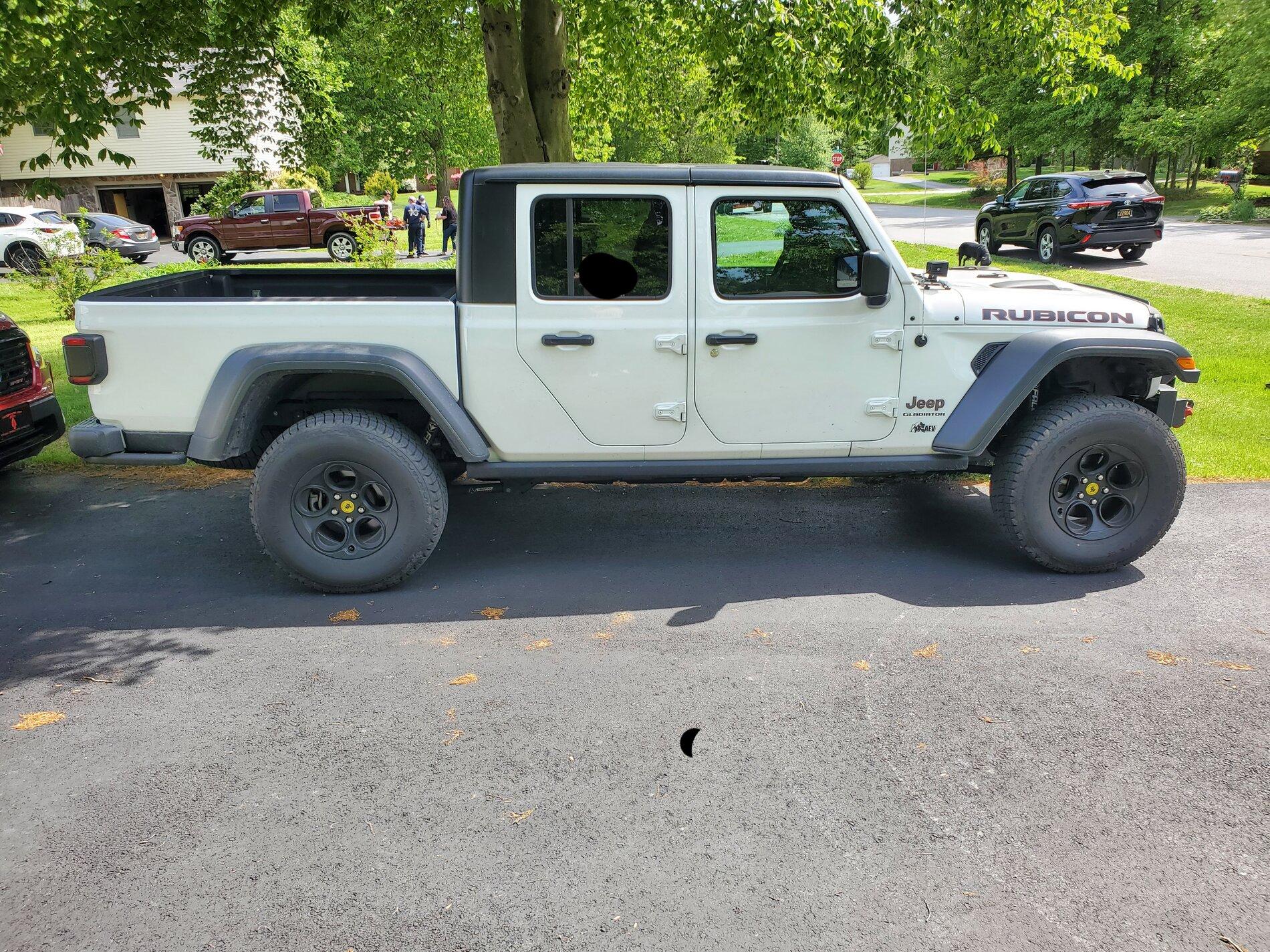

I honestly have no complaints with the Eibach springs. My lift is somewhat piecemealed but it is sound and got me where I wanted to stay at a mild 2" or below lift with slight leveling of the front but still a slight rake of the rear.
When I pieced my lift using the Eibach springs, I wanted to do the Mopar 2" lift but at that time the whole front spring bowing was a thing and that is what drove me to the 2"/1" spring lift and the Falcon SP2 2.1 0-1.5" shocks. Everything else in the industry aftermarket starts at 2.5" and goes up from there.
Eibach Front 2" Springs
Eibach Rear 1" Springs
Falcon SP2 2.1 Monotube Shocks 0-1.5"
Teraflex Progressive Bump Stop Kit
Mopar Front Sway Bar Links 2" Lift
Daystar Coil Spring Correction Kit (Front)
