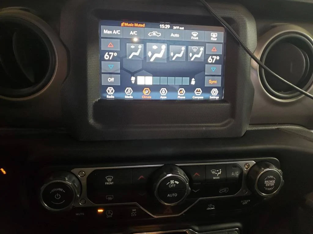

I have a JT Sport with the 5" Uconnect. A year or so ago I stuck a 7" in it. Worked fine but I was never satisfied with not having volume/tuning knobs or being able to mute the stupid when needed. So I put the 5" back in and sold the 7".
Recently I decided to try again but this time upgrade the HVAC controls also. I found a used 7" Uconnect from a 2019 JL Wrangler for a good price. Installed it and was happy to see it all seemed to work fine, including the backup camera.
Since my JT has none of the fancy options, I needed the most base center stack I could find. There are a bunch of different center stack controls out there depending on your JT options. Took awhile but I found one on eBay that looked like what I wanted. PN 7BU55DX9AB. I installed it today.
I already had Jscan on my batphone, a bypass cable and OBD II Bluetooth adapter. I set the HVAC controls for "dual zone atc" even though I suspect "dual zone mtc" would work.
I have to set the temp manually but I'm ok with that. At this time I'm not sure I'm going to install a temp sensor or not.
Anyway, hope this helps anyone thinking of doing the upgrade.

Well, my journey has some bumps in the road.
Without the cabin temp and sun load sensors in the Jeep the output temps of the heating system are all over the place. They basically go from full hot to cool.
My JT is one of those NOT pre-wired for the sensors. I found the connector PNs and can build a harness but I'm going to try something else.

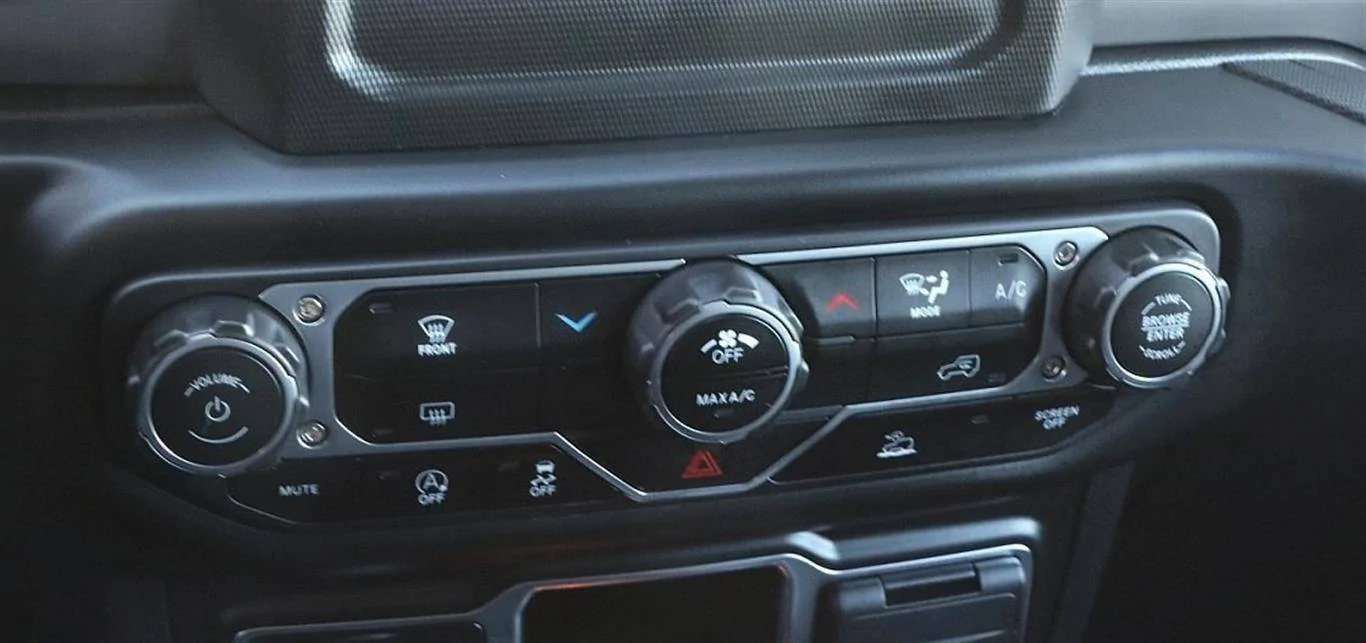

On the JL forum someone pointed out that after 2022 all JLs/JTs have the 7" Uconnect. That means there are Sports out there with single zone manual temp control HVAC controls with radio controls.
I got on Auto Trader and looked at 2022/23 Sports until I found one with HVAC controls that have the features I need. I copied the VIN and gave it to Benny at AllMoparParts.com. He was able to reference the VIN and get me a part number. It's on order. For those interested, the PN of the controls pictured is 7EV04DX9AA.

Well, unfortunately this center stack was not the plug-n-play solution I hoped it would be, in my case at least. Set at single zone, mtc the HVAC controls did nothing. I tried a few other HVAC settings with mixed results. Radio controls worked.
There may be settings in computer somewhere that will work but as an old Boomer that used to set distributer points with a matchbook cover I'm not comfortable experimenting with the brains of my Jeep.
Original uconnect and HVAC controls are back in my Jeep at the moment. Not sure what my next step is going to be.
