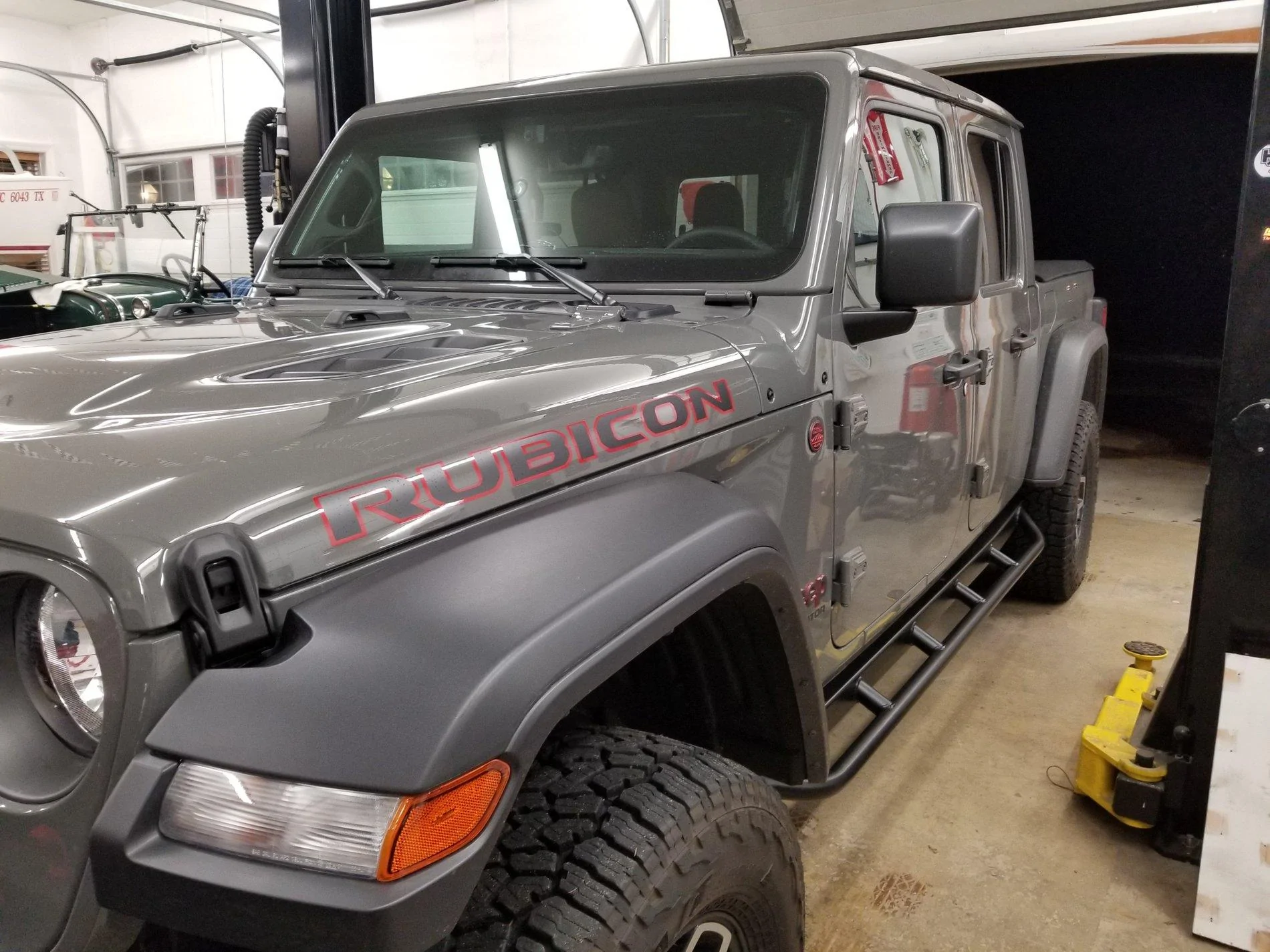

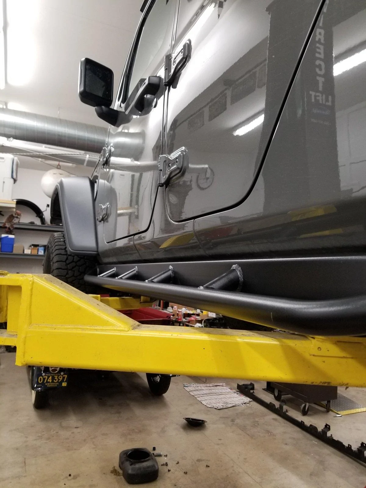

Hey all, I know someone has reviewed these in the past but I thought I would throw my hat into the ring. Two part review, one for the product and one for the install. I chose these because I feel the way they mount is extremely strong, better than mounting something over the existing rails.
I chose the down angled ones as part of a cunning plan you see. With tires and a lift on the way, my 5'0" navigator will never notice them...
Firstly, the product
Shipping. A+, wow these things were packed like they were shipping a porcelain tea set. They arrived without damage

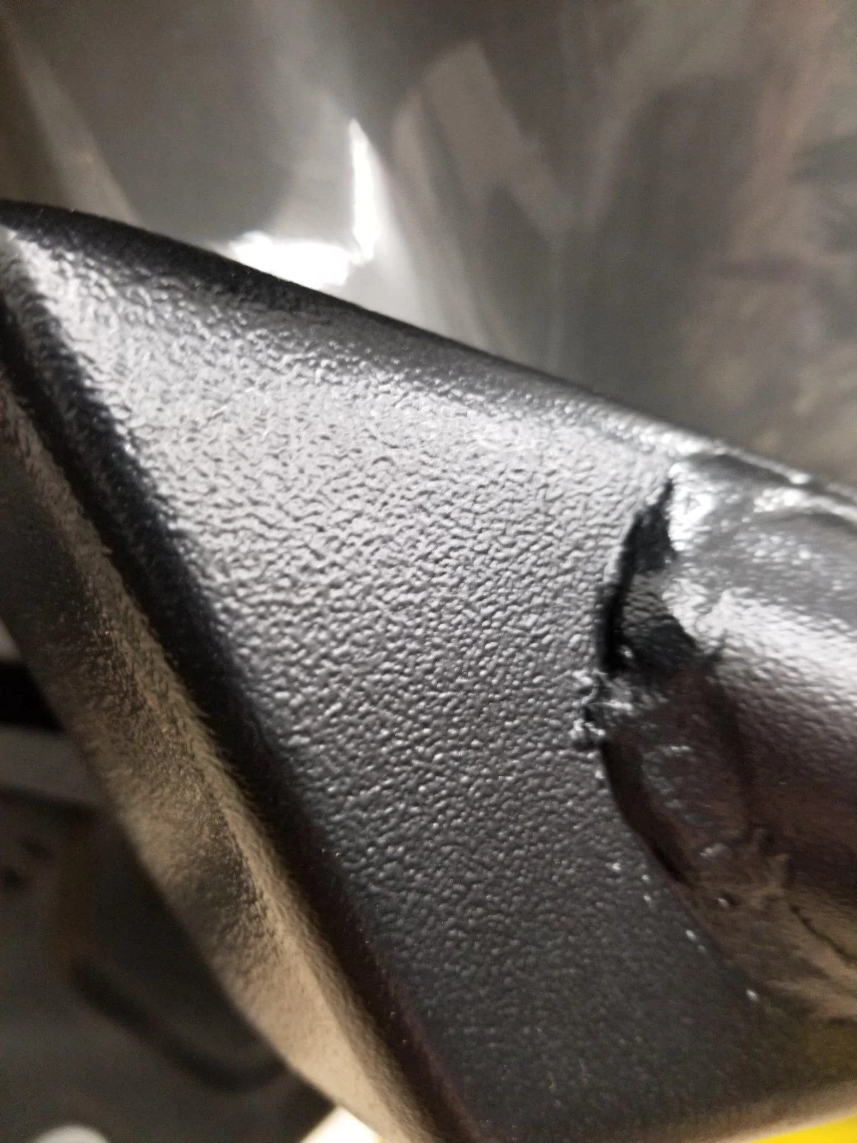

Finish. A-, the powder coat is well done, some of the welds have a few apprentice marks.
Bit of a missed weld there (hard to see, but the end is open), but honestly nothing major. A few other sags, but again nothibg major. I was a certified TIG welder in years past so I'm overly critical. These welds are PLENTY strong
Build quality B+ Holy crap these things are overbuilt. I think a Abrams could use these as sliders and it would be fine. The issue here is not all of their studs line up with the pinch seam holes. They are upfront about this, and say in advance that you will probably have to drill some out. A STEP DRILL IS YOUR FRIEND HERE. I had to drill out about half of the holes to get them to line up, and even then it took some he-maning to get everything lined up. Rock Hard says this is due to "Manufacturing differences with FCA" I think this is a cop out. If they don't have issue getting the Rubi rails to line up I don't see what is up with these.
Again this is really not much of an issue. However I should have preemptively drilled them out, as test fitting them gave me a workout.
Install review... NONE OF THIS IS A REFLECTION ON ROCK HARD 4X4.
I will be upfront here, this sucked way more than I thought it would...

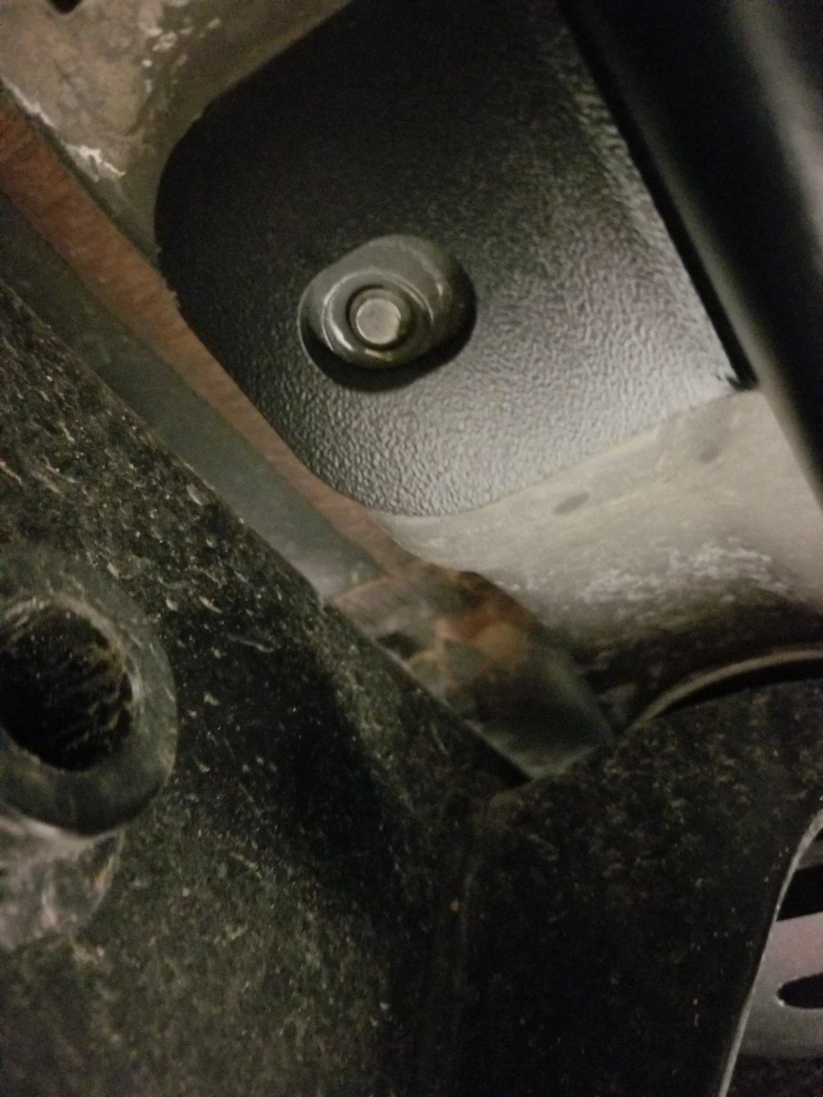

Two major issues contributed to the suckage. First this...
That bolt broke during removal of the stock Rubi rails. It broke using a normal 1/2 ratchet and with very little effort. I wonder if it was over torqued from the factory... The rest of the removal went very easy.
I have three choices
1)ignore it, the front body mount is close and these are strong enough that it shouldn't matter
2) wire wheel it and weld it up.
3) try to easy out it hahahahahaha... We all know how that will go.

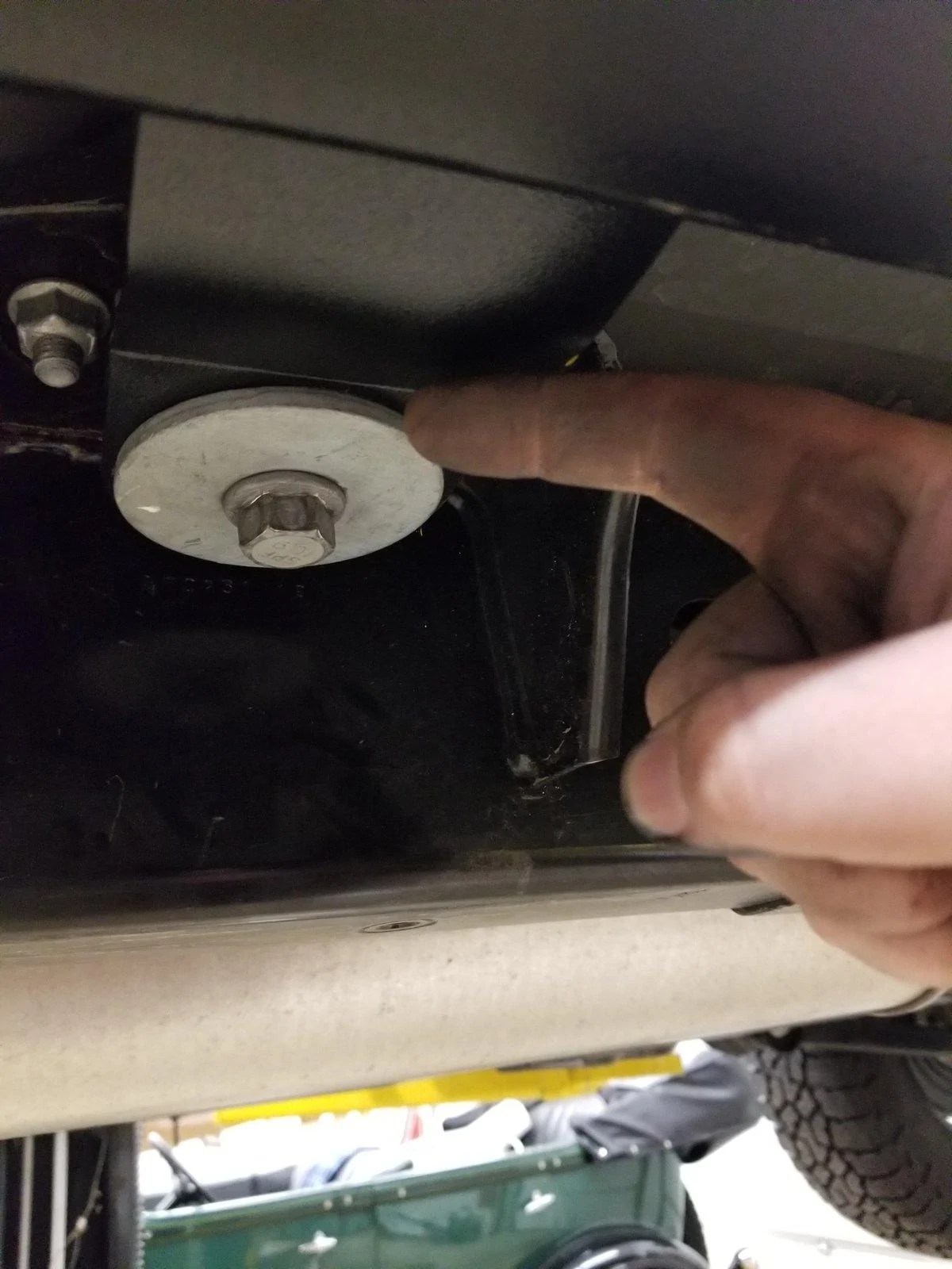

The second issue is this
This body mount was awful. If you have never removed body mount hardware before you should know they can be tight to say this least. I strongly advise against using impact tools on these to avoid stripping anything. the passenger side mounts came loose with no real issue. The driver side center mount and rear mount were awful. This center mount required a 4' cheater bar the entire way out. It sucked. Rear mount was just as bad. I was really afraid I was going to liberate a captured nut the entire time. If you do this then congrats, you just made a lot more work for yourself. I had to reuse the factory bolts in these two locations as I could not for the life of me get the new hardware started on these two.
Those two mounts accounted for about 40% of the install time....
So I did this all by myself, which was dumb. These things are heavy, and I'll be feeling it tomorrow.
I give this project a solid 7 out of 10 on the Wheaties scale If done solo.
Overall I am super pleased with these. I plan on testing them out soon!!!

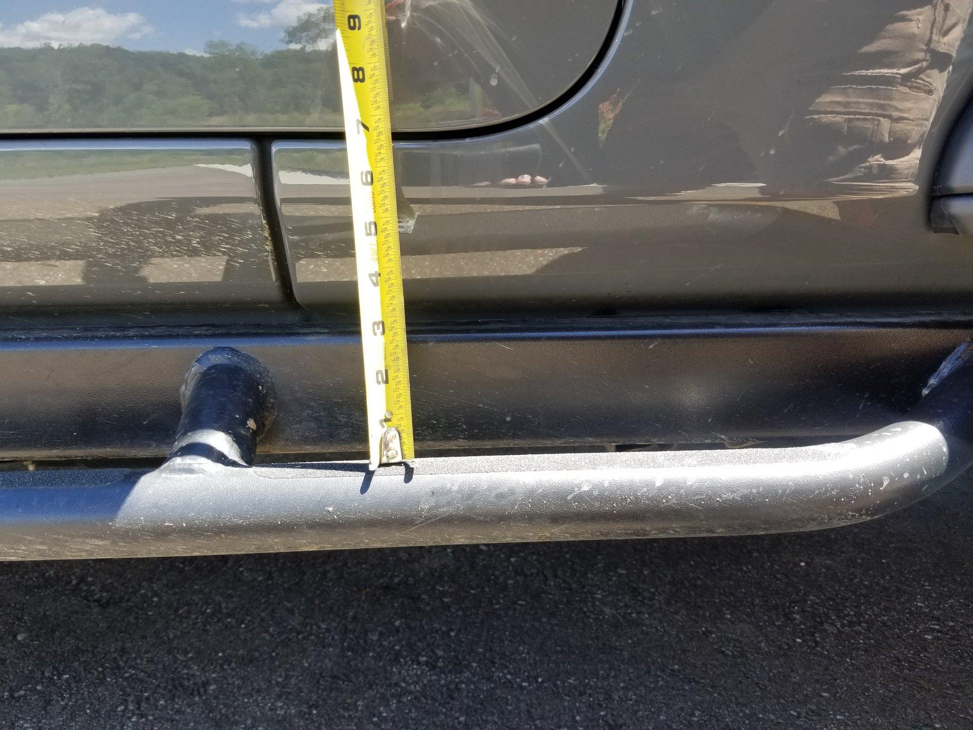

Can you measure from the bottom of your door to the top of the Rock Hard?
whiteglad
Joe
Feb 12, 2020
1,162
1,015
Vegas
2022 Gladiator Mojave
Rock Hard angled up, 4" from top of step tube to bottom of door.
