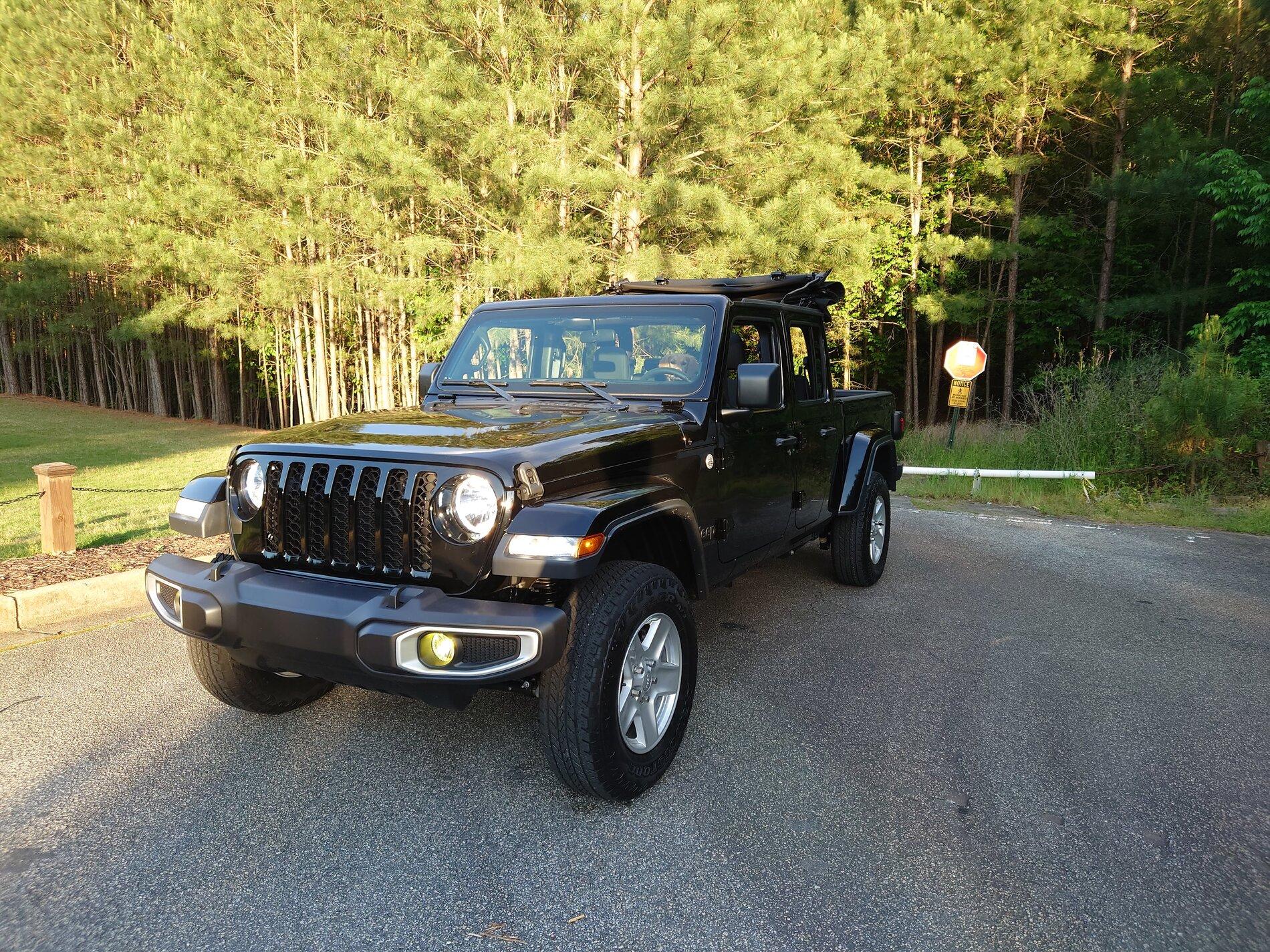

A picture for your reading pleasure (Daystar 1.5" kit only).
