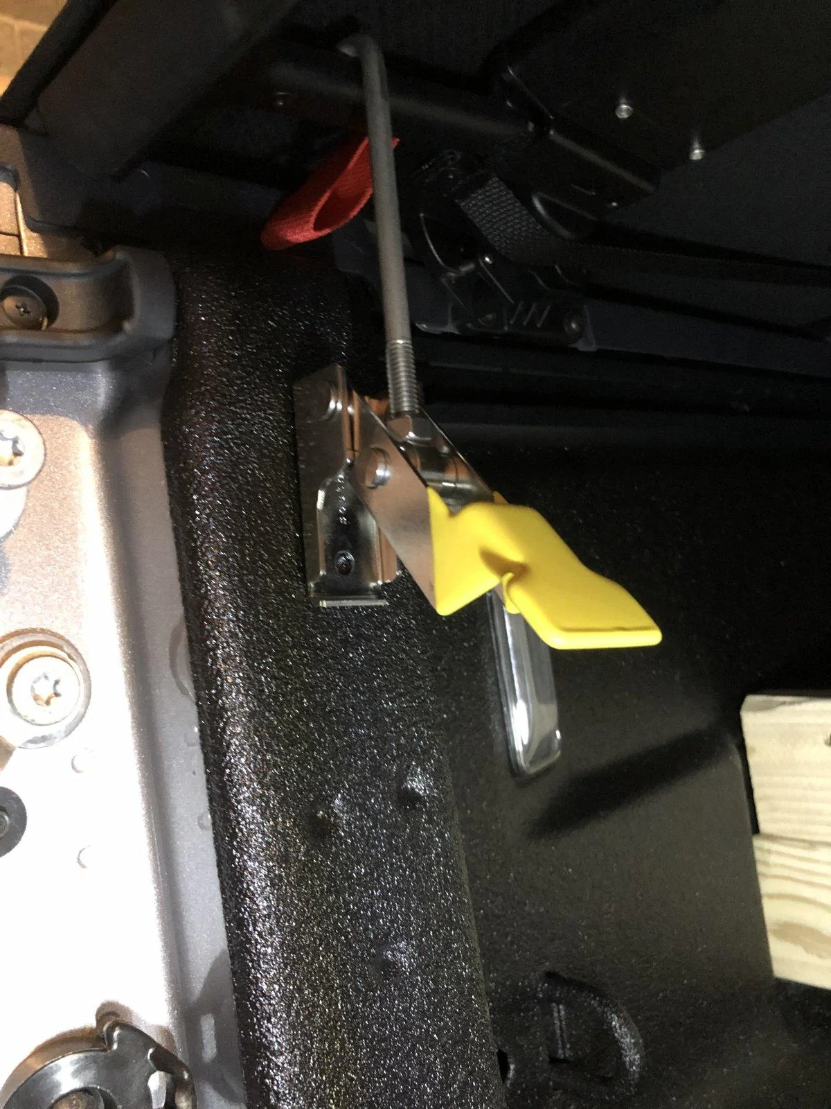

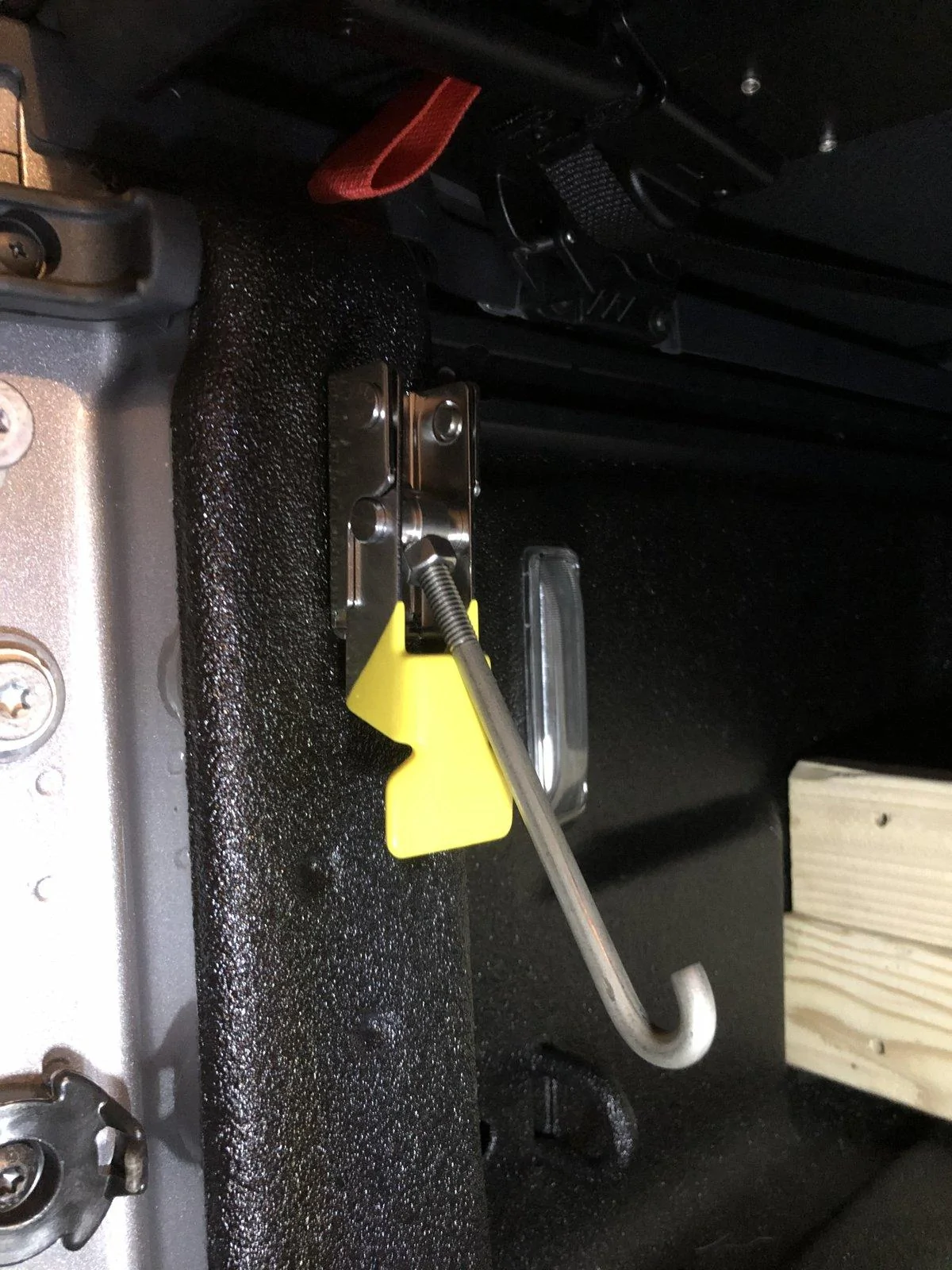

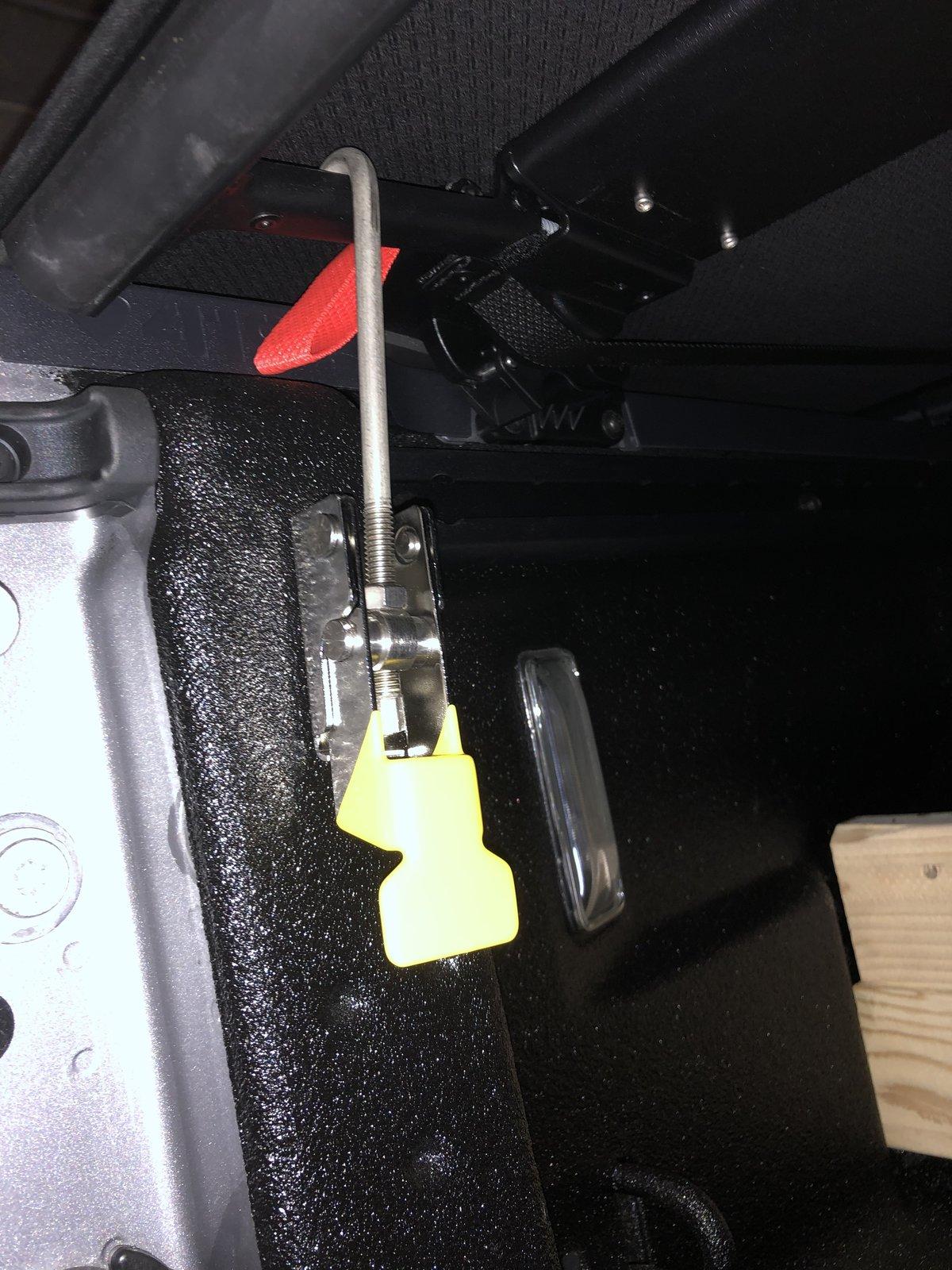

My Tonneau Cover Lock
Gatorized
Sep 13, 2019
1,674
1,545
ME/NH
It a medium sized Southco adjustable draw latch.
I still need to install a second screw.

I have the Mopar tonneau and of course it does have latches and they are protected by locking the tailgate. But even if you installed these, you can cut the tonneau fabric and access these latches so what's to be gained?
DeanJP1
DeanJP1
Dean
Nov 18, 2019
NJ
Overland
It has been stated, you could pry up the last section of the Mopar tonneau cover with just your fingers.
This added solution prevents the prying up of the last section.
A little added security against the opportune thief, but not the evil ones.

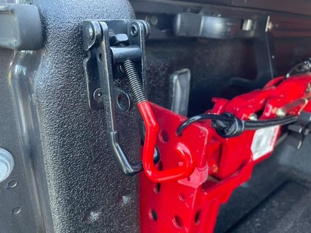

Thanks for this idea. I built a temp version using a draw latch. I couldn't get the hook version so I went with a loop and cut it into a hook with a dremel.
At the moment it's a temporary one. I managed to find a black version on Amazon which I have on order so when that arrives I'll put some rivnuts into the bed and make it more permanent. The black should at least make it look like it's natively part of the jeep.
