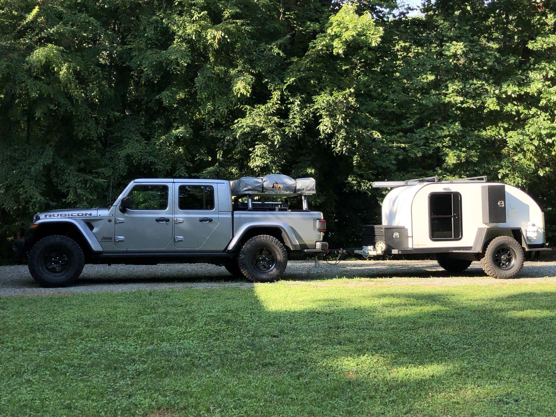

After a few tows with the Gladiator my opinion on its worthiness has significantly changed. I was very skeptical on its ability to tow anything near what its rated for comfortably. I have made a 2k mile tow with my teardrop behind me from NC to NY/CN border and it pulls it just fine up to 70-75. It struggled a bit in the PA mountains but still kept up ok. It only weighs 2200 lbs but is very tongue heavy which the gladiators suspension doesn’t really like, its too bouncy for 320lbs of toungue weight and another 3-400 in the bed. I will be adding an Airlift airbag system to the rear whether I lift it or not as it made a huge difference in both my JKU and F150 in the handling while towing and in keeping it leveled out vs squatting in the rear. We averaged right around 12-13 mpg for this trip

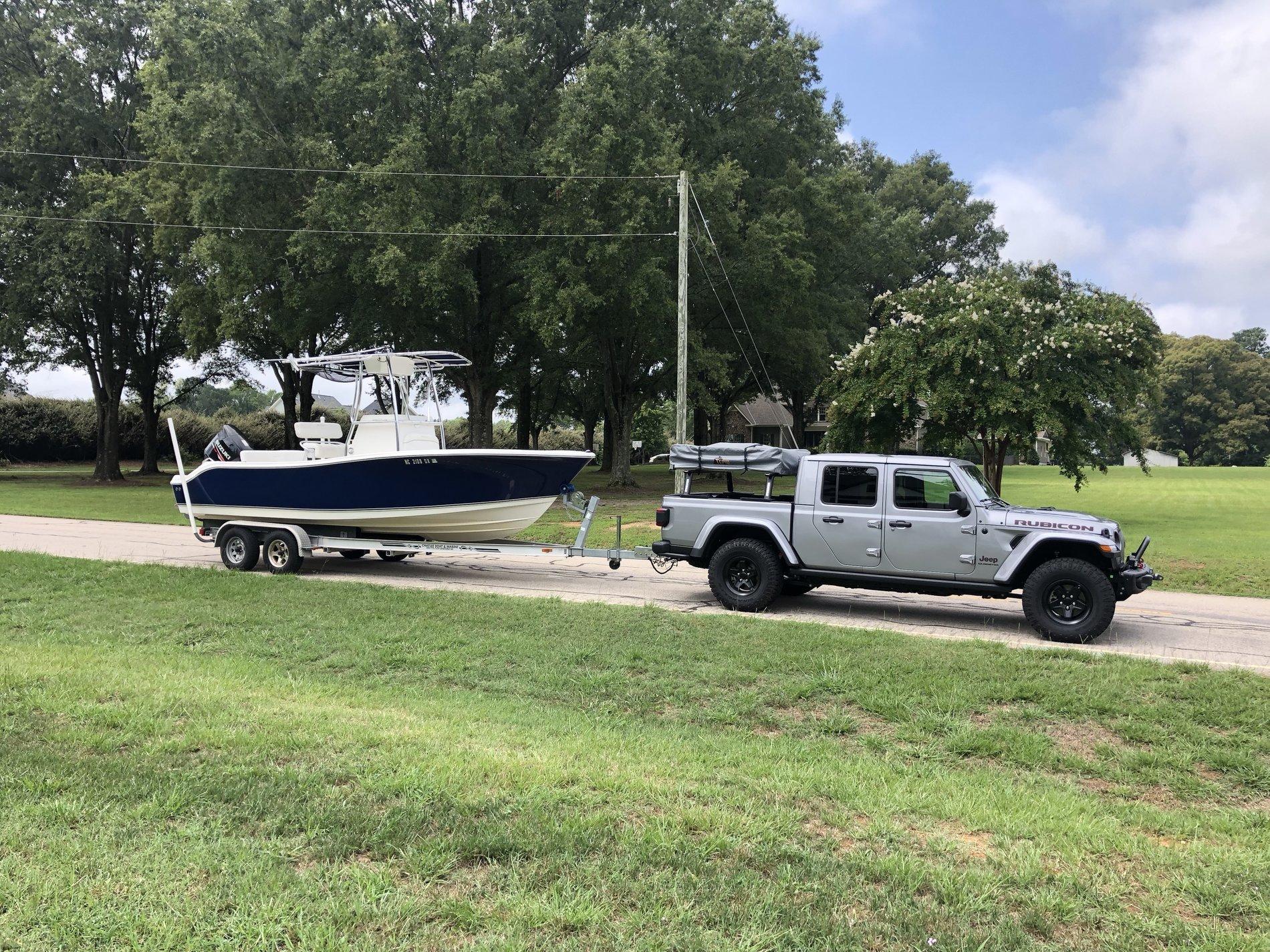

Next up was the boat, a 22' Nautic Star. I probably will never tow it with the Gladiator again since I have an F150 but it actually did it just fine surprisingly. 65mph was where it preferred to be on the highway and it is dead flat or even downhill from Raleigh to Topsail Island NC, 120miles. Any hills of any size would have made it pretty slow and at redline the whole way but its doable. For reference the total package boat, motor, trailer etc comes in at about 5k lbs and the T-Top acts as a sail. Its the max I’d feel safe towing and honestly I’d prefer to keep it at around 4k lbs to feel safer and a bit less white knuckled in traffic. I got about 8mpg for this trip at 65mph, bump the speed up to 70mph and it dropped to 5-6mpg...
