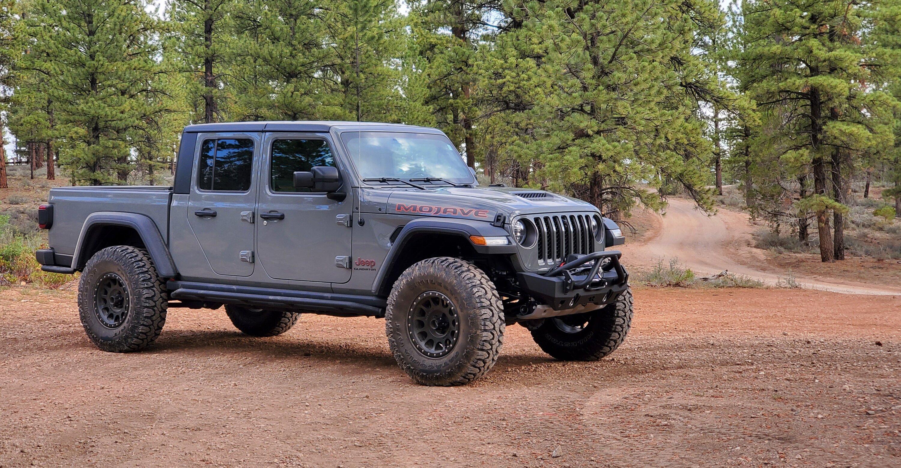

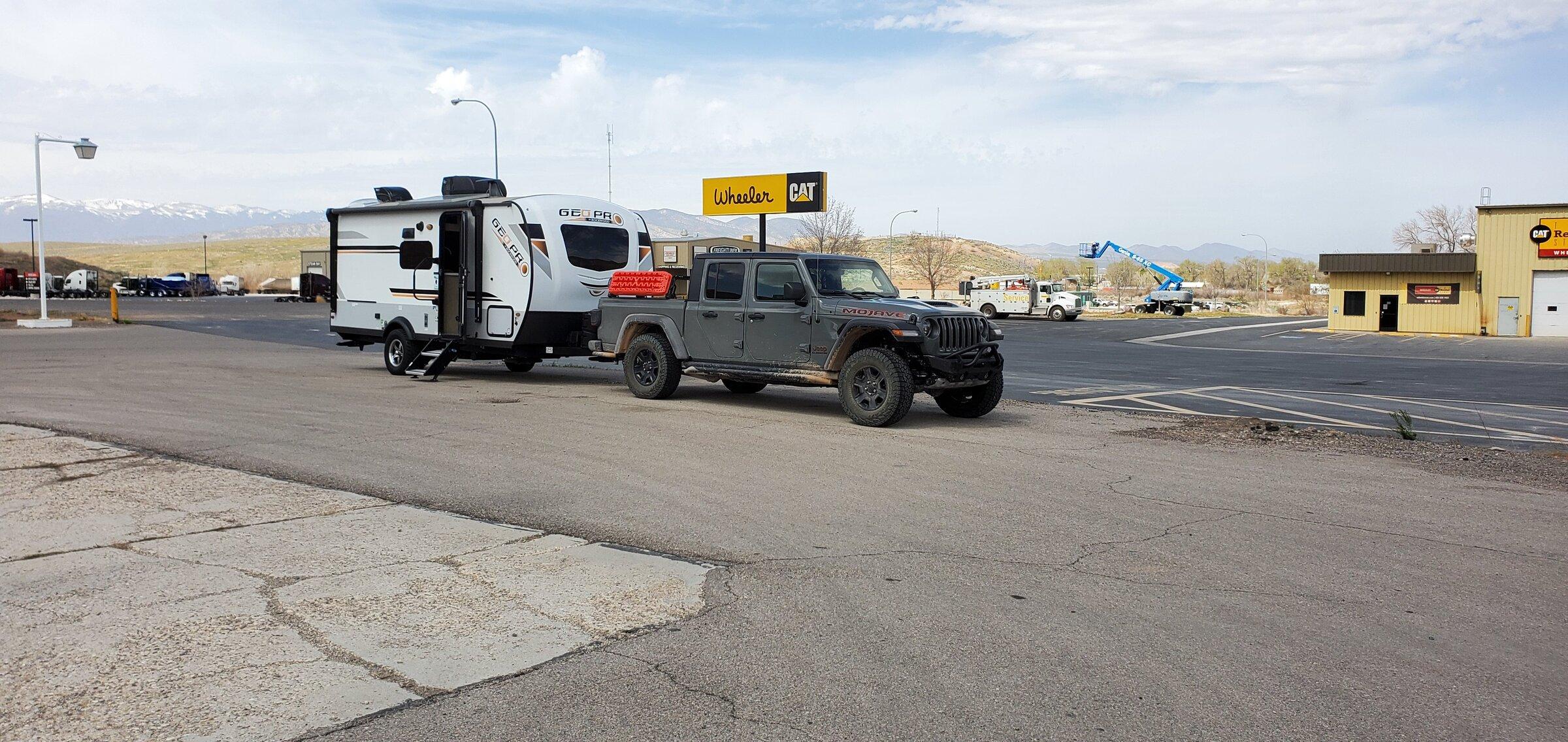

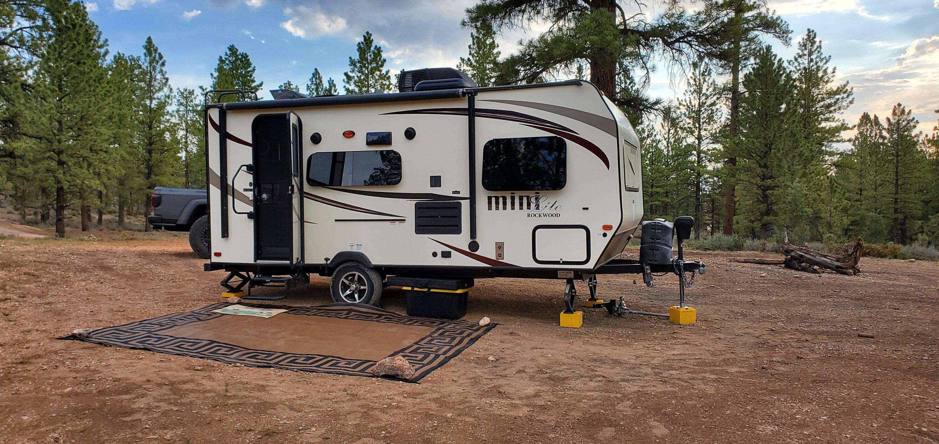

UPDATE! Recently I installed a lift and 37s and towed a camper down to Bryce canyon, so I figured this would add to my review for anyone looking to run 37s on stock 4.10 gears. The lift is the AEV 2 inch spacer lift with the rancho control arm drop brackets and the rims are method 305s with 37x12.5x17 patagonias. The wheels weighed roughly 90lbs each and measured 36.25 inches once mounted. I used a tazer mini to get everything calibrated and accurate. I kept my stock wheels to use for towing until I got around to a re-gear, but this trip was 75% on the freeway so I figured I'd see how good or bad it's like to tow with 37s and the 4.10s. Without towing the trailer I was averaging low to mid 16 mpg with the 37s.
The camper I pulled this time is a forester river mini lite model 1909s. The owner said its around 3300lbs dry and we had it filled with 40 gallons or fresh water and all our gear. He was confident it weighed in the low 4000s as it was setup. This time I used a weight distribution hitch and the trailer had a Bluetooth brake controller. The weather on the trip down to Bryce was about 102 and there was the normal 10 to 20 mph winds that are always in utah. The first half of the trip was very easy with the truck staying in either 5th 6th or 7th depending on the grade and speed and honestly didn't feel much different than stock...until I hit the first long incline. With the AC on hi and some constant headwind the truck struggled and dropped all the way to 2nd gear and about 45 mph going up the hill. Coolant temp shot up past the half mark and the trans temp got up to 210 and oil temp up to 240 before they all leveled off and the climb ended. These inclines continued for the last hour of the trip on the freeway and had me watching the gauges each time. Once off the freeway it was similar, but with slower speed limits it wasnt as tough on the truck. Once we got to Bryce we camped in the woods and the gladiator had no problem pulling the camper off road. The trip down I averaged 8mpg. On the way home I emptied the fresh, gray and black tanks before we hit the road to try to shed some weight. On the ride back to SLC the weather was mid 80s with spotty rain and on and off 20 mph winds that were mostly cross winds. Now I'm not sure if the inclines on the way back home were less steep or if the loss of the water weight helped or of the lower temps helped or all of the above, but the pull home was a much better experience and honestly felt very similar to stock. Coolant and trans and oil temp never got anywhere near what they did on the ride down and I was able to maintain a much more respectable speed on the freeway. I averaged just below 11 mpg on the way home. Overall it wasn't as bad as I thought it was going to be. I'm still leaning towards a regear, but this trip is making me question if I really need to. Hope this helps anyone in a similar situation.
