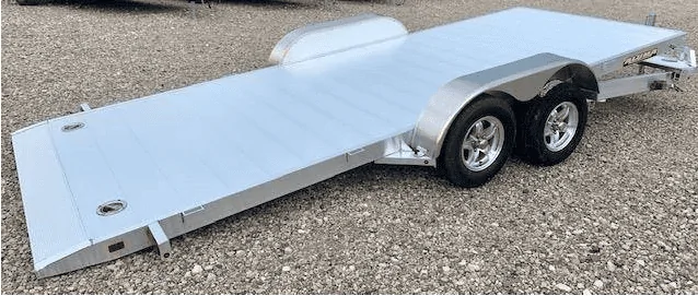

I'll have to look at the trailer's GVWR but I believe it's somewhere around 7,000 pounds, the trailer itself weighs 1500 pounds without accessories like spare, etc. The numbers are on the trailer itself.

Nice trailer.
My Nismo is too low for that unless I use wood to drive up on.
I want one of these. But they are $$$
https://www.futuratrailers.com/us/pro-sport
