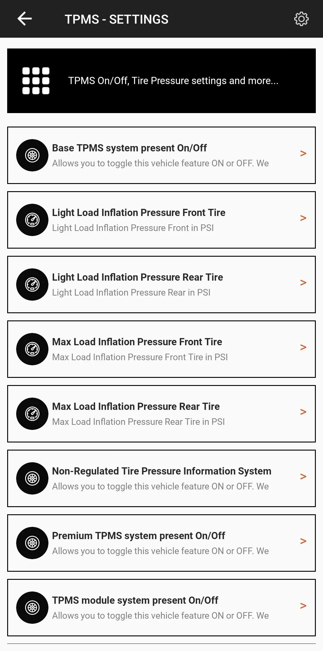

You have to inflate to something like 5 over and drive it some to clear the alert. (Check the manual)
Then you can go back down.
You can also use a device like ECRI or Tazer to set the TPMS thresholds lower.
You could also take it to a tire shop and have the sensors removed completely.

Cheapest options are inflating it to the correct pressure or buying a tinfoil hat and putting electrical tape over the annoying lights. Otherwise if you have different wheels/tires that require lower pressures, you can invest in a way to change the PSI threshold as @Lunentucker mentioned. Chances are if you do have different-than-stock tires, you've had to use one of these tools to change the tire size to correct the speedometer anyway, so you might as well get this done too.

Use a Tazer to set it for 4-5 psi below your desired pressure and good to go. I wouldn't want to remove them entirely, I imagine you'd still have to disable the system then, and it's nice being able to open it up on the display and see what they're at, imo.

Tazer/jscan can turn it off or change the set level.

I run the Falken ATs on my Mojave at 33 psi and have adjusted the warning to 30 psi using a Tazer.
