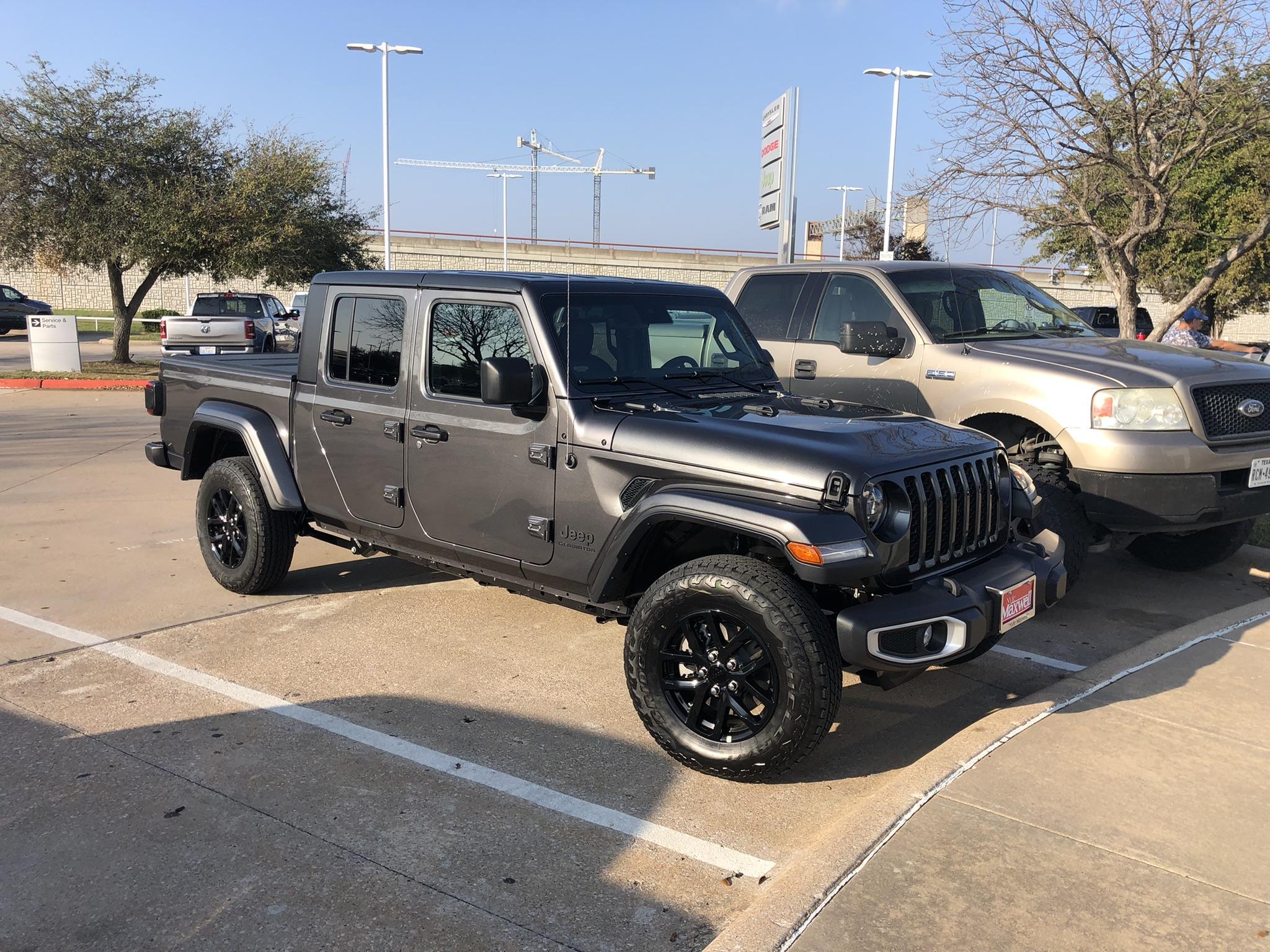

As we transitioned to home schooling our son, we started dreaming about being able to teach geology at the Grand Canyon, discuss pre-columbian history in Chaco Canyon and glaciers in the rockies. We decided that the combination of a Jeep Gladiator max tow and a 23ft Airstream International travel trailer would best meet our needs and started shopping...
The Jeep Gladiator was ordered from a local dealership on July 27th, 2021 and the Airstream was ordered a few months later to make sure it wouldn't get delivered before the truck. Fast forward a few months and I picked up the Jeep Gladiator on December 10th, 2021 with the Airstream expected at the local dealership on January 7th, 2022.

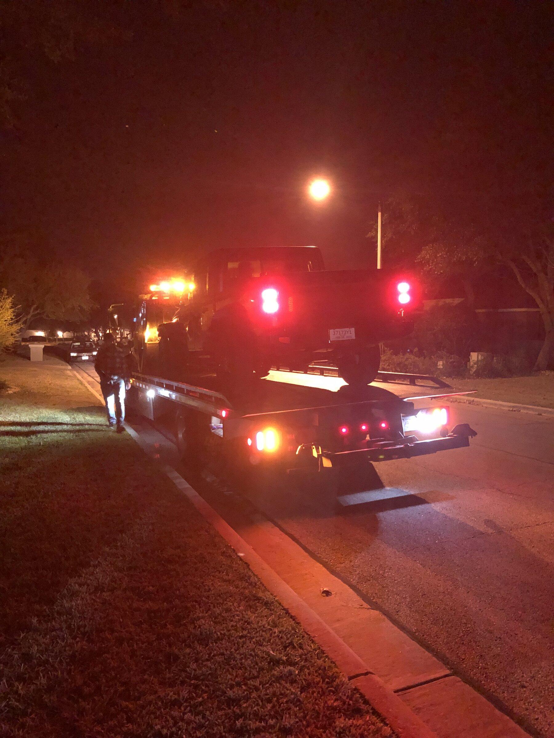

Unexpectedly, the replacement PCM made it by December 22nd and was installed on December 23rd. I happily picked up the Jeep from the dealer the same day and brought it back home.
On Christmas Eve the family went out to drive through the neighborhood to survey the Christmas lights. My daughter was driving and at some point she noticed the CEL was back. I quickly texted this development to my service advisor knowing that I wouldn’t get a response until after Christmas.
On Christmas Day I decided to drive the 2 miles from my house to the gas station to fill up the JT in spite of the Merry CEL. Turns out that’s was a bad idea as this time around it decided to get into limp mode limiting speed to 20ish mph and by the time I pulled into the neighborhood Shell gas station it woundn’t go beyond 10 mph with the CEL flashing. It totally gave up before making it to the pump stubordingly refusing to get out of park mode or to restart the engine. This forced me to abandon it hazard lights flashing and walk back home. The next step was to get it towed back home since there is literally no other place to tow it to on Christmas Day!
Surprisingly it only took 45 minutes to get a tow truck to the gas station even though it took 3 calls to Chrysler roadside assistance to get it scheduled. Obviously by the time the flatbed tow truck made it the truck was happy to start again although the transmission was still refusing to cooperate. After the tow truck driver fiddled for a while under the truck I was able to drive it up the flatbed and get it home.
