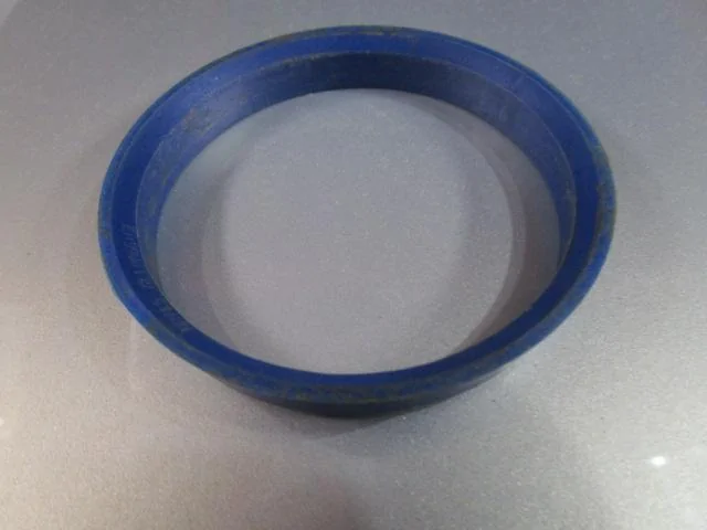

Looking for the rings for Fuel Assault Wheels, thanks.

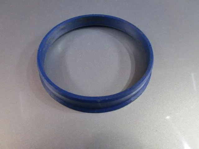

I don't think I've explained what I'm looking for, Fuel Wheels has been of no help in giving a part number that works on a 2020 Gladiator with Fuel Assault Wheels. Photo shows what I'm looking for, thanks.
Jeep Gladiator Need Hub Centric Rings. IMG_1332
Jeep Gladiator Need Hub Centric Rings. IMG_1333

I've got a couple of sets for my TJ. I used them with American Racing wheels. I bought them because my after market wheels were lug centric, and the tire jockeys at the tire stores kept putting them on wrong (mount the wheel, start the lugnuts, run the first lug nut down with their impact gun - locks the wherl off center). My wheels always go on straight if I use the procedure listed above. If you can figure out what size you need, you can buy them on Ebay. If the ones I have will work for you (71.5x83), you can have them for $10 shipped in the states.
