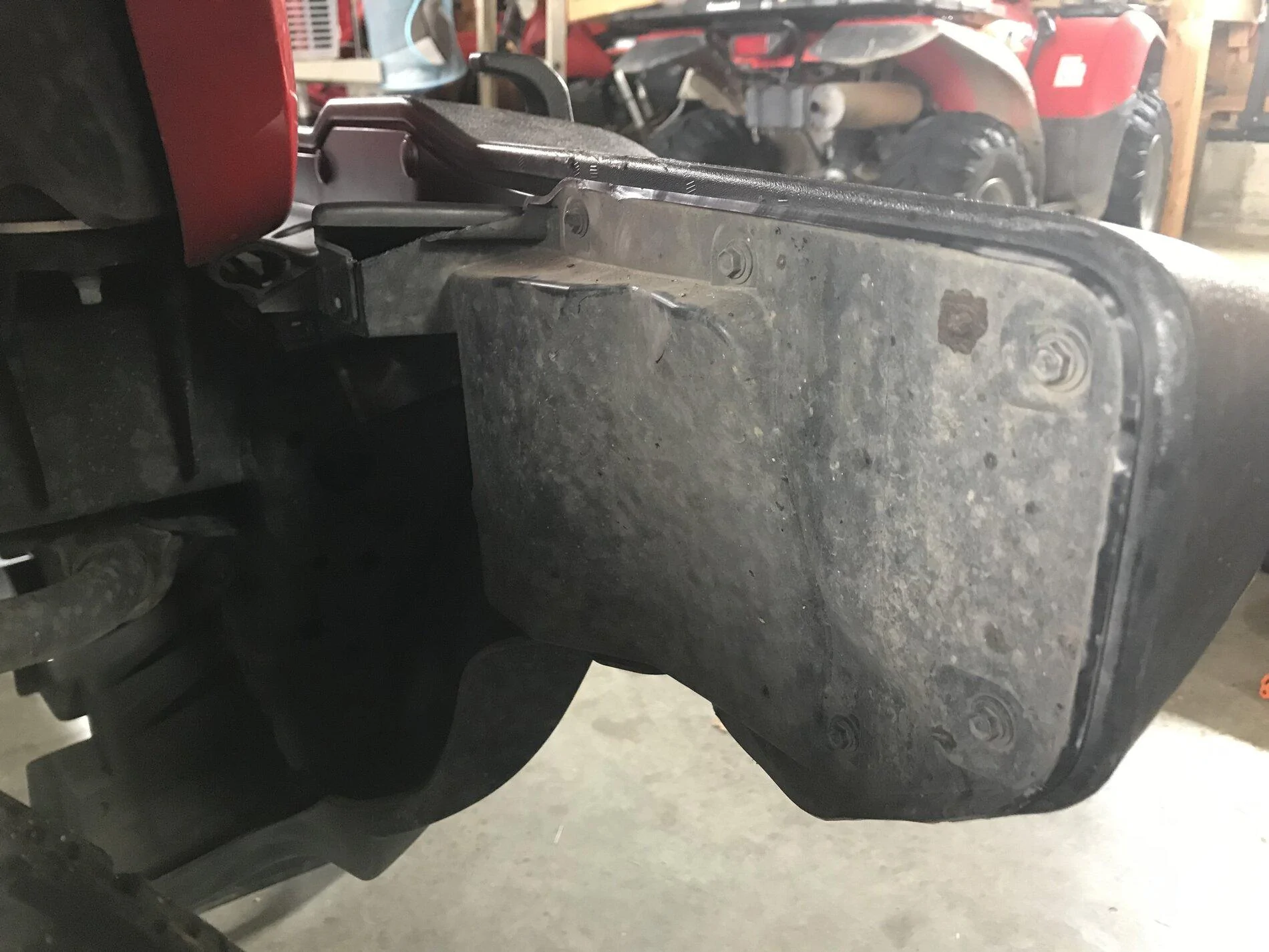

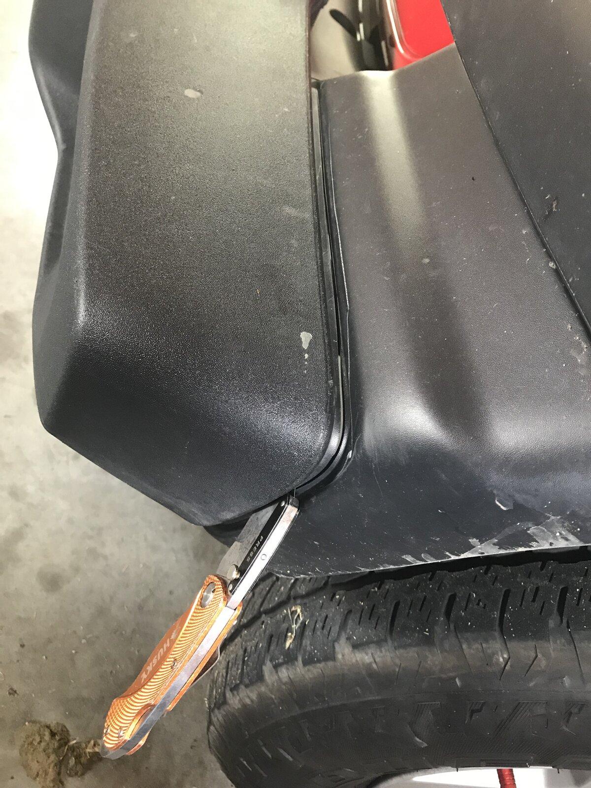

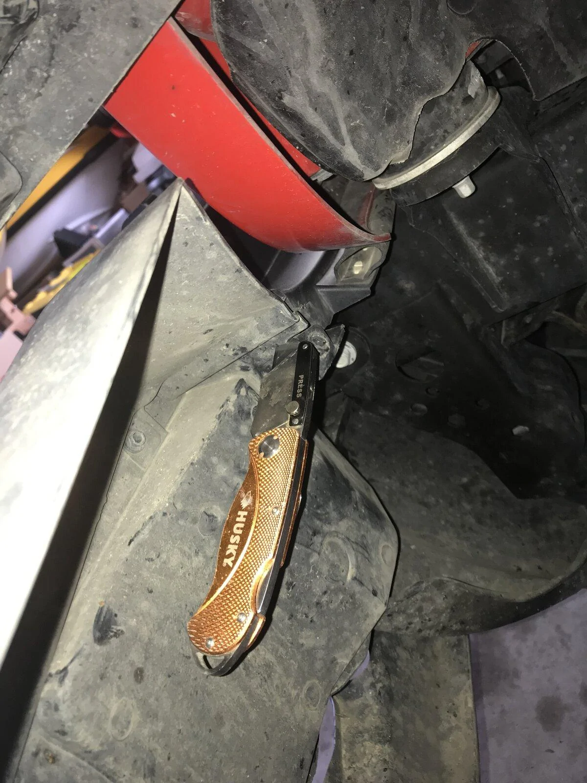

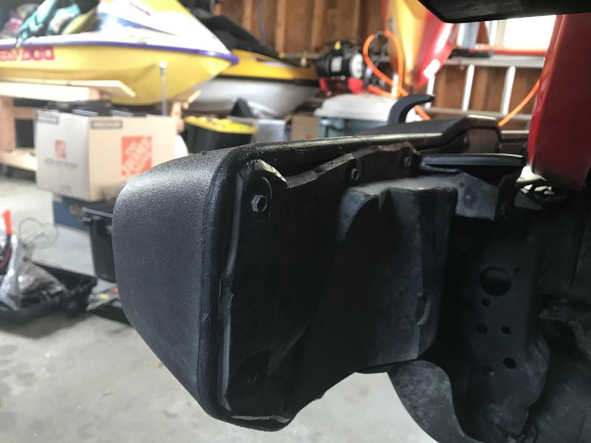

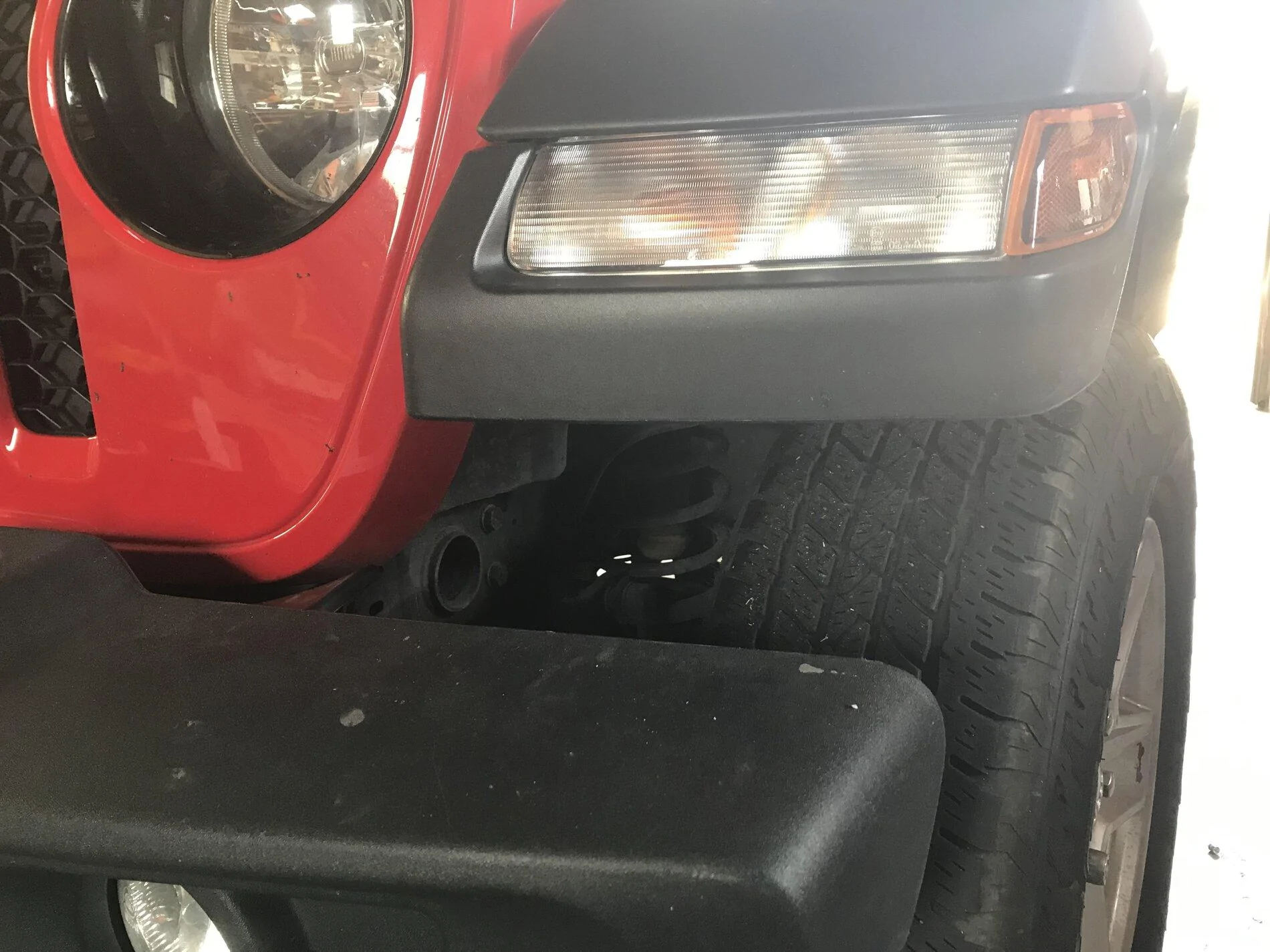

Use a good razor knife and cut around it leaving a cover over fog lights. I cut a little too much on the driver’s side but it is still sealed up.

I call them air dams or trim pieces. I used a dremel tool with a cut off wheel to trim my friend's on his JL and found it to be a little cleaner cut.

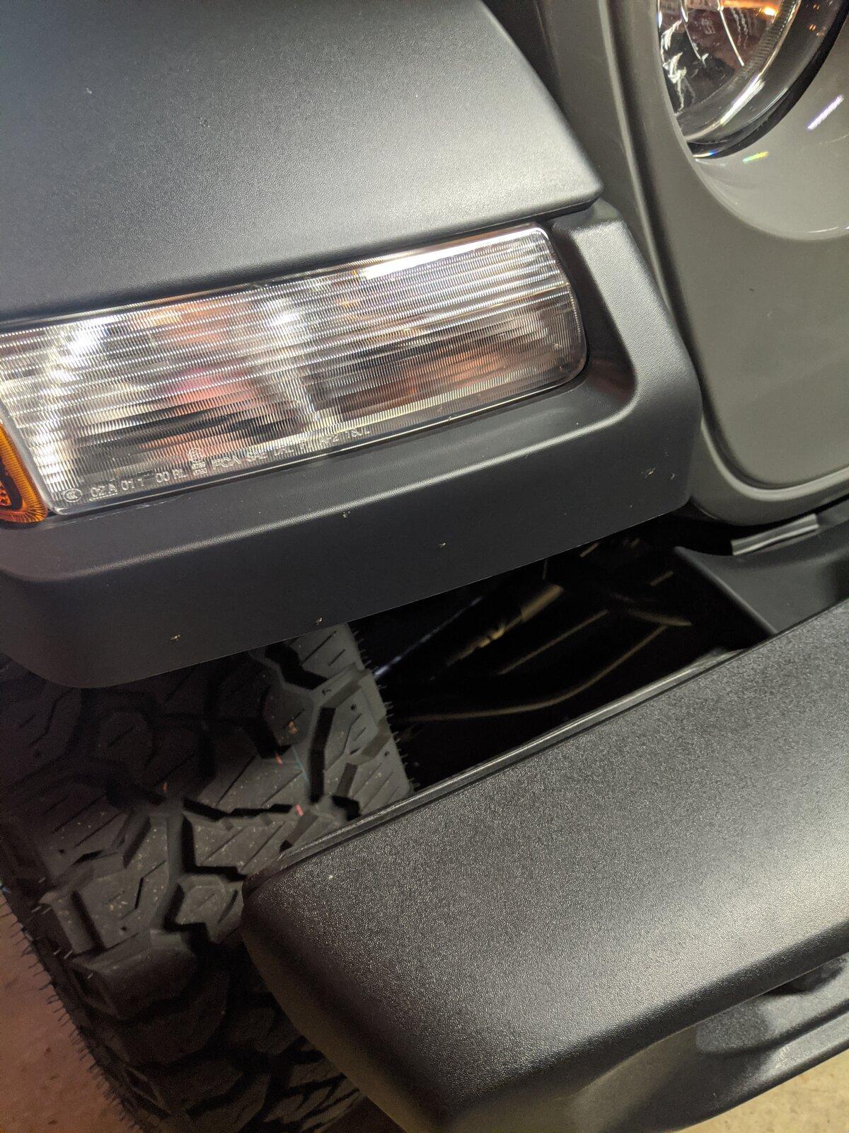

I just cut mine out with a saw, That kept everything enclosed and sealed. Then a few months later I ended up with a new bumper so I could run a winch so it really didn't matter anyway. Those things are hideous, and had to be removed almost instantly. I added 9" slim line lite bars right where they used to be and its much better.

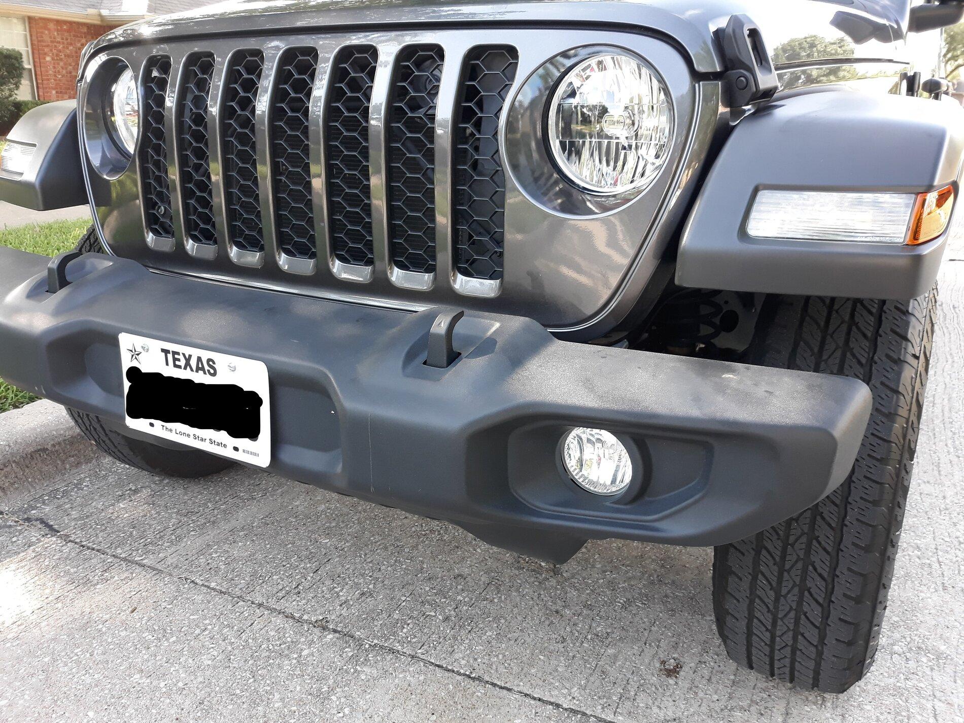

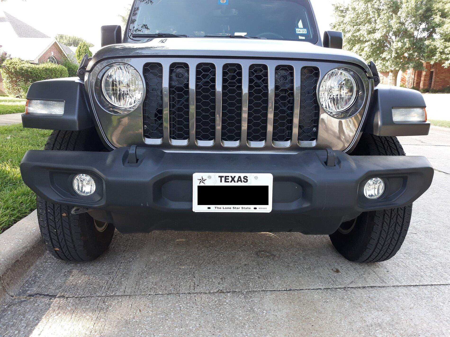

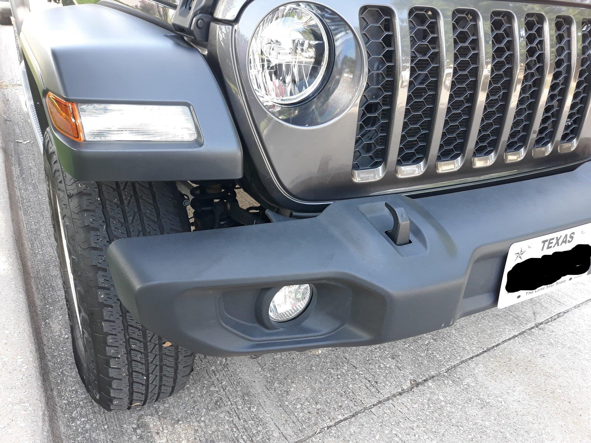

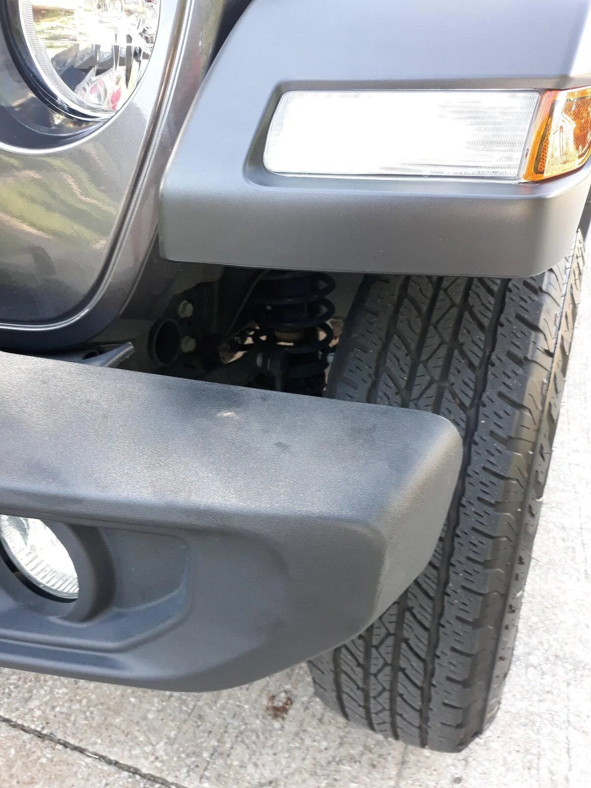

I FINALLY took the panels off. I think it looks great, and I'm going to trim them so that I can put the cover back on over the fog lights. Some pictures.
Jeep Gladiator Need information on panel between fender and bumper 20210727_175246
Jeep Gladiator Need information on panel between fender and bumper 20210727_175520
Jeep Gladiator Need information on panel between fender and bumper 20210727_175233
Jeep Gladiator Need information on panel between fender and bumper 20210727_175240
texanjeeper
texanjeeper
Apr 22, 2021
699
1,203
2020 Gladiator Sport-S Granite Crystal Metallic
I.T.
Taking these off wasn't a snap job. I counted 7 screws, and three clips that had to be removed. I also had to remove the piece in the middle that attaches between the grill and the fender, I had to pop all of those clips out and pull that section out. One screw I couldn't get my impact wrench behind it to unscrew it, there wasn't enough clearance, and the socket proved the same, so I had to go buy a 7mm wrench and take it out the old fashioned way, took a bit but both of those came out fine. Then, I found that the closure panel was intersected with the air dam on the bottom, and we had to push the closure panel up a bit and then pull hard on it to get it to clear. And, on the left side, there is a sensor of some kind mounted there and some wires were attached to the closure panel with a clip that had to be removed. It was harder to remove than the regular clips but with some effort it came out.
All that to say, it wasn't just a simple job but it went well in the end.
