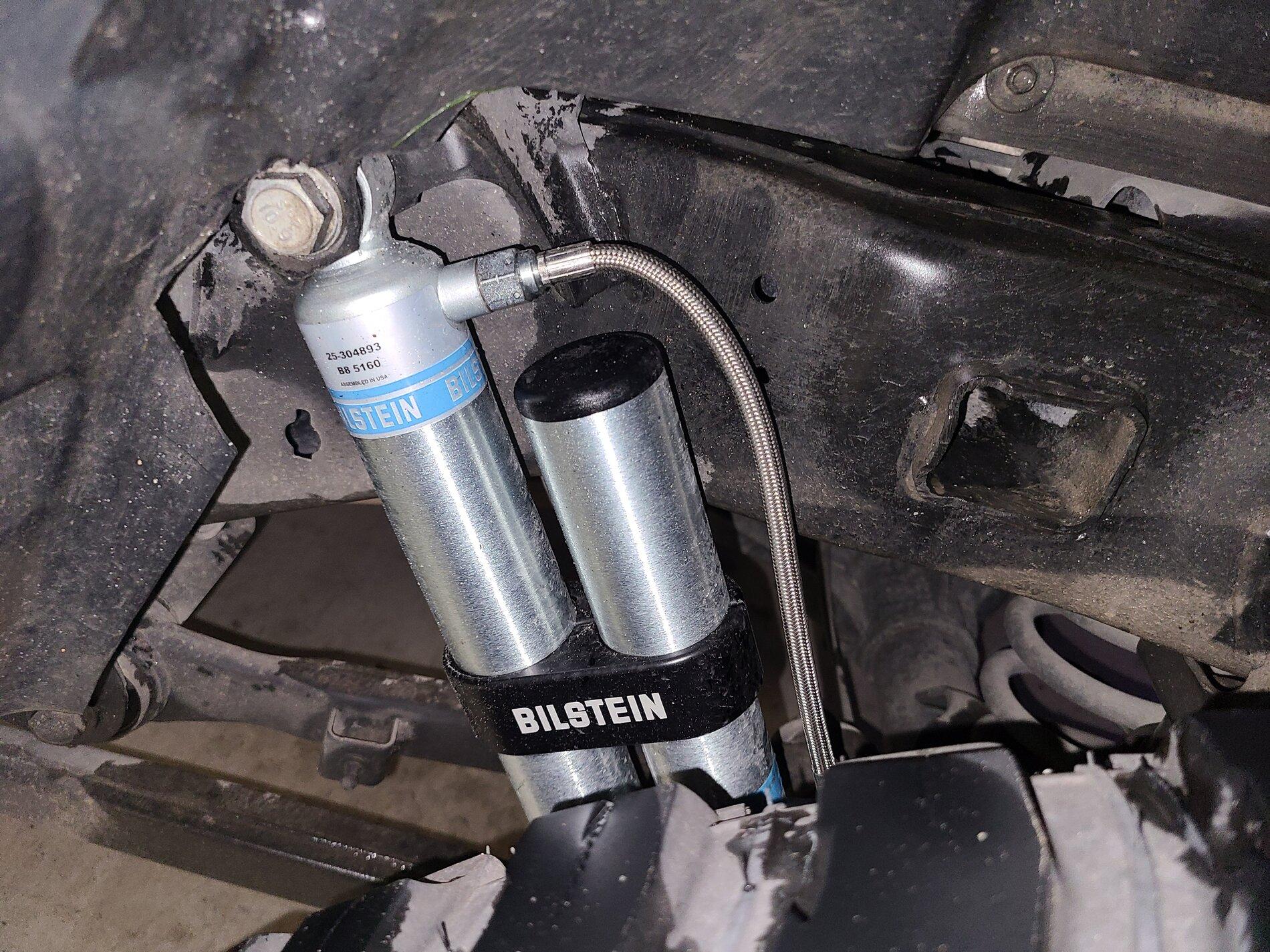

I have the Metalcloak CA's with 4.5" Evo coils. I have the front lower CA's extended out to the Evo spec (23.5" I think). The ride became pretty rough due to the angle of the front CA's so I ended up getting the Rancho geo brackets which worked perfectly! I also installed Bilstein B8 5160 shocks which are a little stiffer and ride a lot smoother.
