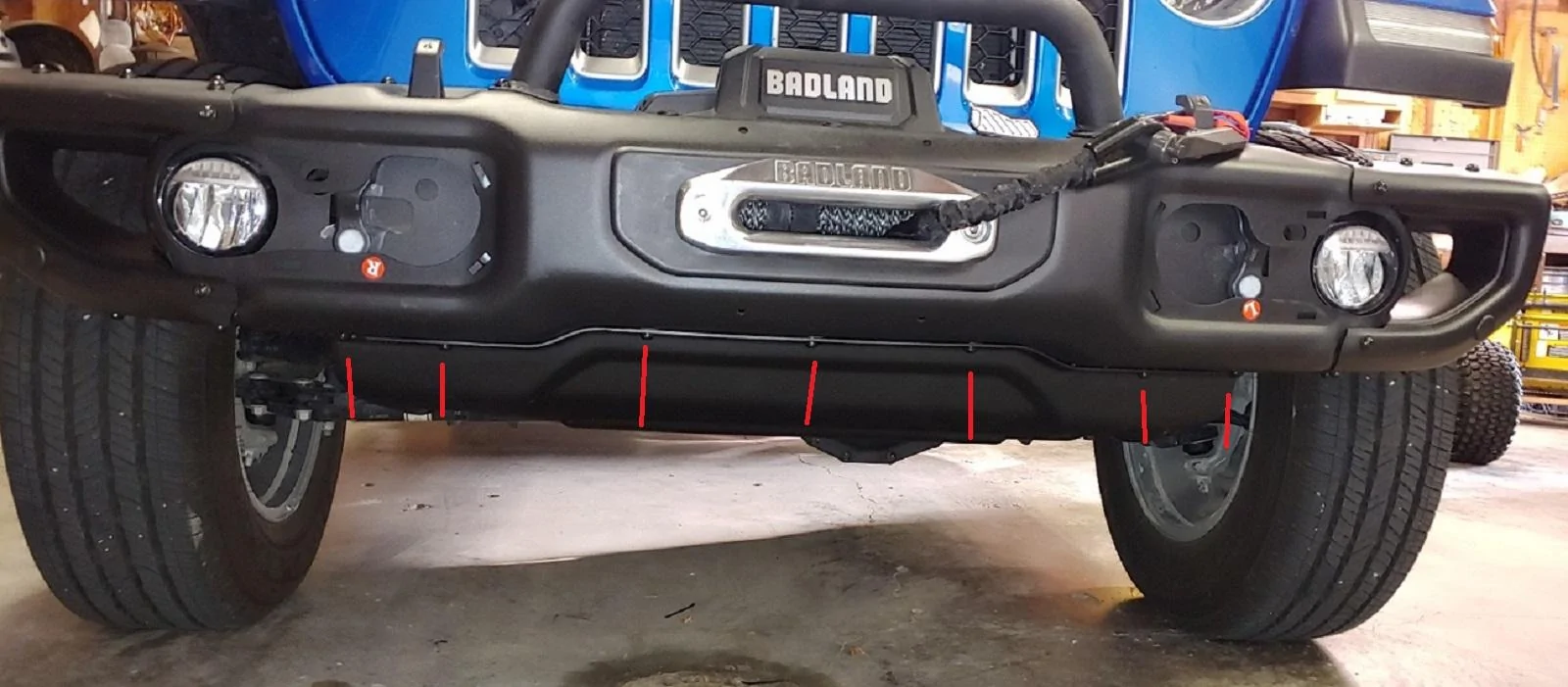

Did you go with the knockoff steel bumper? I just finished installing mine. I had to replace the bolts that attach the bumper to the frame with longer 3" bolts. Shadowspapa and I bought the same bumper but he was able to keep the 2" bolts that came with it. Mine weren't long enough for some reason.
I used the Badland Apex 12000 winch. The winch plate that came with the bumper had 2 sets of bolt holes. Installed mine in the more forward set of holes. When I went to install the bumper, it was hitting across the front of the winch. Even with the 1/4" steel plates I purchased to push the bumper out off the winch. So I moved the winch back to the rear set of holes. Then it was hitting the grille. So I took my 1/4 in plates and sandwiched them between the frame and winch plate (where they bolt to the frame). This pushed the winch forward enough to get it off the grille.
With the winch in the rear winch plate holes, the front of the bumper no longer hits the winch.
I did also move the positive power cable from the rear of the winch to the side, which others have done.
I mounted the winch on 2-1/2" washers to raise it up a bit so the clutch handle wouldn't hit. It still does. 4 washers may clear it. If I lift up on the handle a little can get it over the bumper. Like others, I'm going grind off the bottom of the lever so it doesn't hit.
I had to remove the removable end pieces (of the bumper) to be able to bolt on the plastic covers that go in the fog light area. Couldn't get my hand in the hold the nut when trying to bolt the piece in from the outside.
Took me maybe 7 hrs total to get everything done by myself. There was a lot of head scratching and trial and error. Probably knowing what I know now, I could get another one done in 3 hrs.
I looked at my skid plate again, been sitting in my back office. It's steel. Only has 2 bolt holes on each end, which bolt into the angled brackets which are bolted into my frame. Didn't attach to my plastic bumper like I originally thought, my mistake.
If you are going to go with the knockoff steel bumper I'd recommend the following.
Have a screwgun with a couple of hex shank socket adaptors. There are a lot of screws on the plastic bumper to remove to pull out the connector wiring for the fog lights. You basically have to take the whole plastic bumper apart.
Also lots of allen screw head bolts on the steel bumper. You'll need 4mm, 5mm, 6mm. so much easier unscrewing everything with the screwgun.
I'd order the 3" long M12x1.75 bolts. I got on Amazon so if you don't use you could always return.
I'd also order the 1/4" thick steel spacer plates.

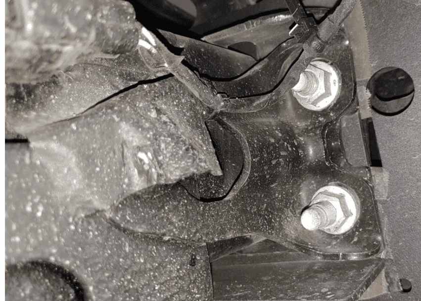

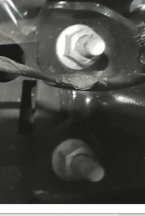

I used the stock factory original Jeep hooks and bolts. The bolts are very long and in fact could be shorter. I don't know why they aren't working out for others.
Seriously, look how long these are - original hooks, original bolts and nuts and the threads stick through so much I could have used spacers and still been more than ok..
