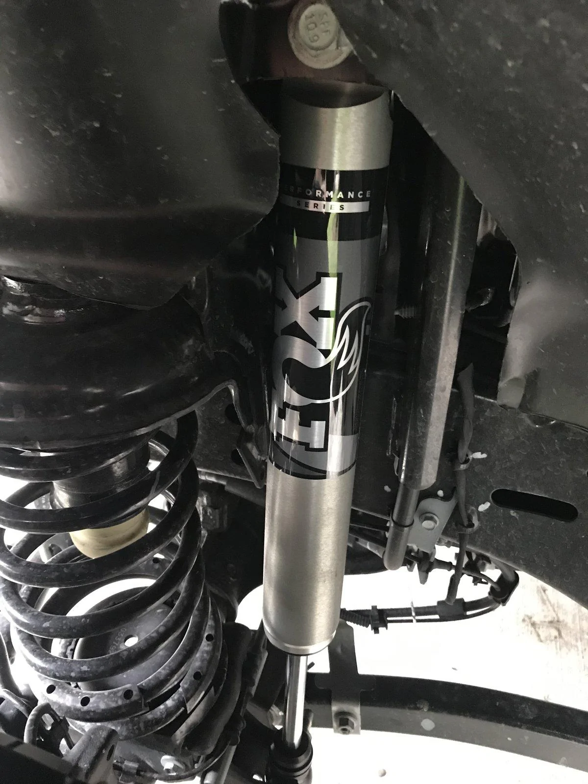

I have the Alloy USA 1 1/2” level kit & it didn’t make any difference in ride at all , 2” would be the stopping point if you want to keep the ride Daystar also includes lower control arms which addresses the axle castor and corrects it. Then the rear is only 1” spacers which shouldn’t make a ride difference. So today i installed a 0-2” fox shocks for the front & removed the shock extension & rear factory fox shocks. Changing to these shocks made a huge difference i have the Overland & on the freeway the rear would bounce a little on dips. Those shocks stopped it .

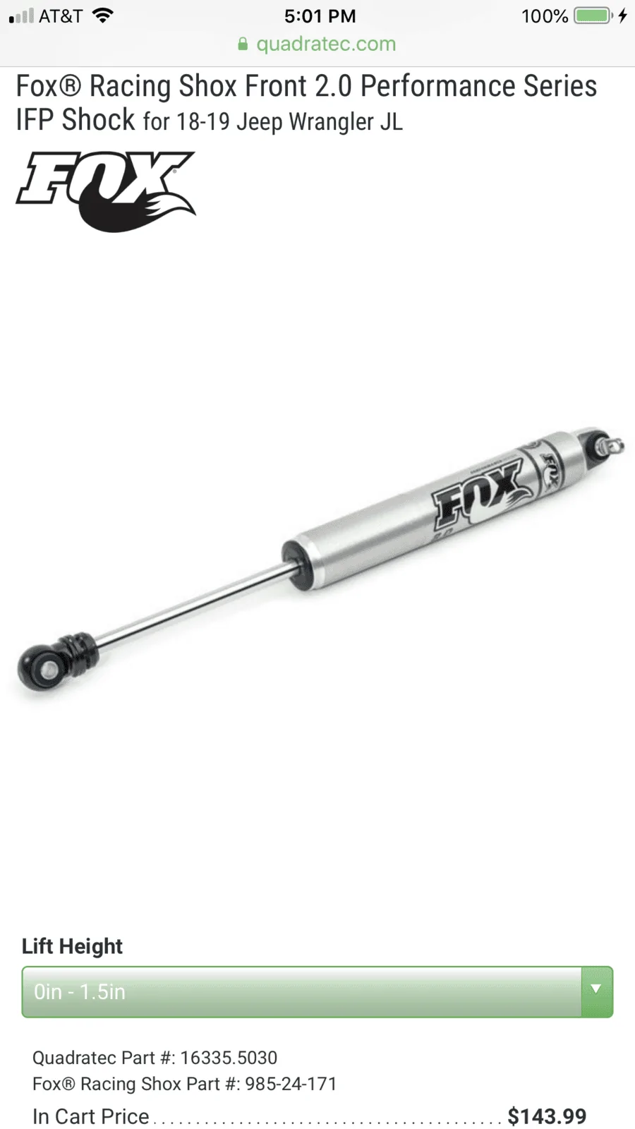

Do you mind sharing the model number of the fox shocks you installed? Do you have pics?

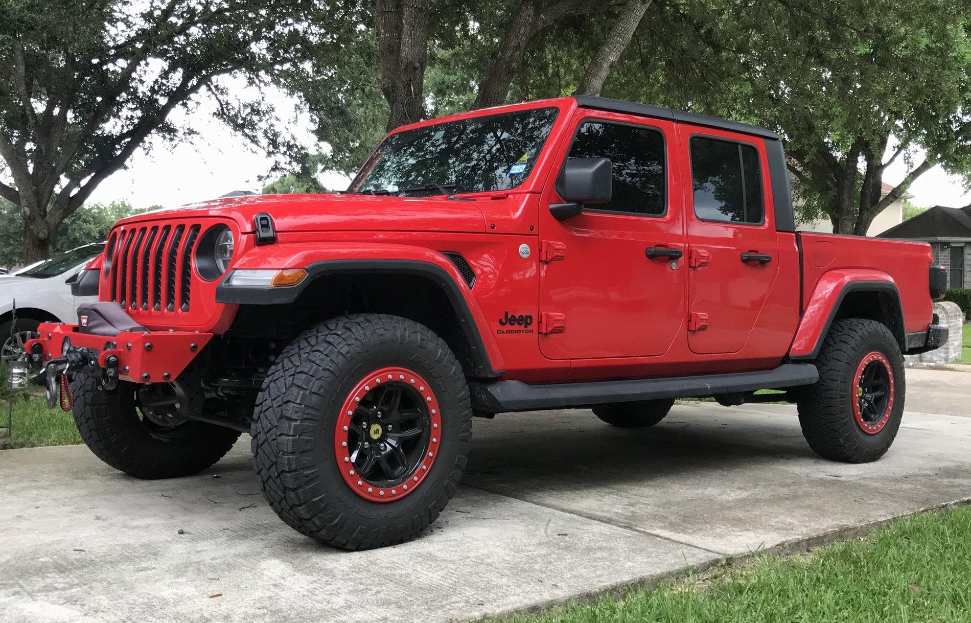

Jeep Gladiator New Daystar 2” Spacer lift {filename}
Ok i ordered 0-1 1/2” that works great it’s for JL but works out good, my rear is stock JT Rubicon take offs.

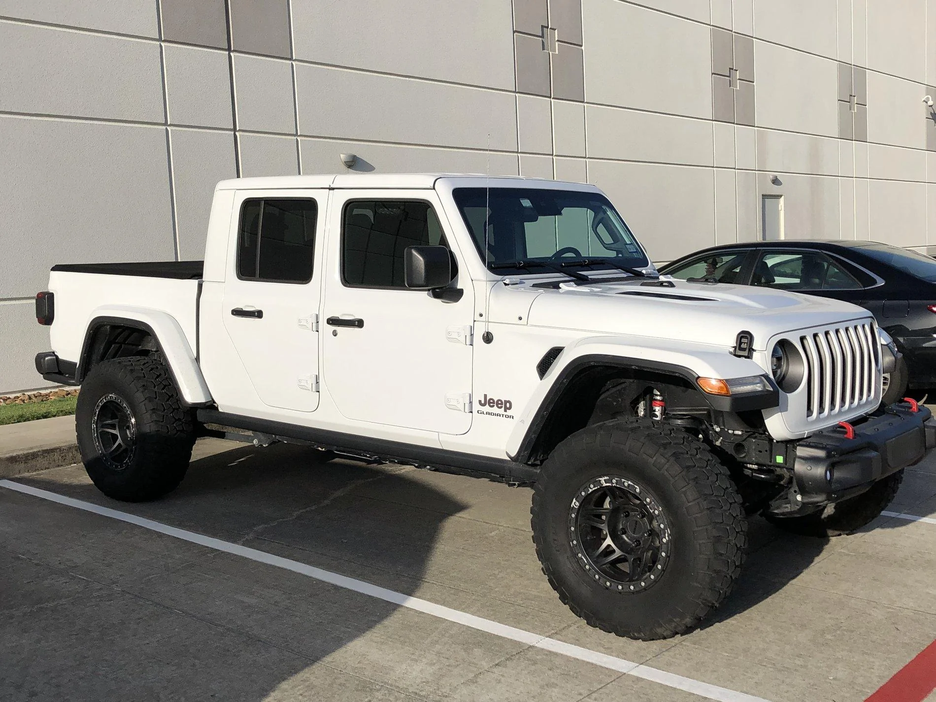

I have seen varying information on the height of the rear spaces for the Daystar 2" kit. Is it 1" in the rear, and what have people seen as far as how close to level it sets with the rear installed?

I installed the 1.5 daystar in the front only.....and it looks to sit perfectly level and I measured from the bottom of the fender.....and it was dead even front and rear....I think the rear is to keep the factory rake as some mentioned. I may have measured wrong but it looks good to me....I may add the rear later when I plan to tow more
