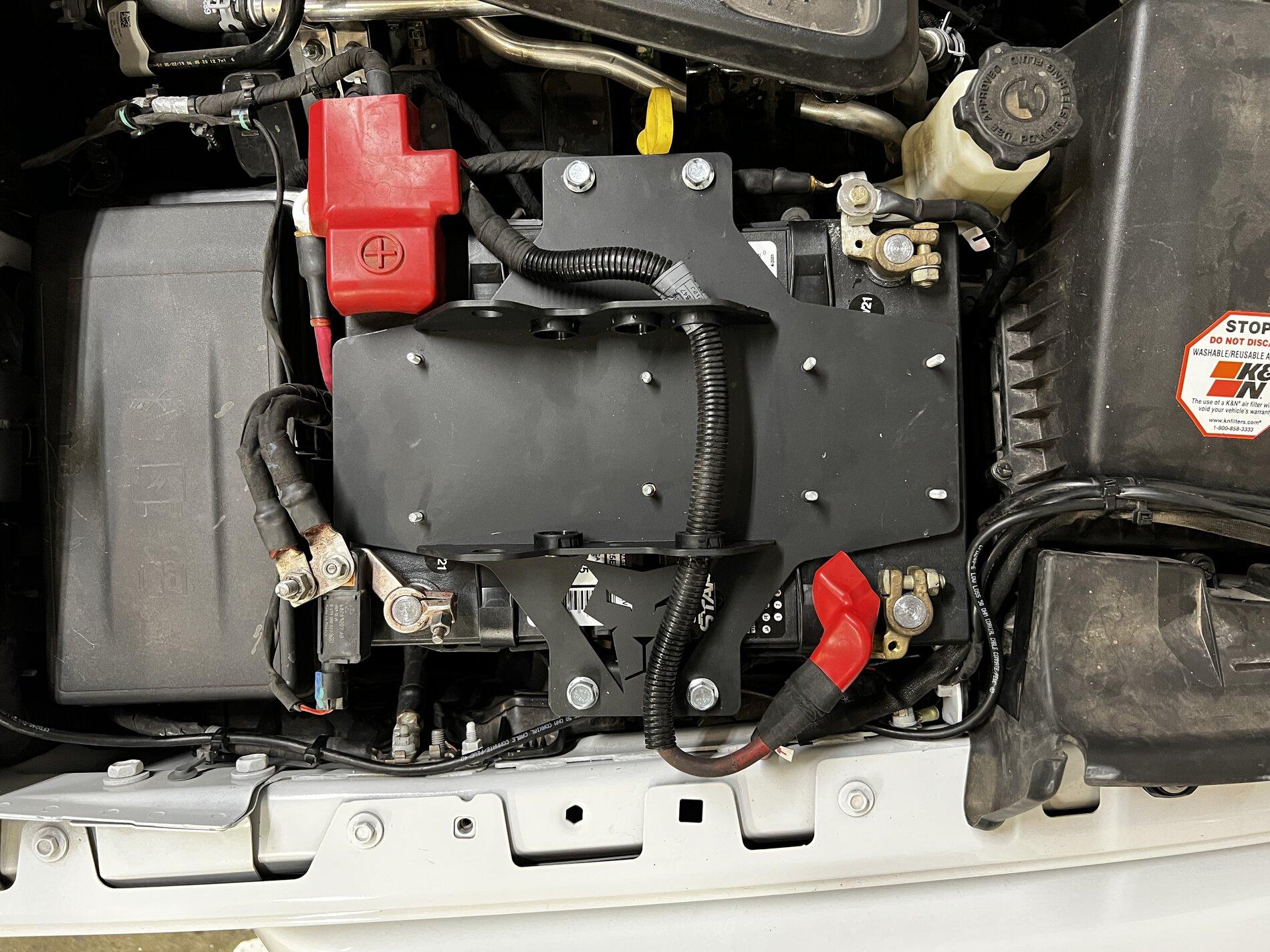

Well it’s all in. Went with my own electronic dual battery isolator dc-dc charger. Everything fit well. Everything is working.
I need to get some better battery terminal covers for the second battery.

Forgot to take a picture of the battery isolator installed after this photo.
battery cables are thanks to a couple of Land Rover discovery 2s I parted out years ago. They are very thick and will work great.

I used two AGM group 25 batteries from Oreillys. They have a 5 year warranty. And Oreillys is pretty much everywhere and can warrantied anywhere

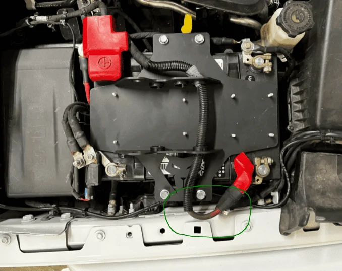

Also, please be mindful of the positive battery cable loop at the fender. In the event of an impact this is really close to grounding out on the body. Hopefully your fuse would prevent anything bad from happening but just a friendly callout
Jeep Gladiator New here....Genesis OffRoad Dual Battery Install??? 1637337619085
I redid that last night when I put the isolator in. I’ll take a new picture later to show the new routing.
